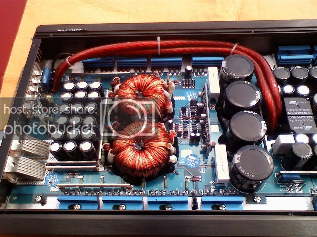

That aside, the new Maxxsonics stuff is showing alot of potential, and the 4125 is a darn good value.
I like the fact that the 2000.1 has anodized blue heat sinks on the FETS... if that doesn't give ya a boner, I don't know what will. //content.invisioncic.com/y282845/emoticons/veryhappy.gif.fec4fed33b4a1279cf10bdd45a039dae.gif
note: there are 14VDC components in there, so I wouldn't plan to **** this amp with voltage.
