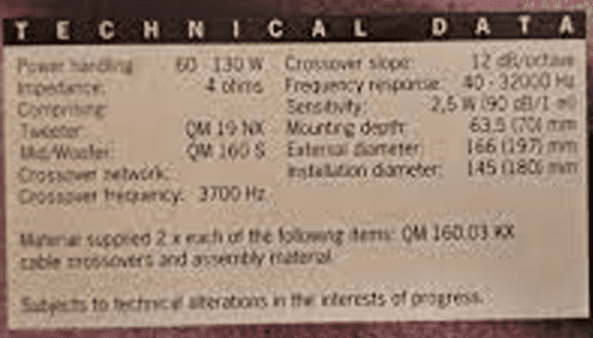

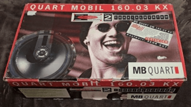

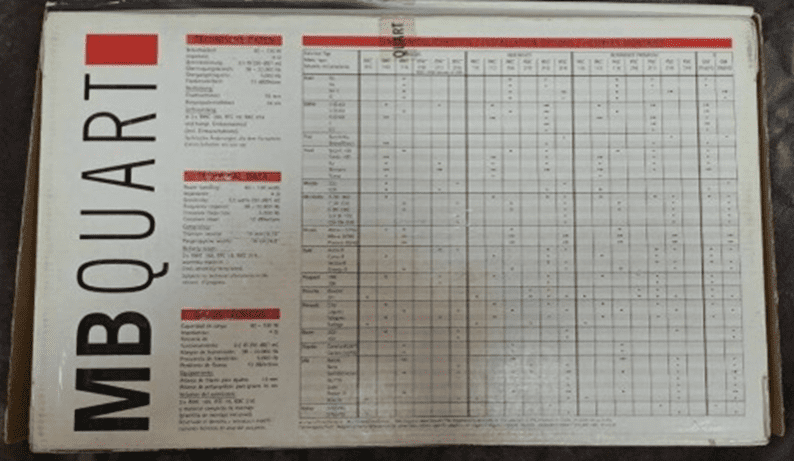

Thank you both for your replies. I finally found the original specs. Someone was selling a pair of these several years ago overseas and they included pics of the box art in their ad. I hope this will help someone else looking for the specs on this speaker:
QUART MOBIL 160 .03 KX
Technical Data:
  • 6.5 inch High-End Mid/Woofer
  • 0.75 inch Titantium dome Tweeter
  • Power Handling: 60-130 W
  • Impedance: 4 ohm
  • Frequency Response: 40-32000 Hz
  • Sensitivity: 2.5 W / 90 dB
Includes:
  • Tweeter: QM 19 NX
  • Mid/Woofer: QM 160S
Crossover Network:
  • Crossover Frequency: 3700 Hz
  • Crossover Slope: 12 db/octave
