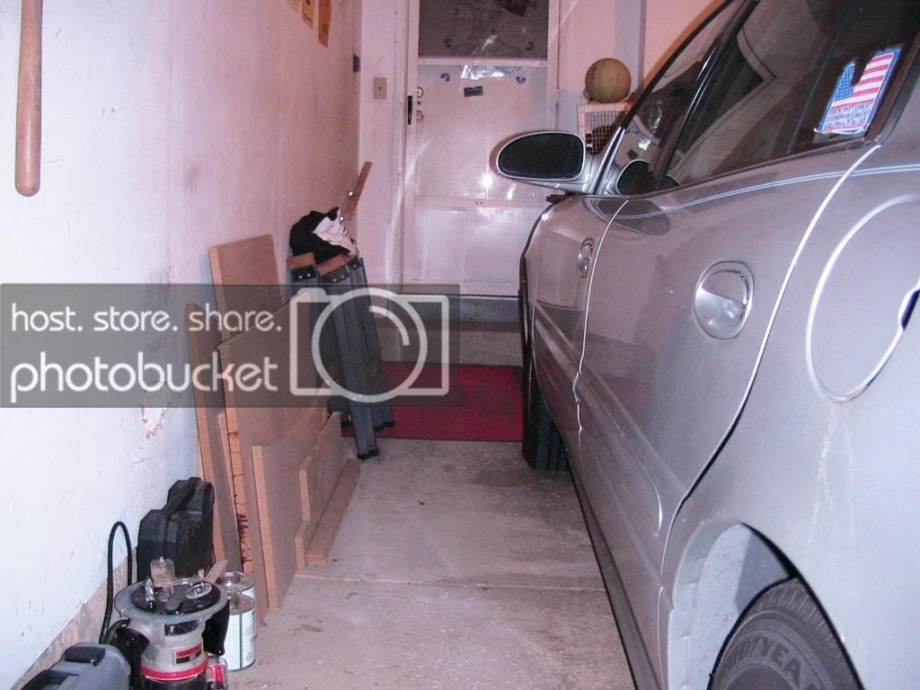

i also cleaned the garage so that i could squeeze my car in there and keep it away from all those filthy meddling communist children roaming the streets tonite

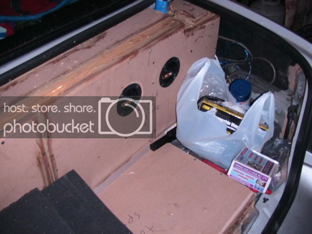

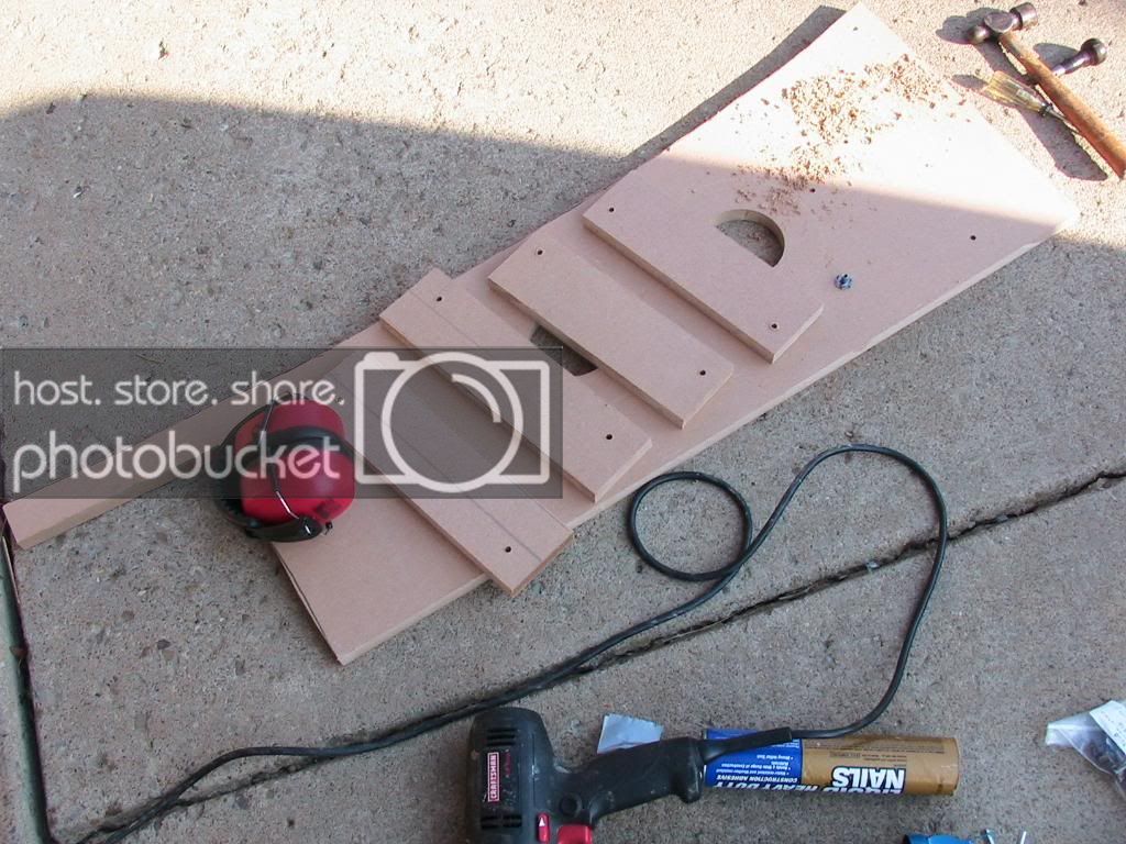

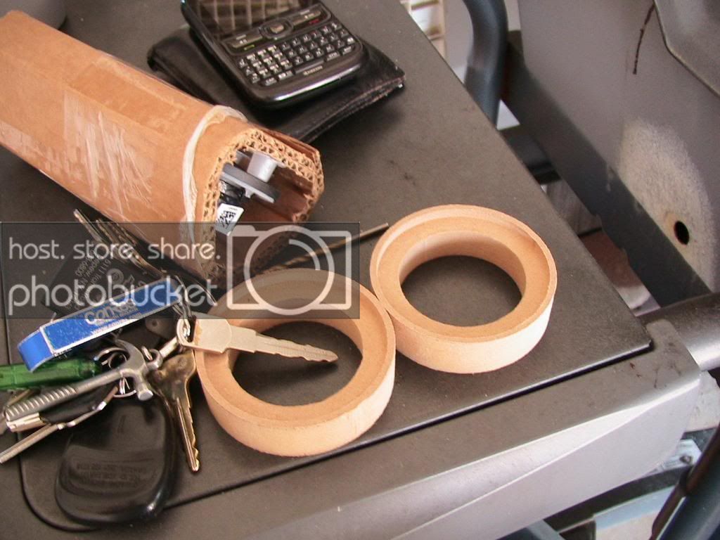

built some tweeter rings for the front (will be installed later)

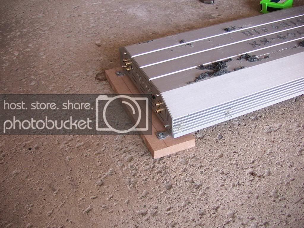

working on mounts for amps:
screws into t-nuts on the other side
and....amp is mounted

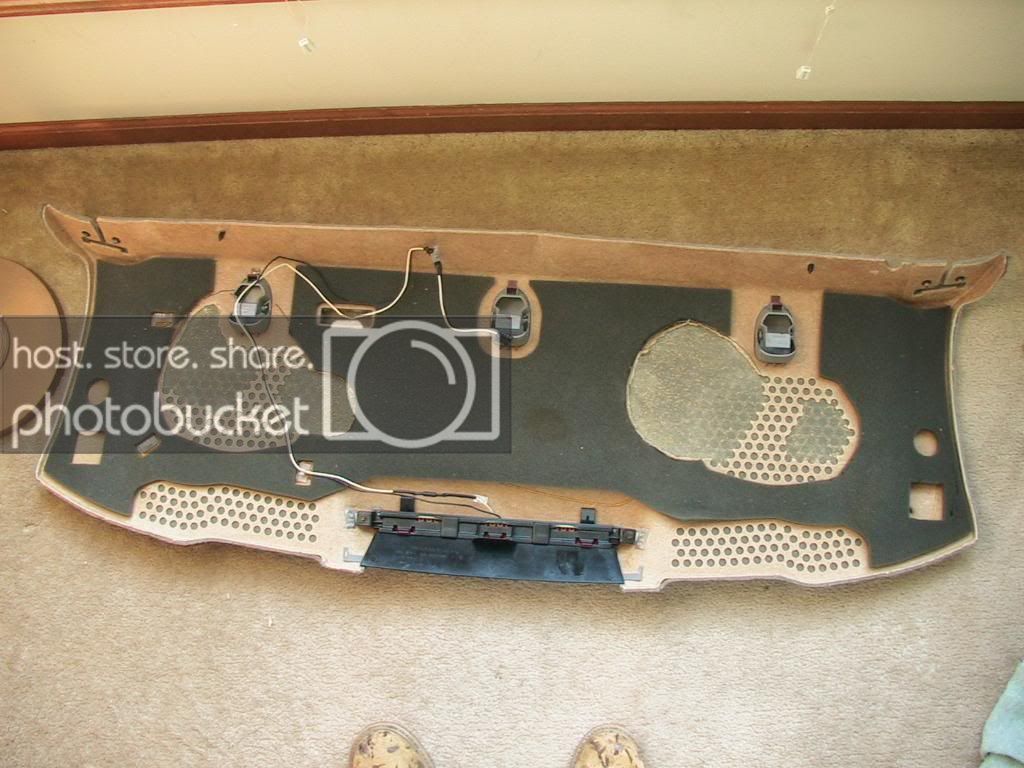

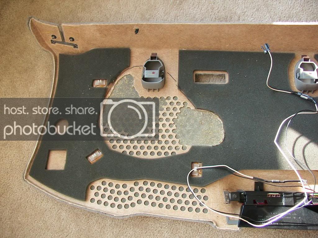

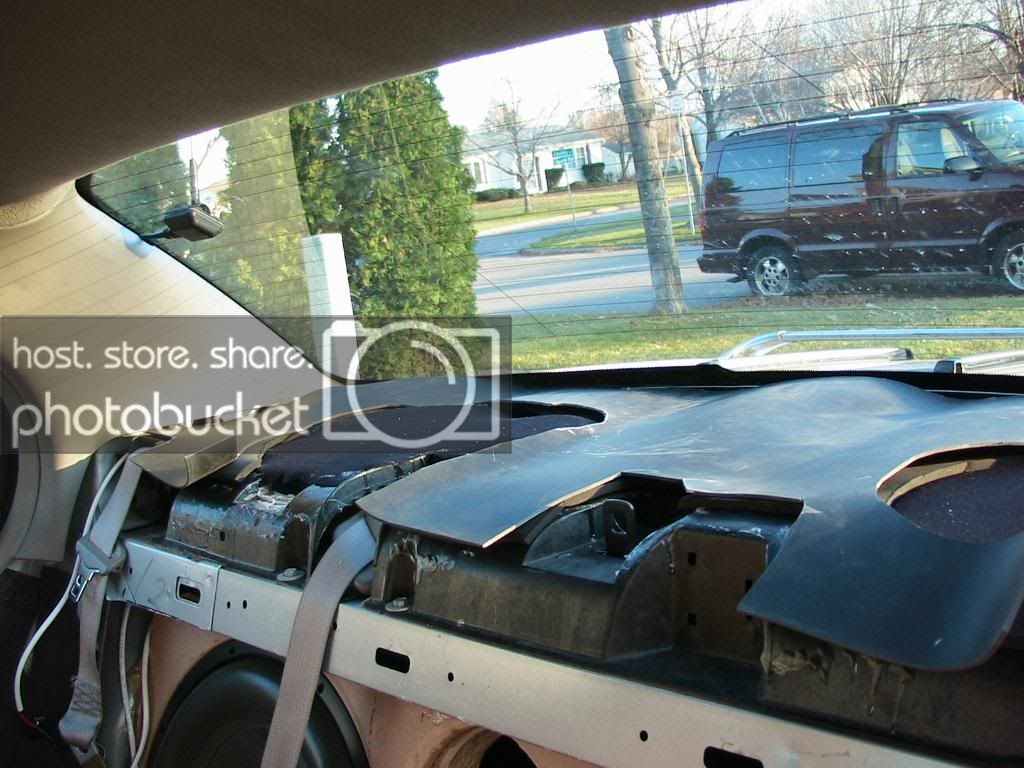

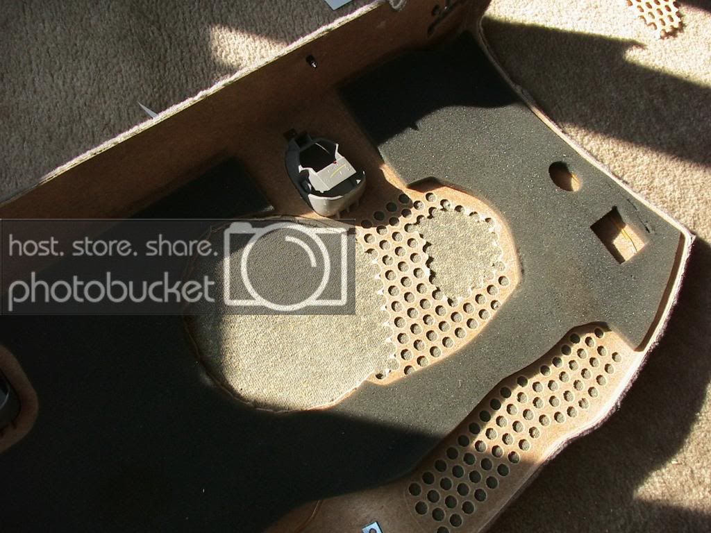

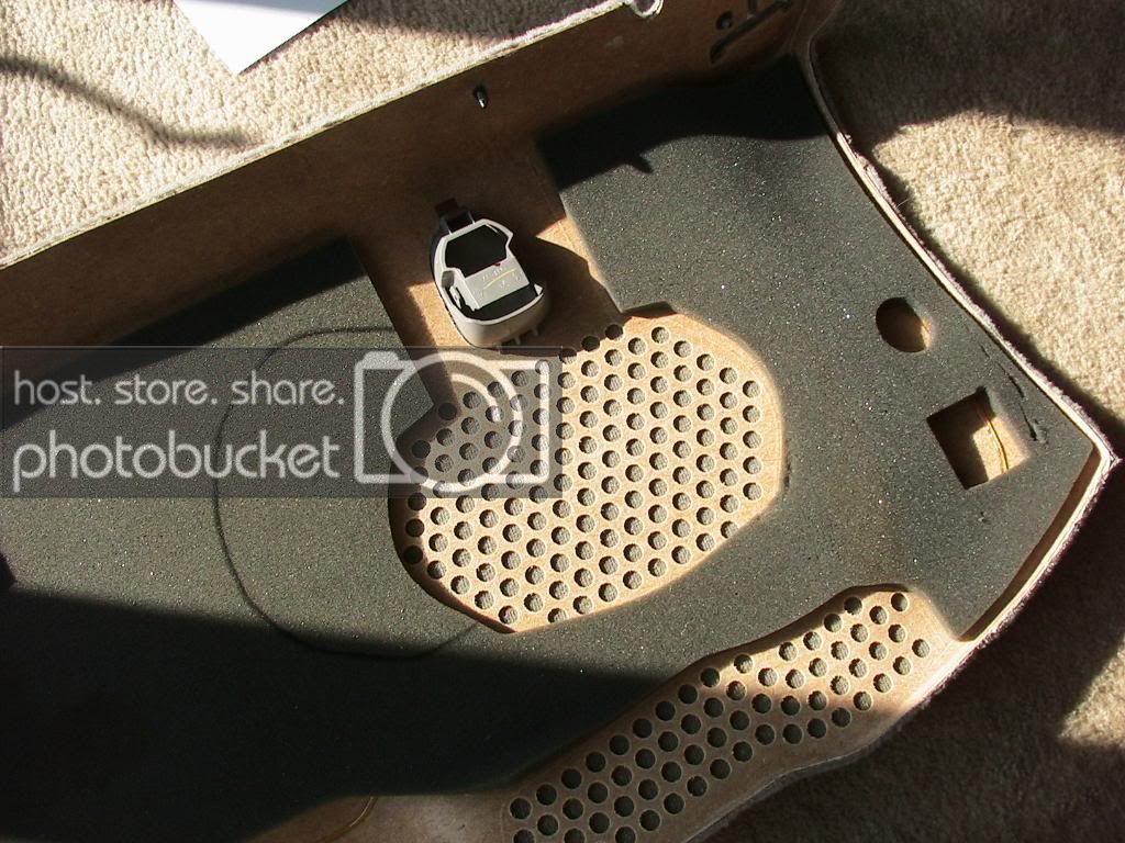

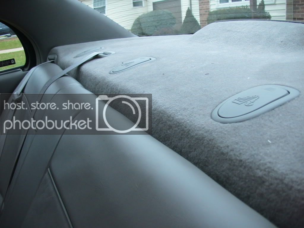

Working on putting the cover back over the back deck - oddly enough, 1/8" composite doesn't exactly meet my standards for "acoustically transparent", so some of it had to go:
ready to go in:

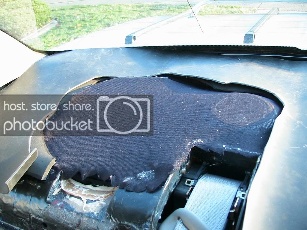

putting CCF and MLV over the back deck:
also, I put some grill cloth over the speakers to hopefully help shield them from UV rays.

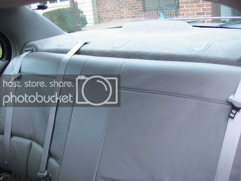

I did get the cover back on but no pics, sorry.

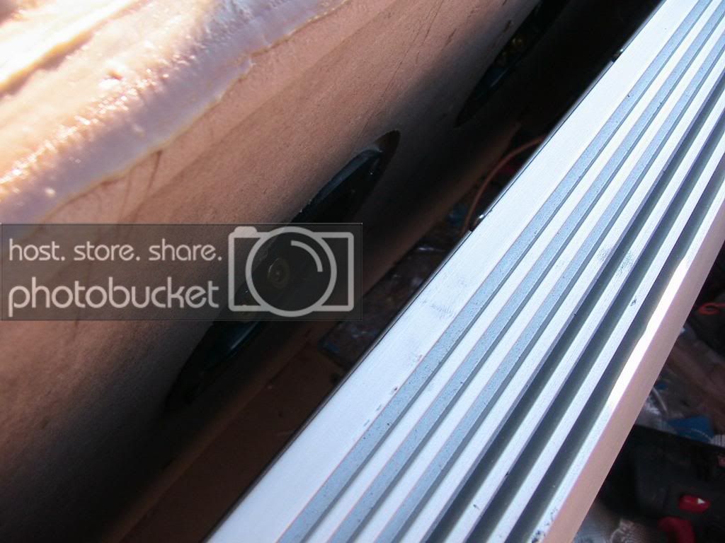

Wow! Great build so far! That's a hell of an undertaking. One question, what the hell is all over your Goliath???? //content.invisioncic.com/y282845/emoticons/laugh.gif.48439b2acf2cfca21620f01e7f77d1e4.gif
ha, the guy who i bought it from packaged it with some sort of stick foam....and i didn't have time to clean it all off before i mounted it //content.invisioncic.com/y282845/emoticons/redface.gif.62fdbfe1a101588a808c4cff71bcb942.gif

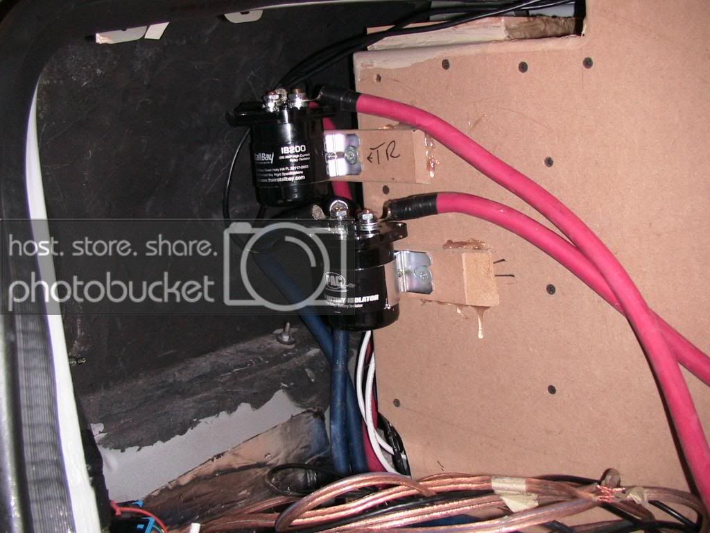

setting up my isolator relays:

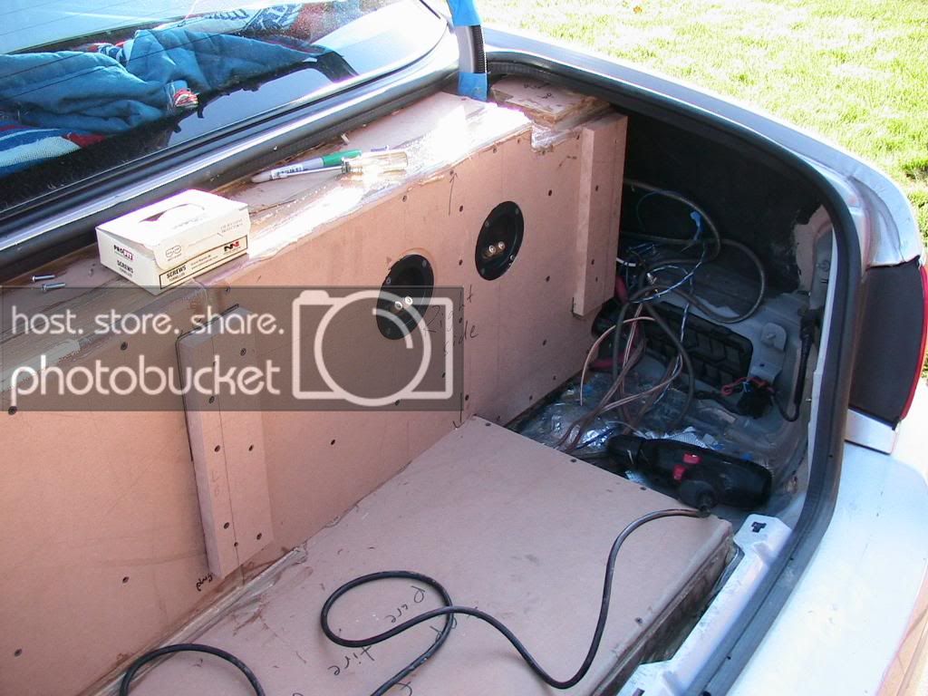

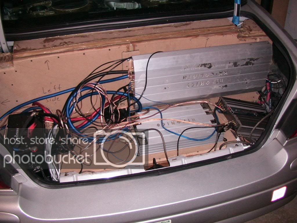

mocking up everything to make sure it fits:
it's a pretty tight fit over on the left side but it's all good.

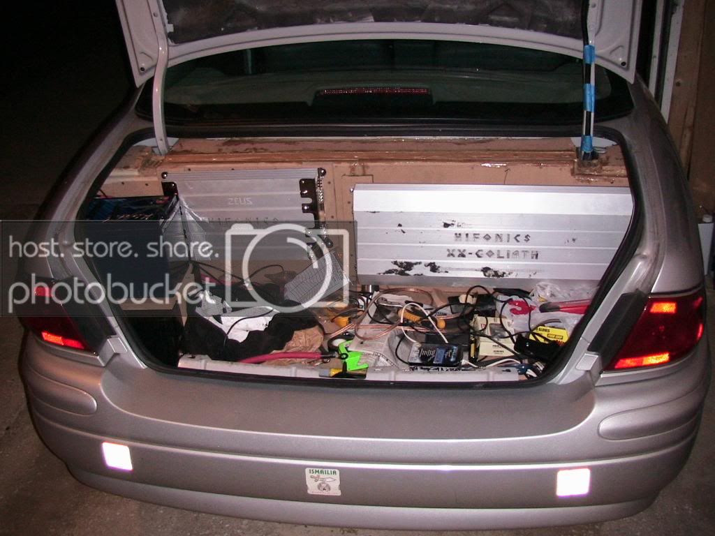

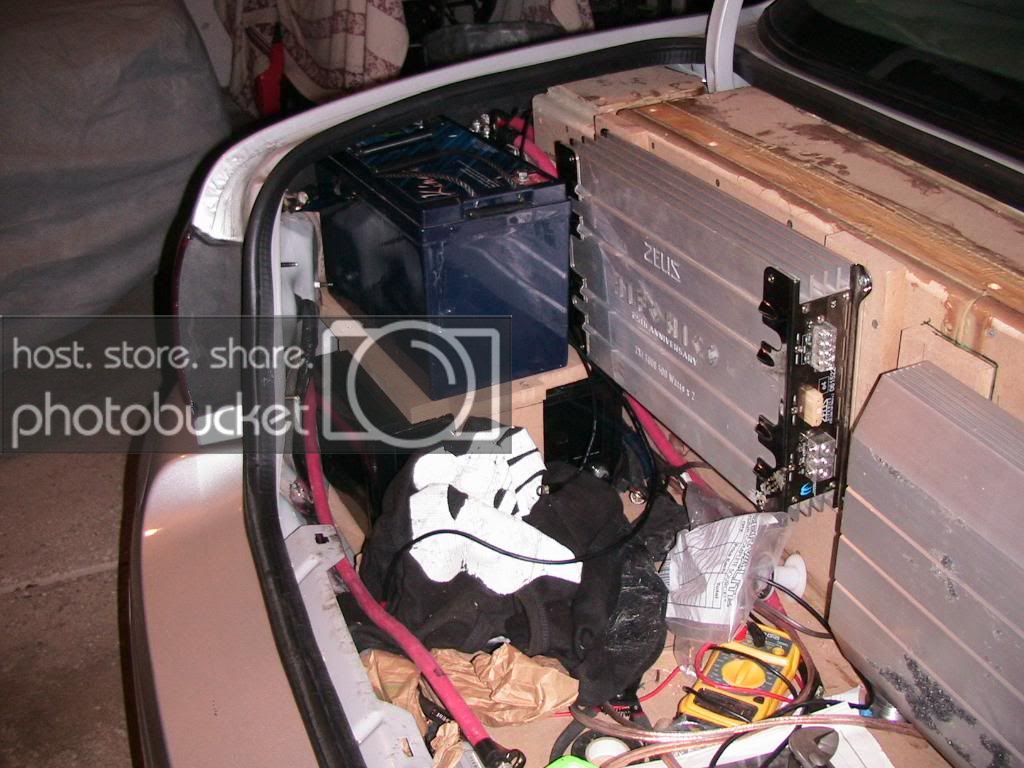

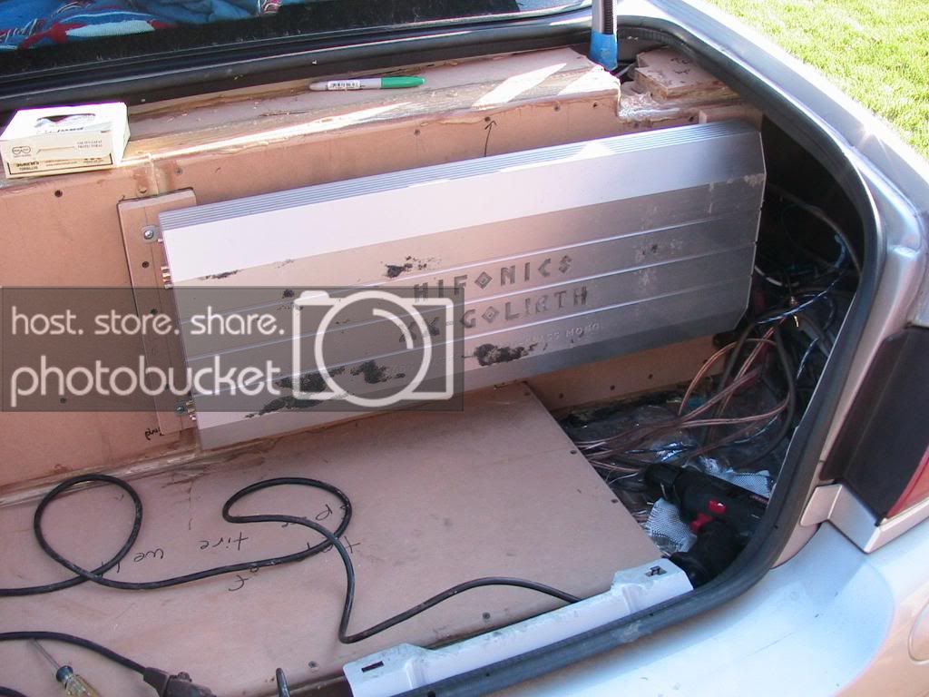

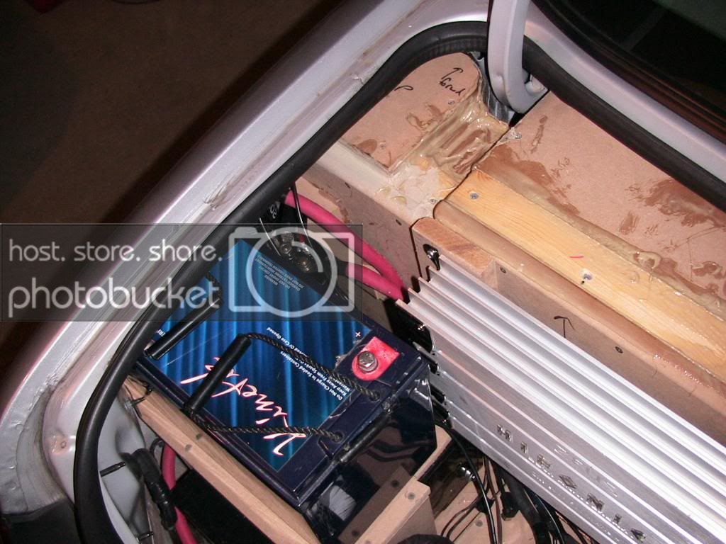

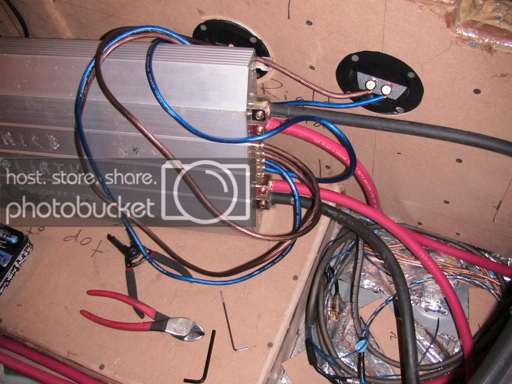

hooking up sub amp before it's mounted (all wiring going to it is 2/0 OFC welding wire):
thus far, altho not shown in pics, the back deck speakers and subs are hooked up. I still have issues with the CD player skipping at high volumes, but I was able to borrow an ipod and kick this thing and it's pure brutality lol. I do have some very minor dimming when the car is idling and i'm playing it really loud but i guess that's to be expected.
I still have some minor electrical work to do - for example i currently only have one of the two 1/o runs going from the alt to the main battery hooked up, and i have one more run of 1/0 from the main batts to the secondary batts that needs to get hooked up. Also, some better wire management in the back is needed, etc. I probably won't bother with wire management until Christmas break tho because at this point in the semester i'm pretty slammed.
