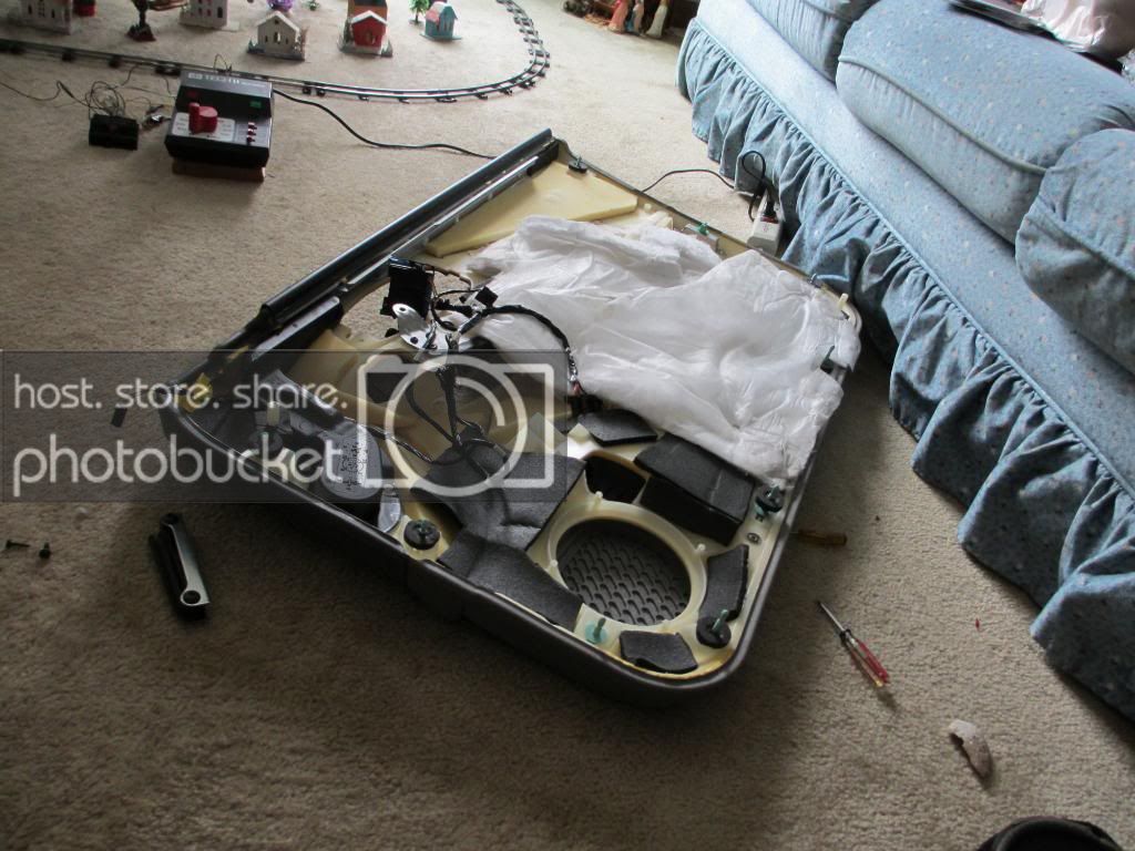

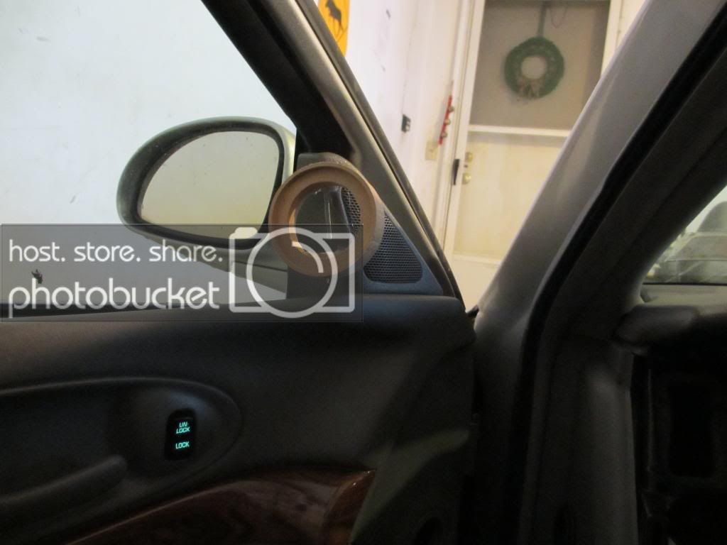

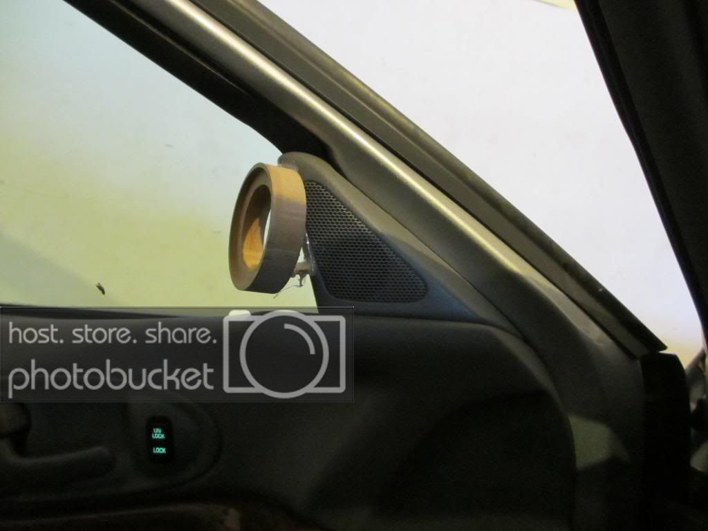

setting up the tweeter pods prior to the removal of the door panels.

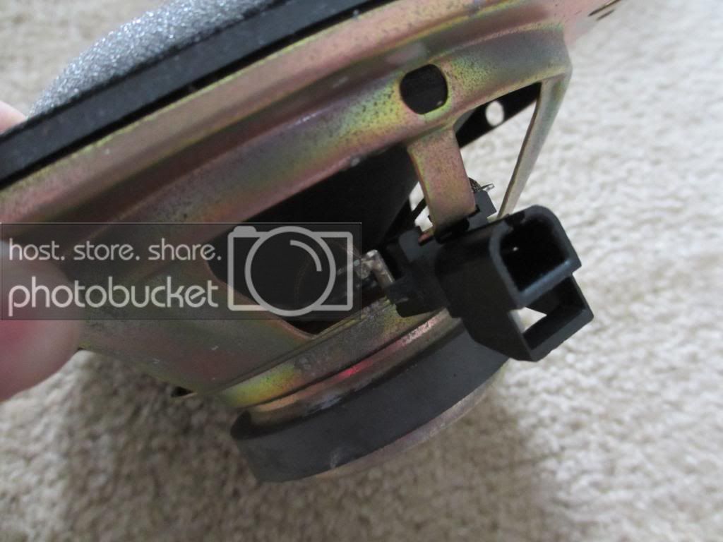

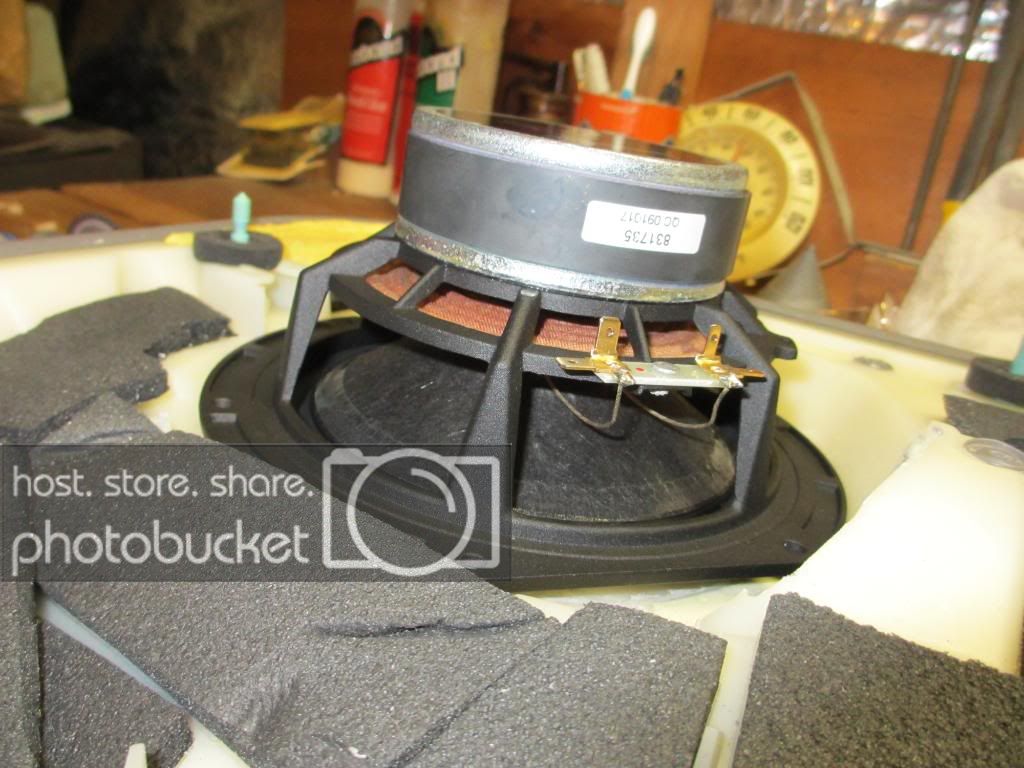

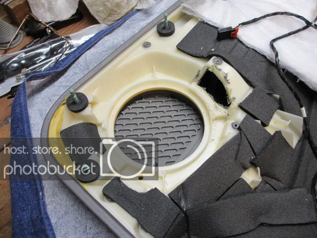

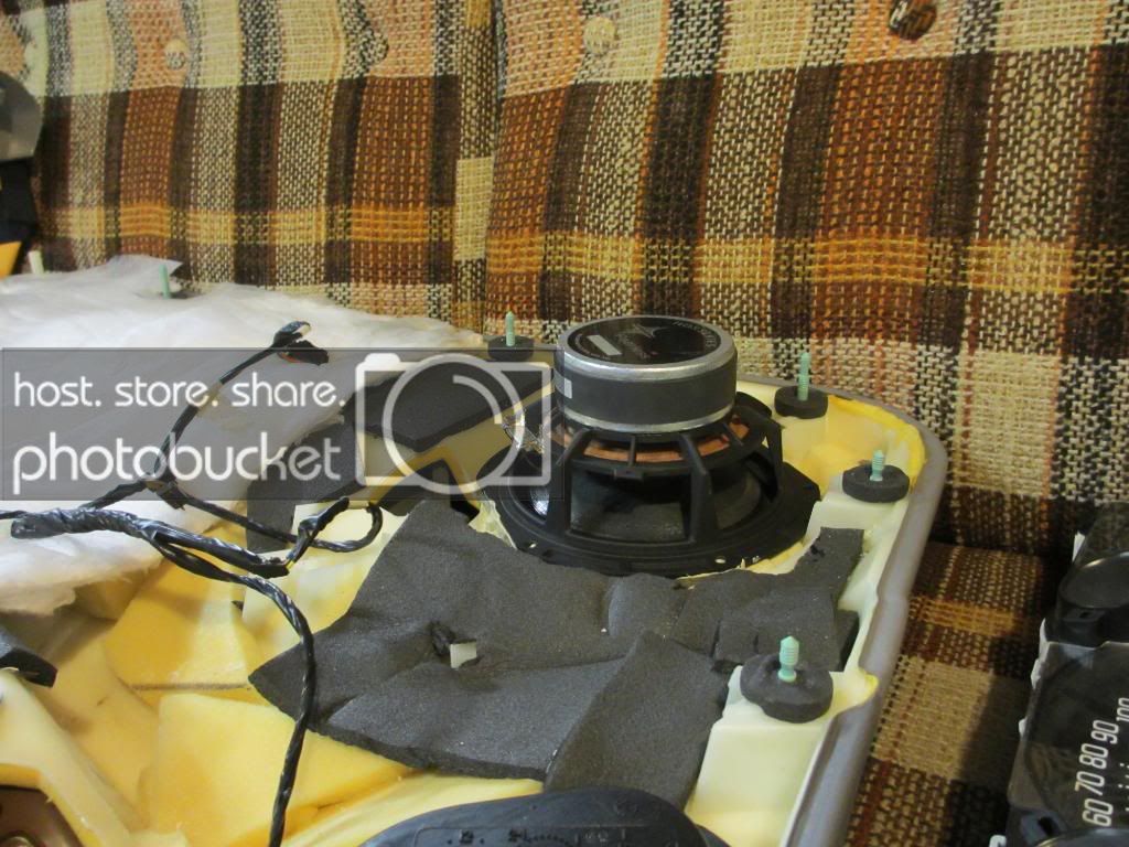

man, i can't believe the crap they pass off as "speakers" at GM. The cones on these things were really flimsy, its no wonder they sounded like crap.

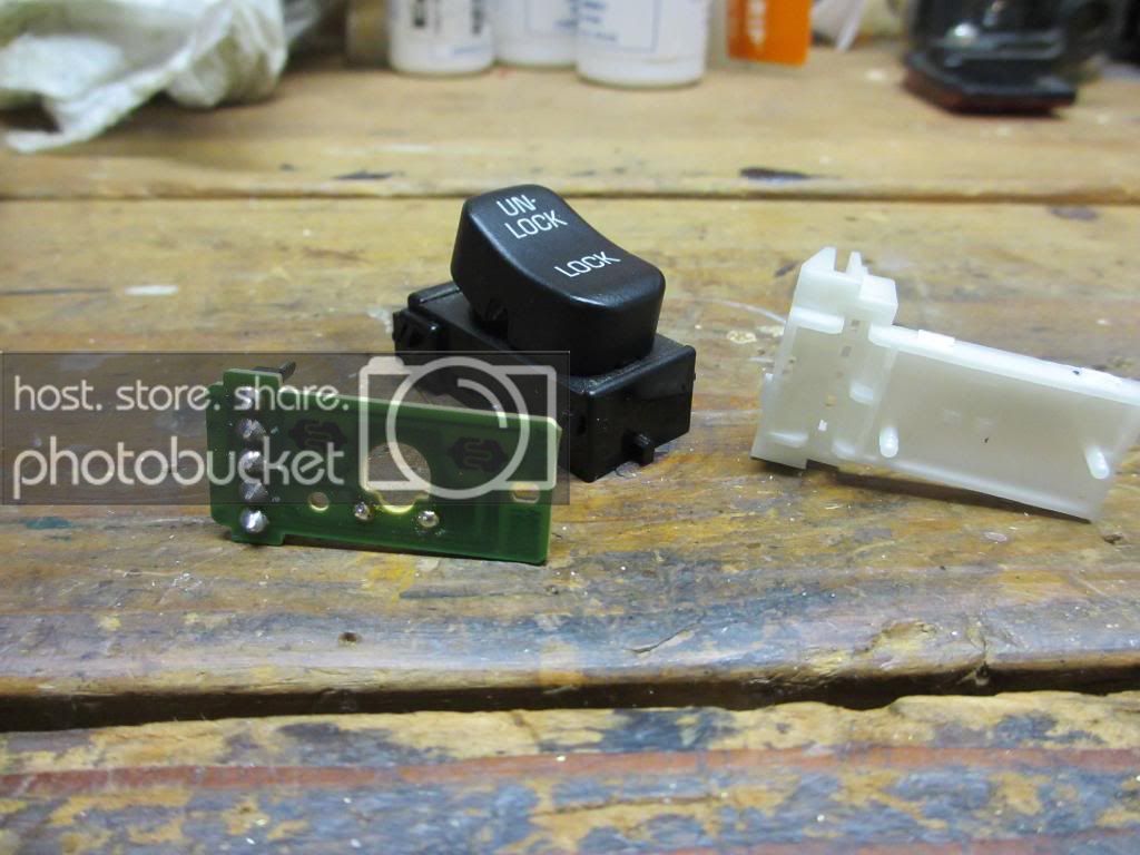

working on one of the door locks

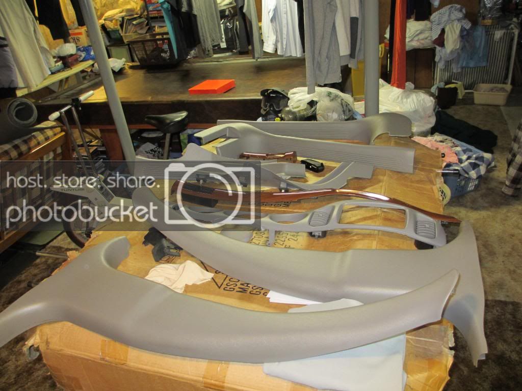

interior panels and such, i've had these in the house for awhile so I cleaned and conditioned them before I put them back in the car. Makes a huge difference in how they look.

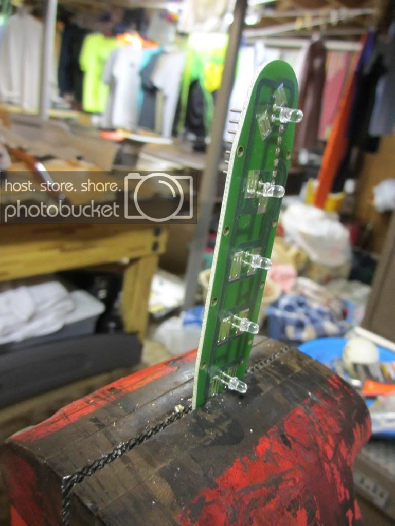

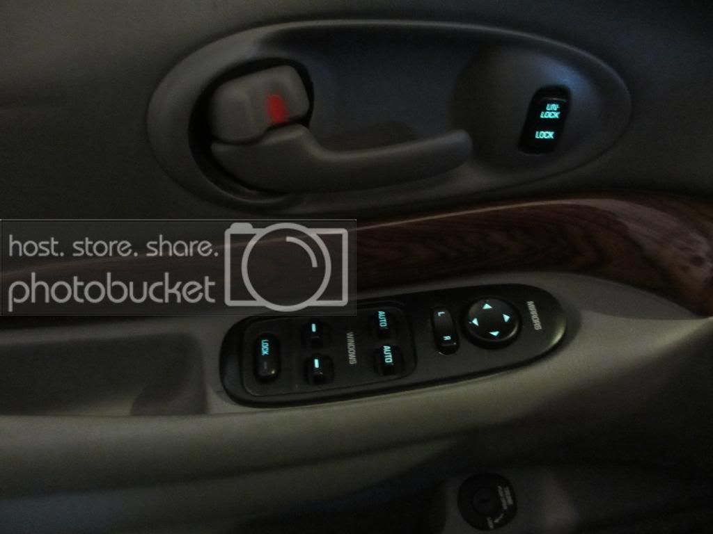

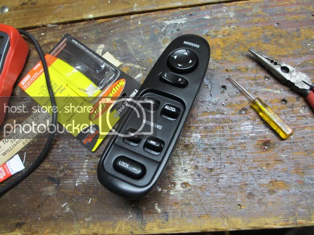

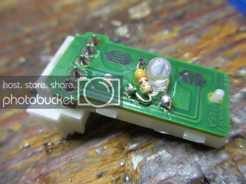

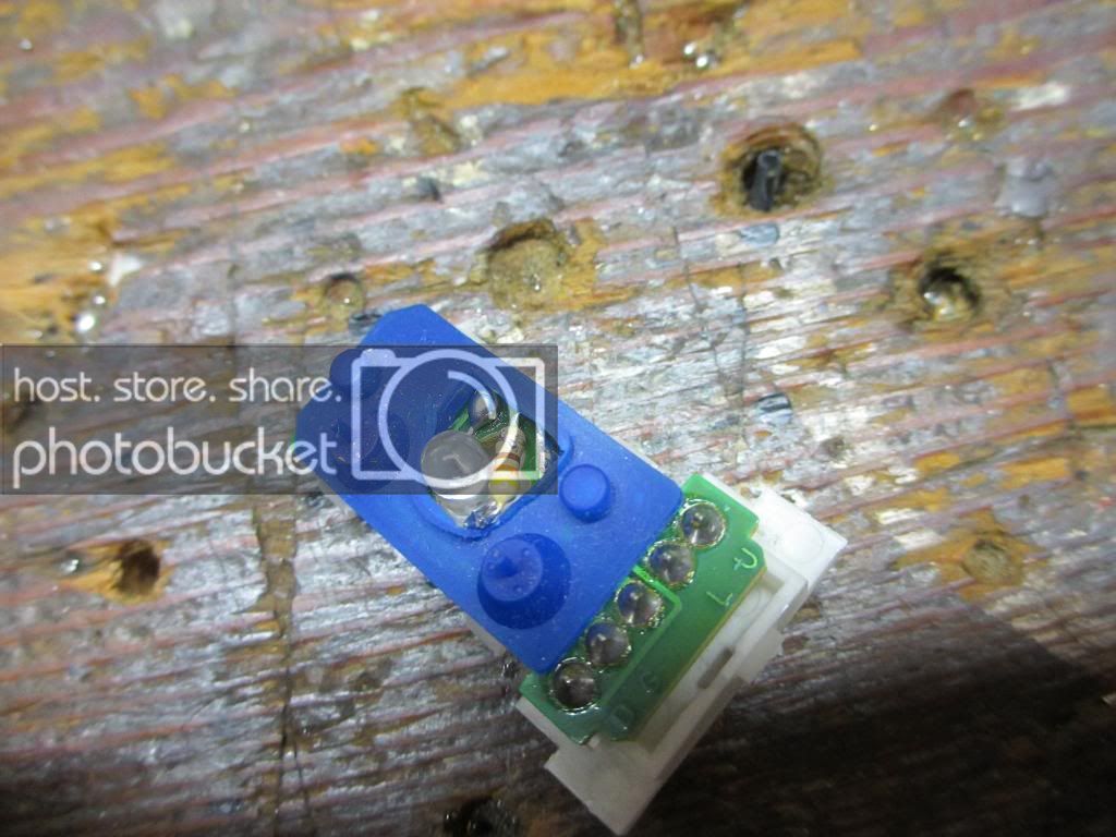

working on the lighting for the window controls.

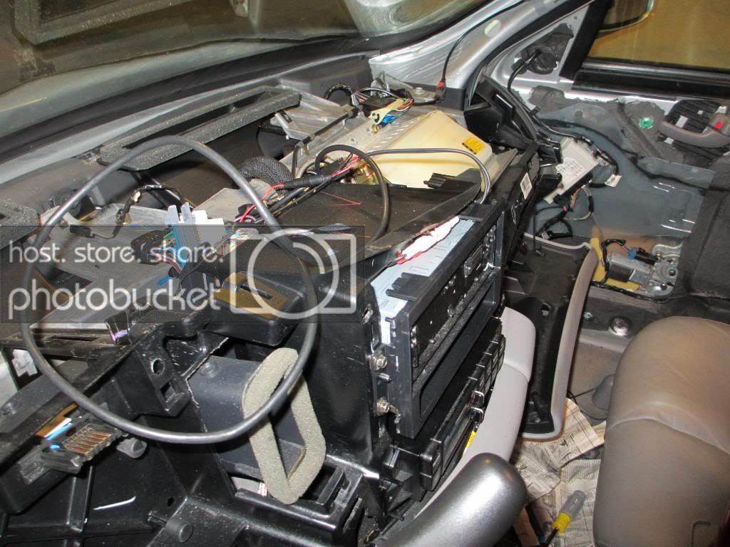

i had to take the top of the dash off to get the gauge cluster out, what a job that was!!

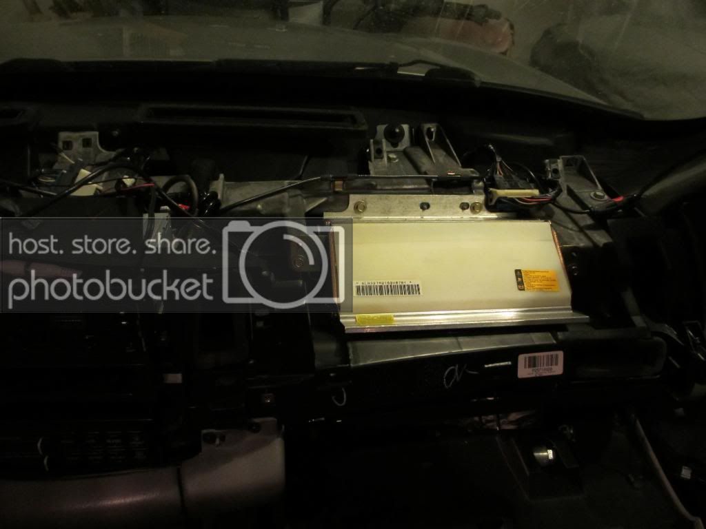

airbag, lulz

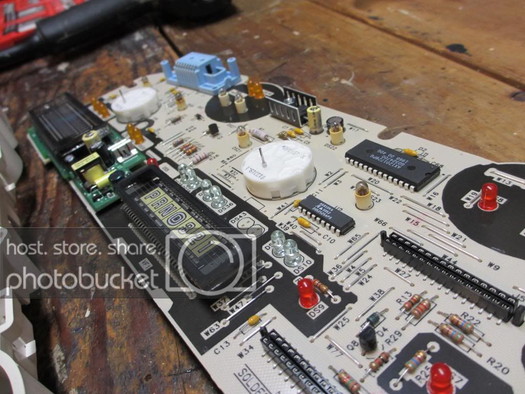

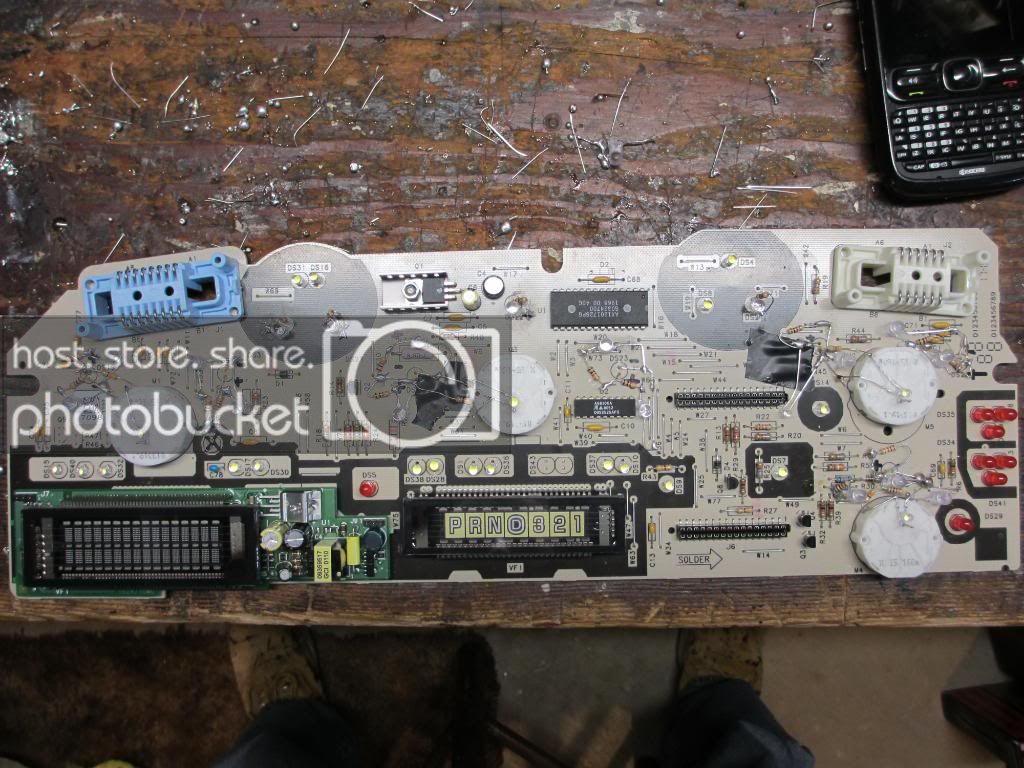

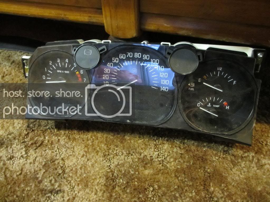

time to fix up this guy:

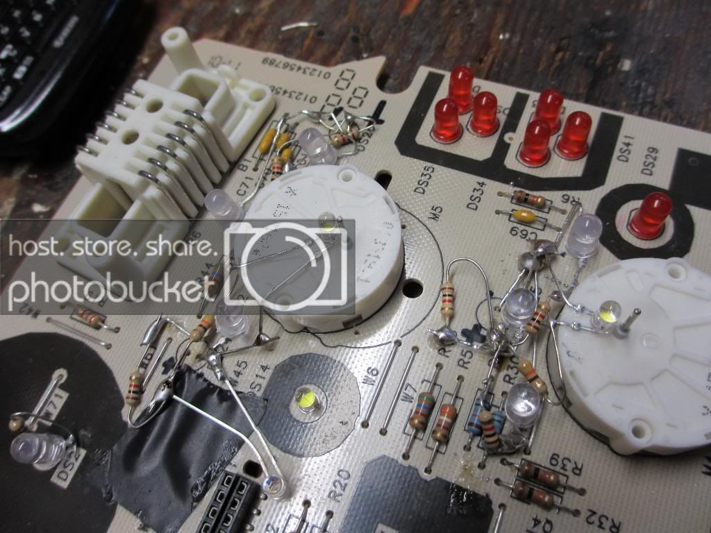

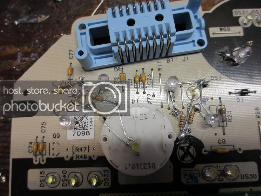

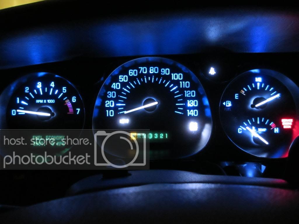

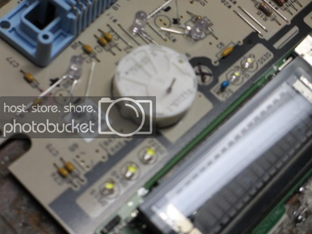

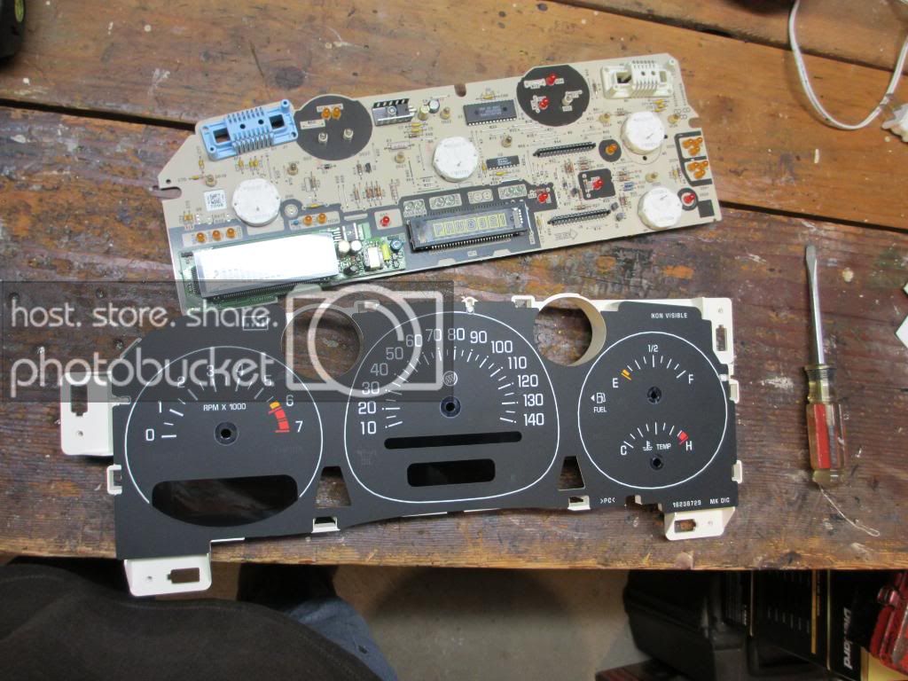

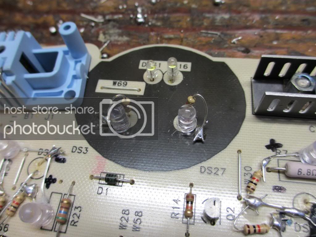

for what it's worth, I changed/added/fixed/whatever a total of 46 LEDs on this thing. I left two completely alone.

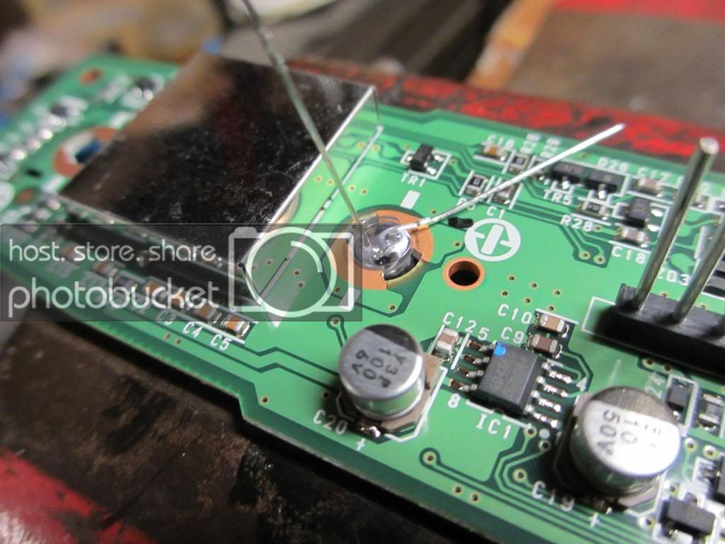

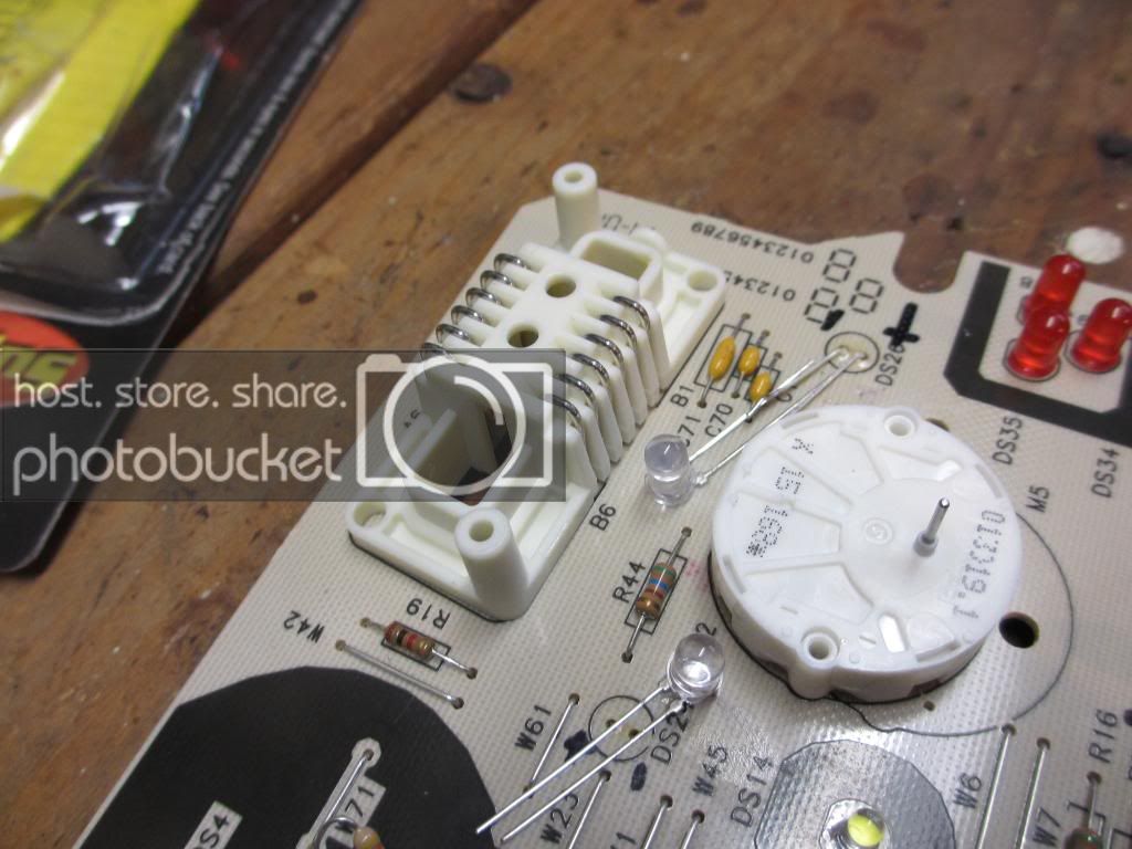

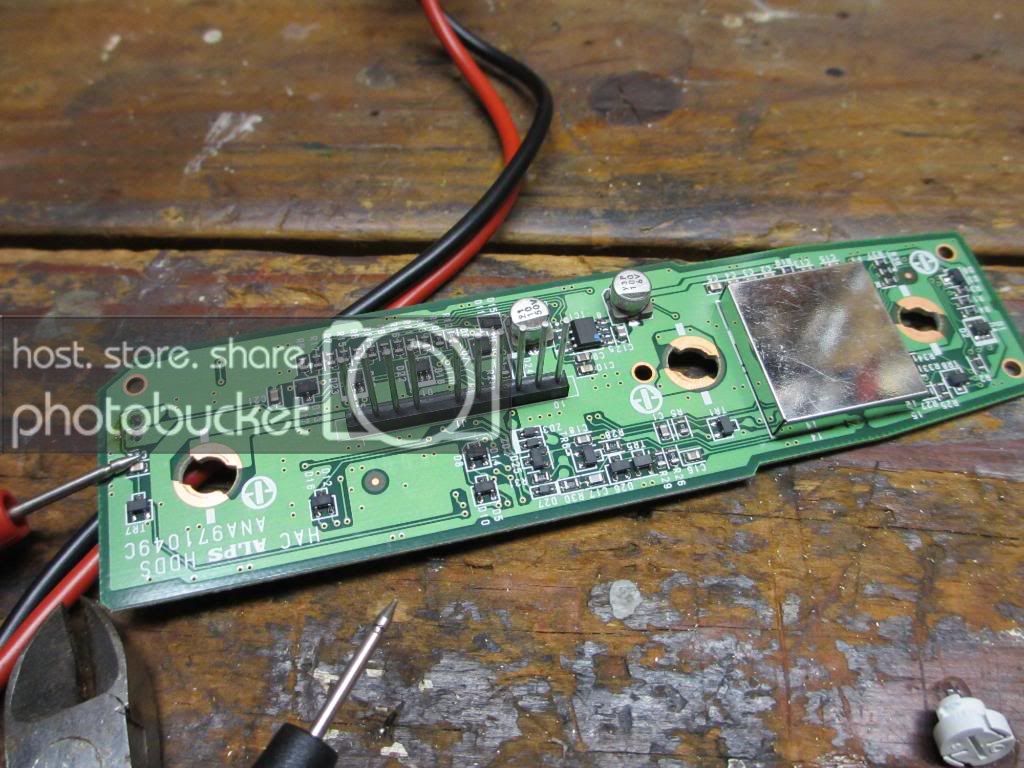

since LED's are not as diffused as incandescent bulbs (well, unless you specifically buy them like that, which i didn't), i needed to put more LED's on than there were bulbs, and in different places evenly spaced around the cluster. Basically, this simply involved measuring where the bulbs should be, supergluing them in place, and then soldering up power and ground connections to everything from the old bulb locations. Also, I had to go through and find +/- connections on the bulbs since incandescent bulbs have no polarity and LED's do.
this is the turn signal, high beams indicator, and ABS warning light.
tachometer.

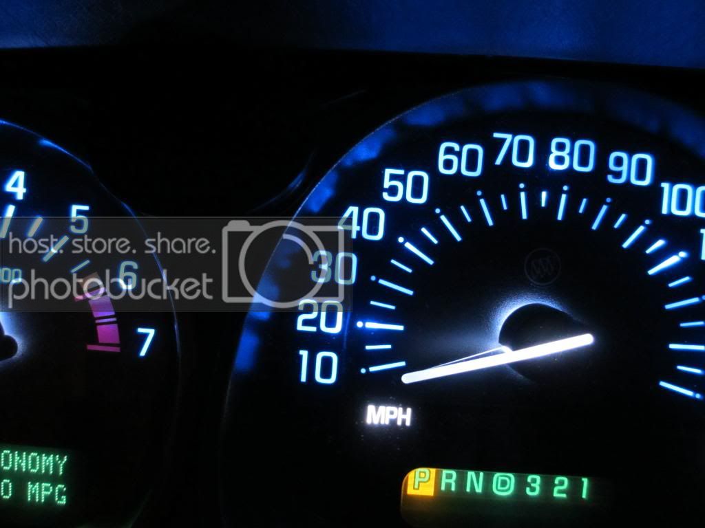

ALSO, note the small LED glued in place on the while dial. This is a white LED that allows the needles on the gauge to be white even tho the rest of the gauge is blue. It looks extremely **** when it's powered up //content.invisioncic.com/y282845/emoticons/smile.gif.1ebc41e1811405b213edfc4622c41e27.gif
temperature indicator and fuel gauge
glory shot of whole thing, going in. I did have to mess around with resistor values some to acheive what I felt to be the correct brightness - for example, the first resistor I had on the high beam indicator allowed the LED to be so bright that when you had the high beams on you could see LESS on the road. Not good. All of this got fixed and....
believe me, it looks 1000x sexier in person. Try to imagine the numbers a deep blue and the needles white, because that's what it looks like IRL.

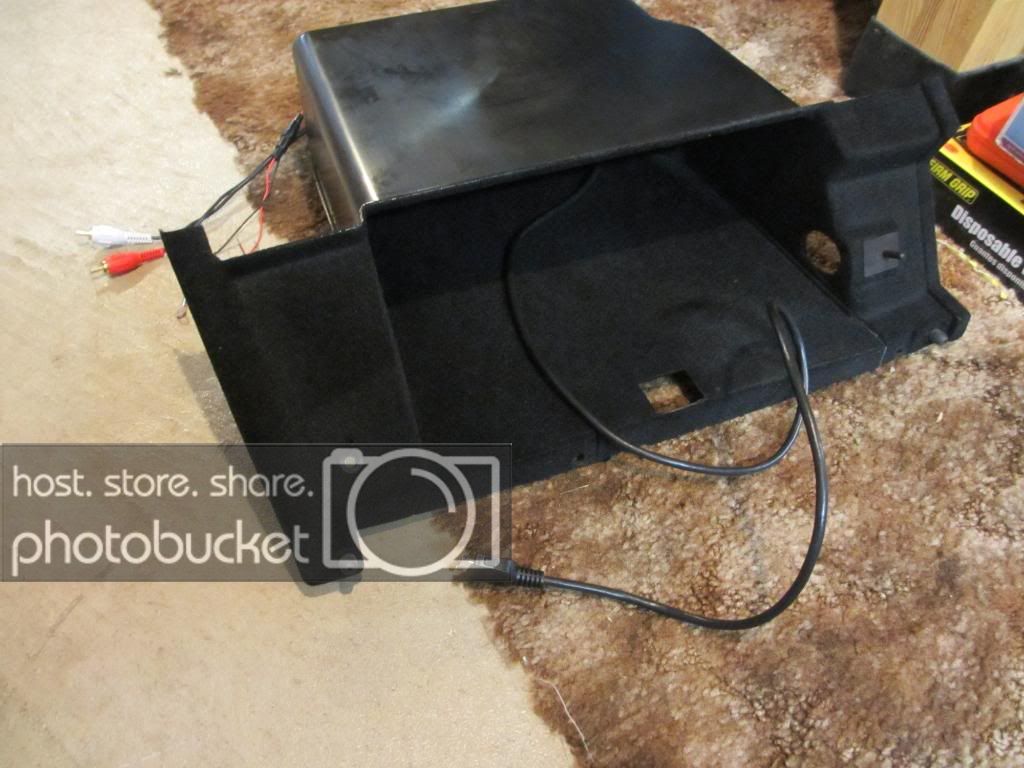

ran an ipod connector into the glove box. My friend's honda had an ipod connector in the glove box and I thought it was a neat idea so I copied it //content.invisioncic.com/y282845/emoticons/smile.gif.1ebc41e1811405b213edfc4622c41e27.gif

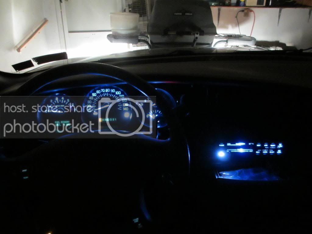

this color scheme also matches my HU, which is blue and white. The total package is nice since basically all the interior lightning now matches including the radio.
