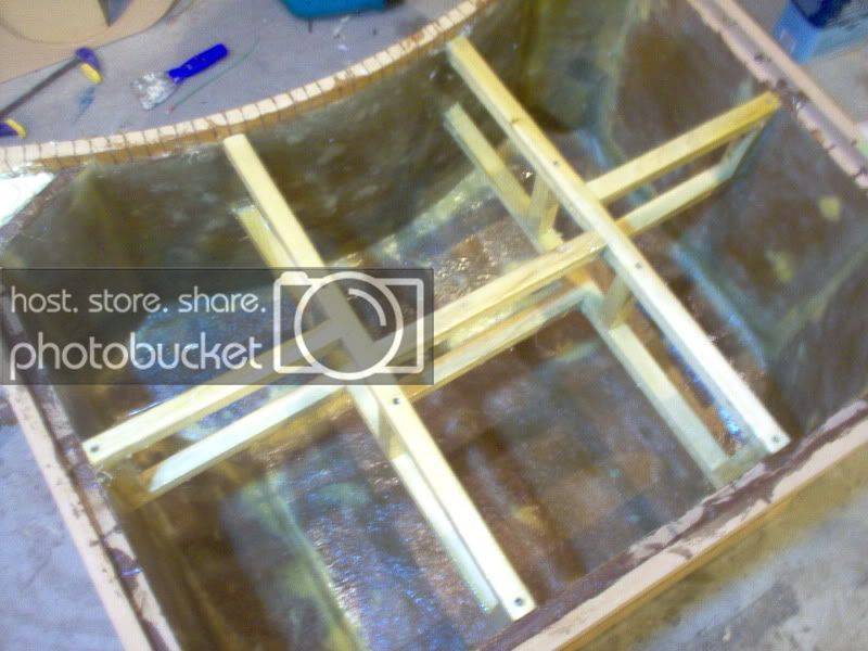

I did tear apart my old box in my pics.
I guess I can put it back together but it may not be worth it.
I was just going to redo it to fit 4 subs, but then just decided to build this.

That cerf now had double layers of MDF.
Baffle is 2 layer and sides and bottom are 3 layer.
Voids in the corners are filled with solid resin/sand. and the entire interior is coated with 6 layers of fiberglass matt.
It should be sturdy, I designed it to hold up to 170 dB internal SPL which should translate to almost 160 at the dash.
Actually 156.4 is my goal.

Oh wow, so this box is costing a bit to build.
only about $200 or so.The lighting will cost alot more than that.
