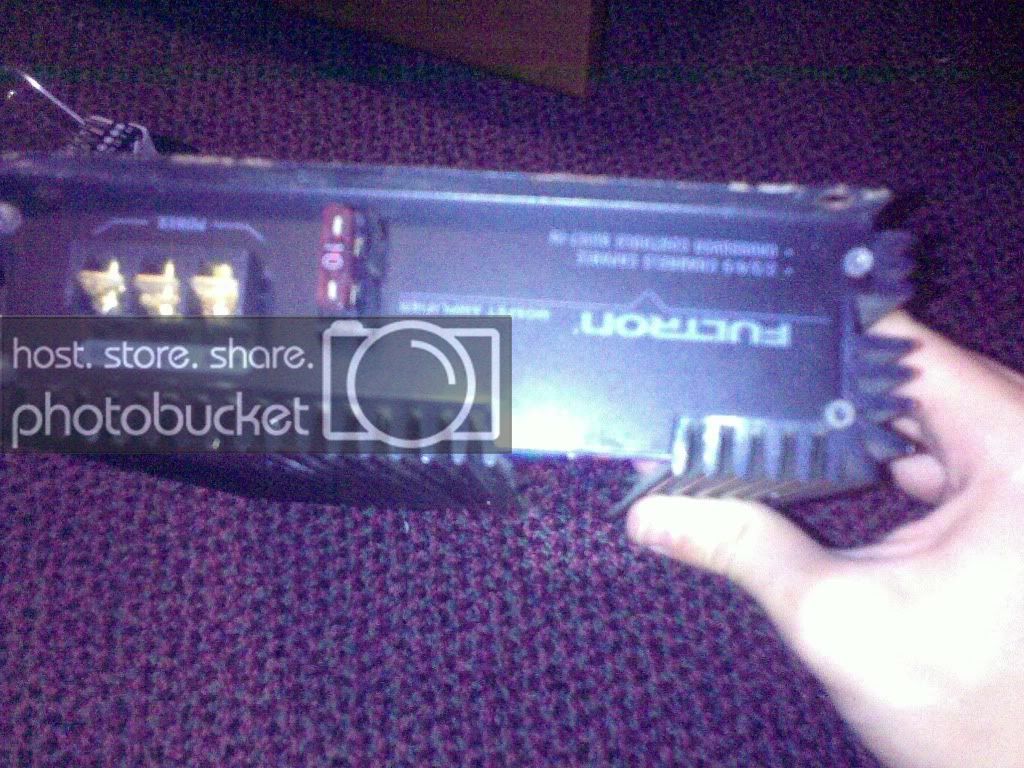

My fultron MX140-4 says 2 3 4 5 channel amp. I know you can wire it to run the front and rear stage as well as a sub. Does anyone know how to wire it in such a fashion? old school ftw
can't read it but i figured i post a pic anyways
Edit: that also supposed to be a 30A fuse
it's easy, you run it like a normal 4 channel amp than speakers 5 and 6 will plug in to the bridged output. you'll have to use an inline crossover (bass blockers) for this to work. BTW this only possible b/c your amp has tri-mode capability
