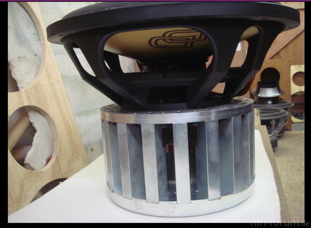

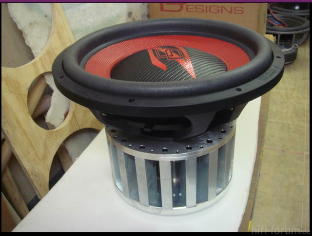

There are a few 4in Z motors out there. So yes they have done it and they are loud
A few as in prototypes that fell short of the 3" version? If they were better/louder that's what DD would be manufacturing and selling I can assure you.
Have you modeled those Z's? There's good odds that they'll keep gaining if you can make that box bigger assuming you're not hitting mechanical limits.
Not like 4" coil is "new". The TC 4hp has been around for 15 years now and while that platform is capable (TRF, T3 TSNS, etc) what's been setting world records in the SPL lanes is 3" coil woofers. Notice DD hasn't yet put a 4" coil into their Z? You don't think they've prototyped this?
Zv3 is a super platform for getting loud in a small box. You'll be hard pressed to find a better performer if that's all the space you have. If you have a meter, time, and wood/tools, I'd suggest that testing and tweaking boxes is the other next best thing you can do to gain. I still maintain that throwing 1000$+ subs at your current box and hoping you'll gain with be an expensive and disappointing venture.
Yes, they have made a Z4.
They didn't fall short of anything. They are expensive as ****. Pretty sure they will still build them if you pay.
As opposed to the regular ones that are 2600$? LOL. What do you think it costs DD to make it in 4" coil over 3" coil? 15$ for the coil? 5$ for a little more steel in the top and bottom plate?
Trust me, if the 4" was better/louder Dante and Butler would be switching to them and gaining and DD would be touting them as "new and improved" or "even better".
The motors are actually quite a bit bigger. Also, you're paying for the R&D work of testing what ratio is close to perfect.
If I could get my hands on some 4" coil Z motors later in life, that would be awesome! Waiting on them to make a 5" coil motor like B2 has except column-neo style //content.invisioncic.com/y282845/emoticons/smile.gif.1ebc41e1811405b213edfc4622c41e27.gif
Called DD this morning.
They no longer make the Z with a 4" coil. They don't even stock parts for it anymore. It was a limited production run, and only 20 were made.
The reason they do not make them anymore is cost. He said a Standard Z was $2,800 and a Z4 cost $4,500.
The main cost was in the motor. It is much larger than the Z3.
