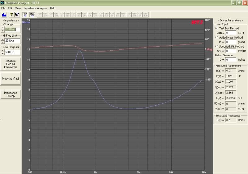

you really should get the impedance plot of the Boston tweeter, then get a new tweeter pair that matches it.
I have a Woofer Tester 3 that can give impedance plots. Mail me the tweeter and i'll test it for you. The test takes about 5 minutes from start to finish. I'll mail the tweeter back. if you include the pair, i can see if it's a simple tinsel lead that came detached on the non-working one.
thats some cool ish bro. I think I'll take u up on that offer and mail u the tweets and see what you can do. pming you now
