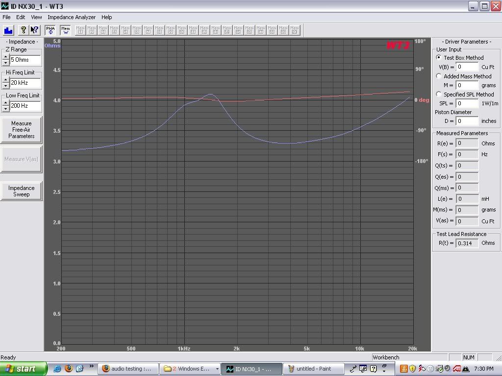

here is a different tweeter, an ID NX-30
the cool thing about the Woofer Tester is that it can also sweep with the passive crossover in-line.
