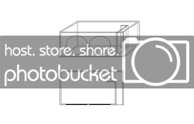

ok, i want to do a ported enclosure for 2 12" d4 Type R subs, i would like to pay someone who could do a GOOD design for me......
i would like double baffle/flush mount and most importantly flared port, both sides not important, but i do want the inner side of the port flared. must be no taller than 16" no wider than 48 and no deeper than 32 (that should be easy enough) it will be going in the cargo area of a 02 gmc yukon denali.

Put those R's in 2.5 cube a piece, so 5 total, tuned to 32~34 with 60~70sq in of port total. (30~35 a piece) And give them some power (they will handle 1000wrms a piece in 2.5 cube daily, each)

^^^ With that power, that enclosure, and with a flared slot port on each side, you would be movin some air //content.invisioncic.com/y282845/emoticons/tongue.gif.6130eb82179565f6db8d26d6001dcd24.gif
