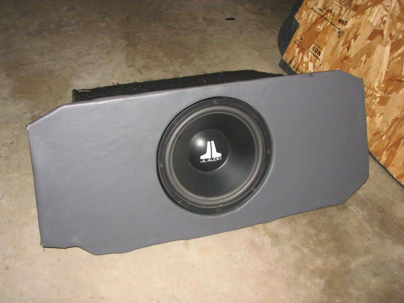

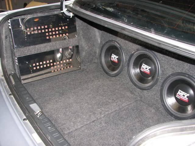

examples of some testing in my own Accord:
This
Was MUCH better than this
And just facing the ported enclosure forward without a baffle wasn't as good due to phase interference
this was boomy and lacked overall accuracy, typical for all rear facing enclosures without baffles.
this was an enclosure i experimented with a lot - different orientation and angles, but with a baffle it was the best
you can see one orientation through the opening, this one was the best as far as trunk locations went
this is my current setup and hands down the best one
