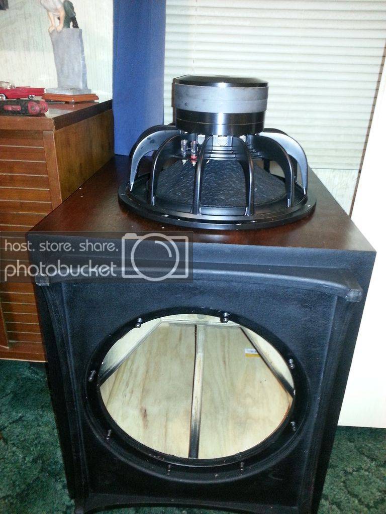

Pic in my avatar. Custom built.
I'm not looking for a 18" sub for the truck. I was obviously joking about looking for that type of output when I'm clearly looking at 12's ...
