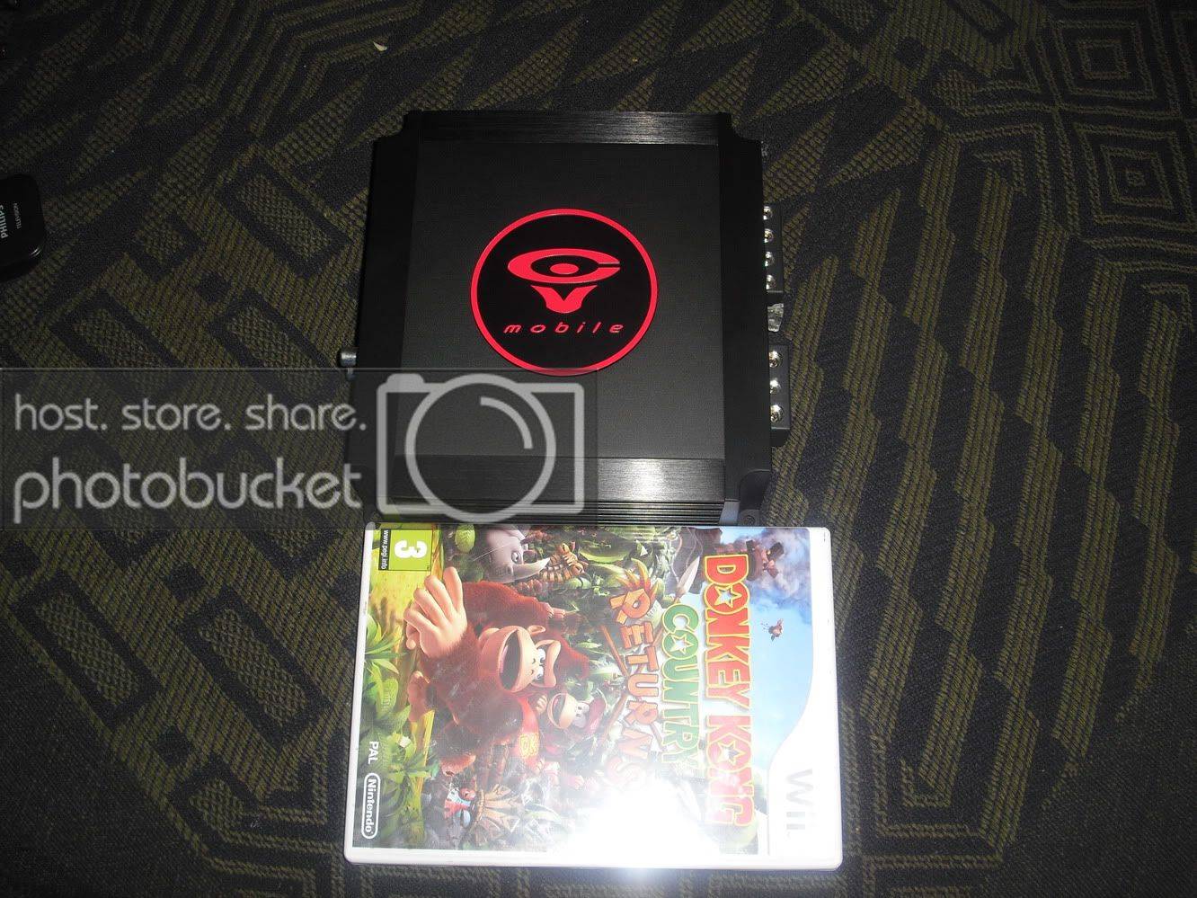

That is definitely on the big side- too thick to stuff inside the dash. The Elf Audio / Arc Audio ones look great, but I'll have to find a used one. The Alpine KTP-445 looks like it would work too.
