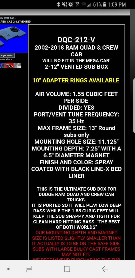

Foxbox on 1500 watts?.. id go sealed first. I'm not sure where you'll be tuned once the displacements in the Foxbox are accounted for and the last underseat Foxbox I saw had pitiful port area... certainly not enough for a 1500 watt amp
I could be wrong but IMO sealed would be preferable to that Foxknocks (at 45hz).
Foxbox on 1500 watts?.. id go sealed first. I'm not sure where you'll be tuned once the displacements in the Foxbox are accounted for and the last underseat Foxbox I saw had pitiful port area... certainly not enough for a 1500 watt ampI could be wrong but IMO sealed would be preferable to that Foxknocks (at 45hz).

is it 1.55ft3 net ad?.. I suppose I could be wrong but the volumes and tunings given are before displacement unless I'm mistaken
Before displacement. The problem he will run into is finding subs that fit. SA's fit but anything with a large magnet or designed deep will not fit.
But that is always the case for underseat applications. Especially those using the storage compartments as the main area to get air volume.

Could you link the box you've got thats 1.55ft3 per?.. Im curious if you'd measure the port area and length for me... I'd like to check tuning ad if It's not too much trouble, what sub are you using btw?
Yeah, not measuring ports as I would have to remove the subs to do so.
One has JBL gt-10's on 500 watts. It is the original box for 10's which was 1.15 cu ft (I believe, it's been a while) per sub.
The other has SA-12's now. It has had others.
The 12 and 10 box is the same now, just use adapters for tens. Haven't used the new version.

Bringing back an old thread...I am currently running a Fox Box with 2 - SA10's on a T1500.1 @ 2ohms and it knocks. I did a lot research before I bought the subs and the general opinion was that for this box the 10" subs with large magnets work better and sound better in the dual 12 box due to the displacement. I like how mine sounds but would be curious how it would sound compared to a custom made sealed enclosure built to spec.  Anyone run the dimensions and figure the tune out to see if its was Fox says it is?
