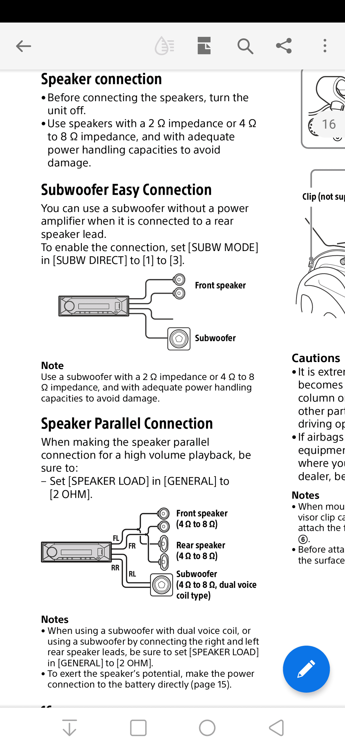

It does have this info-
It looks like you are to connect each coil to a rear channel. That will give you 45w per coil.
Well, I'll give you full credit, but them half credit. So that's only if its a DVC, and 88w is still nothing. Where do we they draw the line for marketing it as subwoofer power, 70w, 32w, we have 6w of sub thumping power. It's disingenuous to say the least. It's like saying we have a $2.99 all you can eat buffet, but all we serve are rice cakes.
