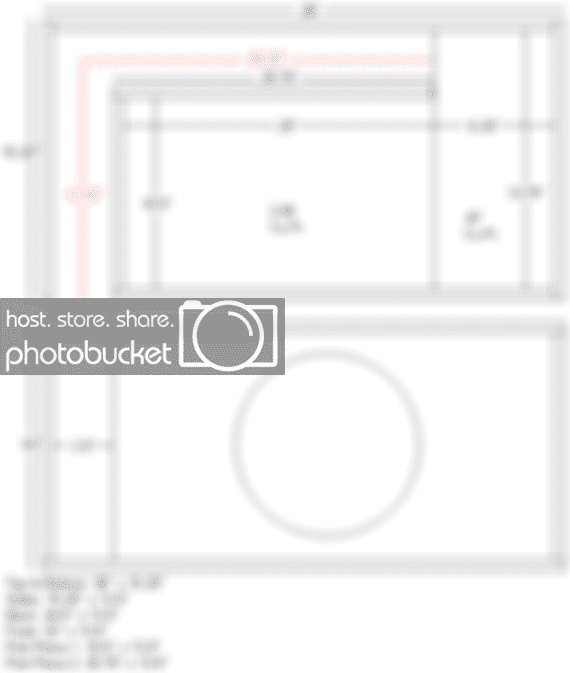

Any idea if the 36'' top box can be made with a single 4 x 8 sheet? Im trying to puzzle it out and it doesnt seem like it unless theres a puzzle piece that I dont see.
you have 48 inches by 96 inches
make your cuts like a bar graph, combine side cuts and combine port cuts. total will take up 84.5 of the 96 inches and each cut will have plenty of room to spare with the 48 the other way. here's a quick mockup
