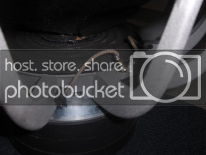

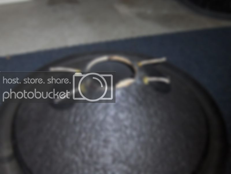

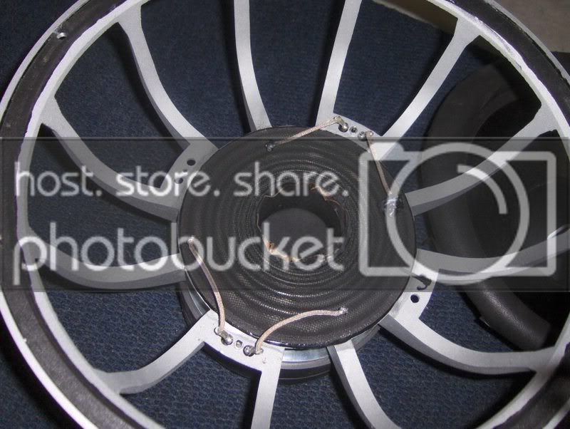

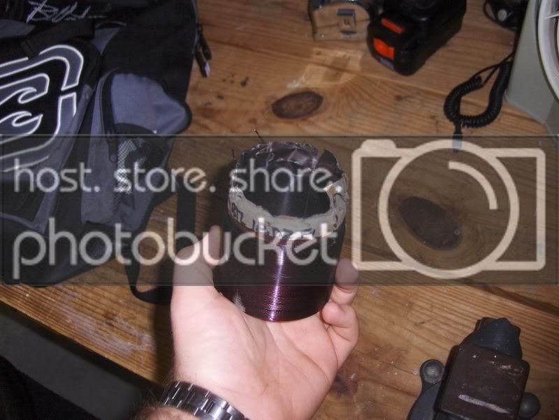

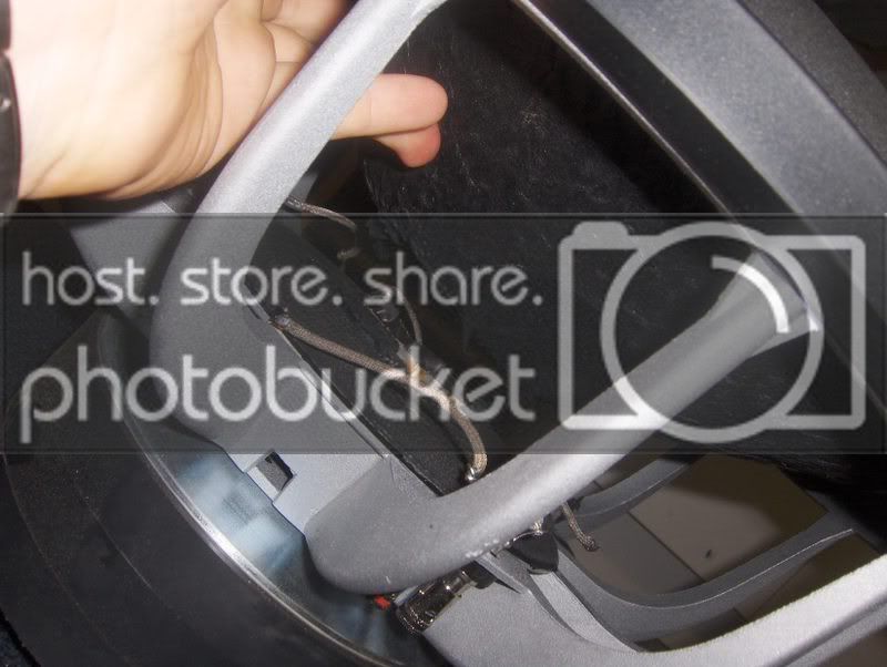

One thing I will say is dont run 5,000rms to a BTL daily. I dont know how the hell Meade or anyone else does it, but it doesnt seem to work to well. I mean they really took the abuse I put em through... Especially for 2.5x their RMS @ .35ohm in a big ported box. We dropped the 2 top subs today and on one, the tinsels are broken, and in both the cone is seperated from the spider. The coils are a little dark, but definately still playable. The speakers are cut up and waiting for recones. Gotta order em either today or tomorrow. I wont be making the show during the weekend, but whatever. Im just runnin the 2 bottom subs for now. Goin easy on em. They're loud enough for a daily beater until I get it all workin. I mean with 2 subs I can still do hair tricks with both windows all the way down... Anyways, Ill take a pic of the tinsels and cone seperated and show you guys later.

Well, here you go. The reason the former is so bent is from the cone slapping it from playing the other subs.
