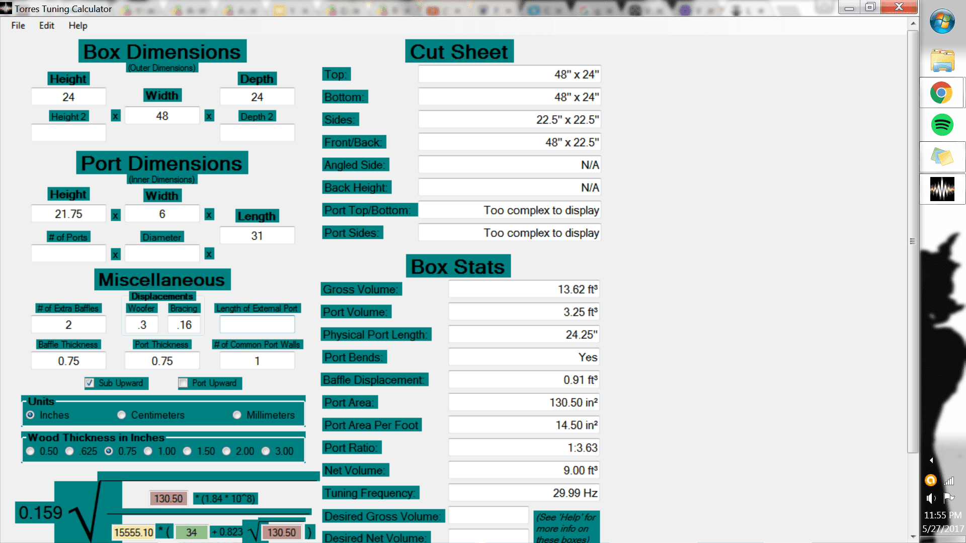

I'm finishing up a design and starting the build in the AM but I'm having an issue designing a port people do it differently and none of the calculators are really a full help. The box is 13.32 cu ft after .30 cu ft is taken out for speaker displacement. Running 2 skar evl 15's (for now). Outer dimensions of the box are L 24in x W 48in x H 24in. Tuning to 30hz any help would be much appreciated thank you
slot port sub up port back, triple baffle with lots of wooden dowels for bracing.
