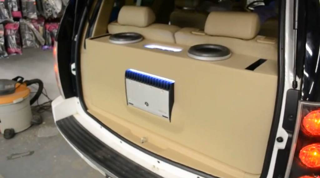

Looking for more output. I currently have the HO110w6v3 and it fits and sounds good but I need more so am considering g adding a second 10” w6v3. Or ?? Maybe a t-line for this 10” but will a t-line give me more output?? Here’s a pic of a Yukon that has two 8”s. Any ideas please share, thanks

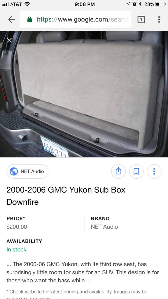

Here’s a down fire but takes all of the space

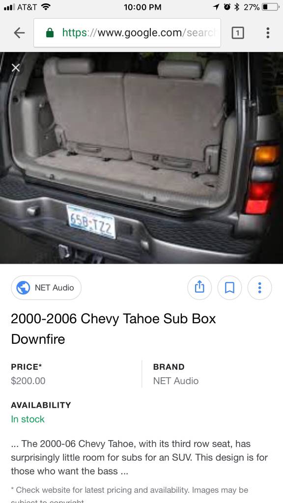

This is the space that I have to work with
A t-line is gonna eat up all that space behind there and possibly may not have enough space for one. I currently have a single 8 in a t-line and turns out to be about 3 cu ft once the math is done. What takes up the space is the super long length of the port.
If you can do something like the very 1st pic might be ideal. Do you need the 3rd row? if not, that would dramatically increase your space immediately. If you need your 3rd row, re-read my 1st sentence in this line. Otherwise your very limited on things...

Clean install but port placement is wrong it can’t load

To down fire properly ports need 6-8” to load properly and it still don’t look like 6” gap but this would sound better than the OPs box even though possibly only 3-4” to load

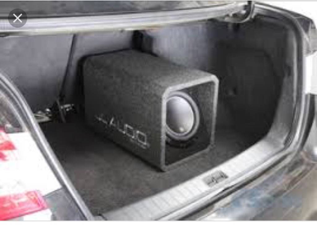

Another idea is to add a second HO110w6v3 - watch this video. I’m concerned with the sub and port being so close to wall though.

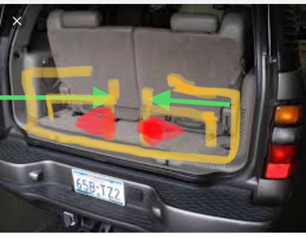

Look like a can’t add video , anyhow, this sub facing the right side wall and a second box like this with the sub facing the left side wall. There would be 2” of space between the box and wall but since the sub is in an angle, the port is a little further. What are your thoughts on this ??

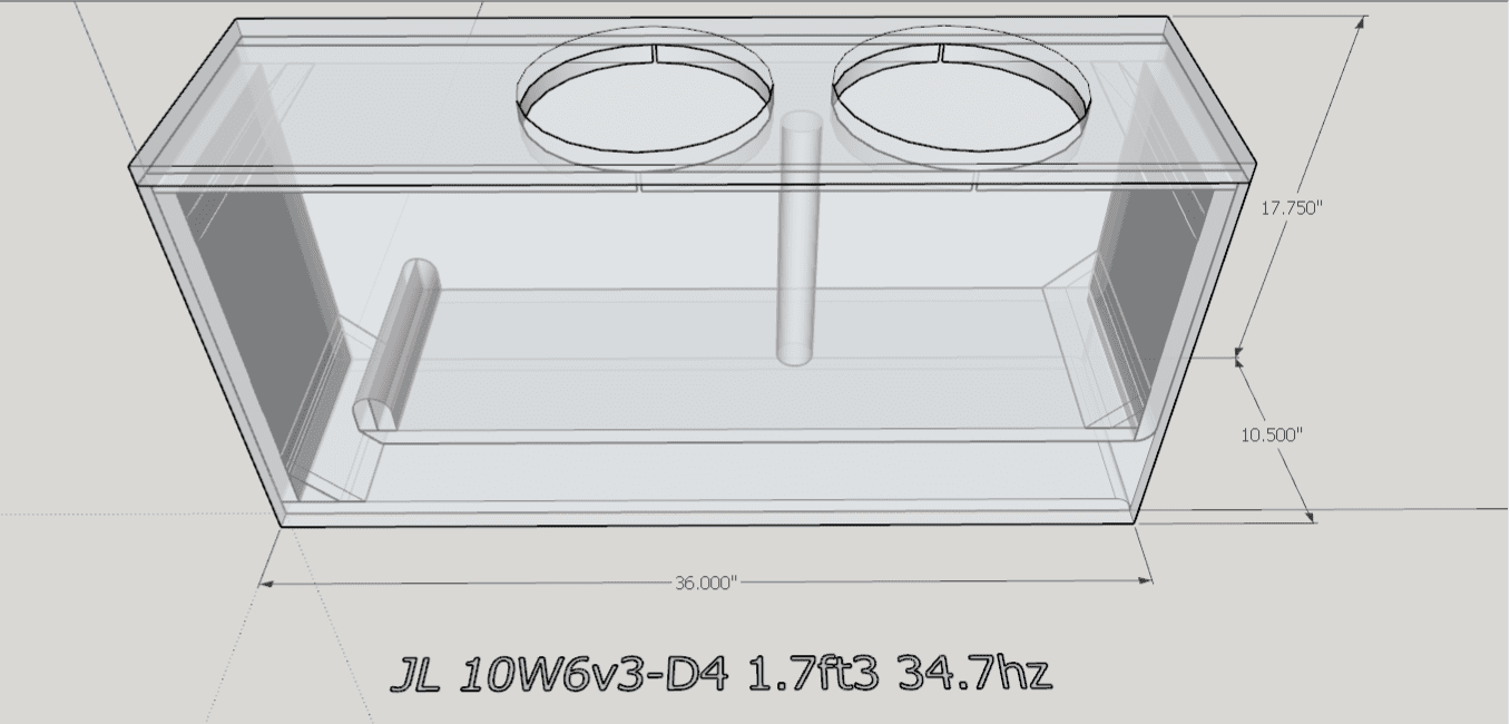

This is one I had on paper so I put it in Sketchup. It went into a Nitro and turned out pretty good... IDK if it will fit though

Looks like it might fit - your post is at the bottom though , right ??

Port is at the bottom firing towards either rear corner... I'm assuming you got around 48" width so it should have plenty of space to work back there
