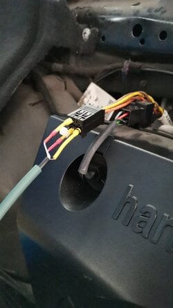

Aux cable connected to factory sub cable:
It plays very good, even the rear view mirror vibrates now :D

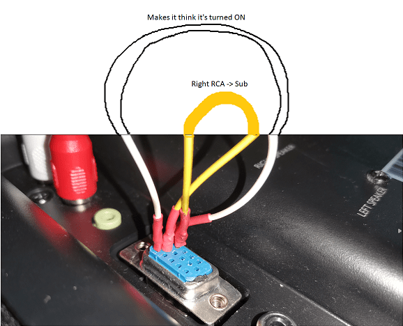

Bypassed this:
With this:
