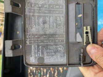

Hi, Im installing Ventrue N4 Pro dashcam in my 94 F150. Its calling for a ACC fuse. Not sure where or what this is. Cant find on diagram. Thank you
Many thanks guys. I tied it into the radio fuse. 1st timer here in a long time. (Used to do this in highschool)
Should work good there. I always try to use Accessory when available for power and and ground at the rear frame work under the dash, and use On/Of with Radio, or cig. Lighter if it only operates by ignition to power up.
