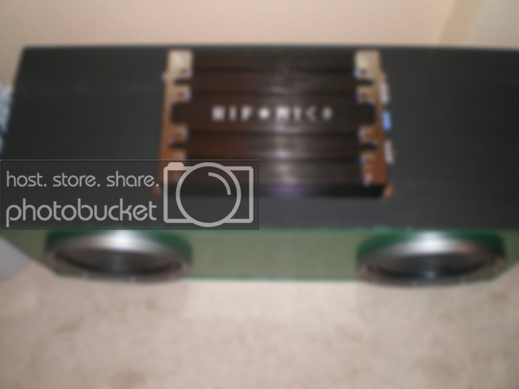

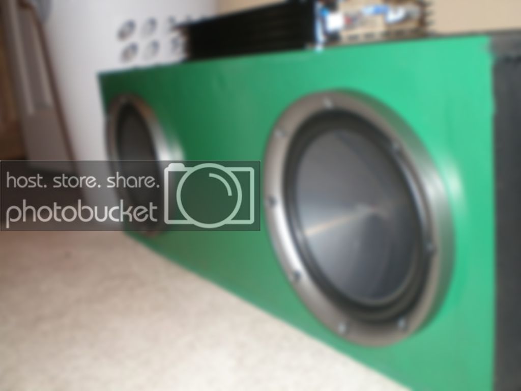

Since my project is on hold, i figured i would throw a little budget system together for my girlfriends new (to her) jetta this weekend. I built the box in about an hour, including cutting the wood with a circular saw and assembling, so its not the prettiest thing i've ever created, but it will get the job done in her car. I figured a few of you on here might like a look at a budget built that should pound pretty nicely.
(2) 10" Kenwood KFC 3011's ($60 total)
-Hifonics ZXI6006 (had) pushes 600RMS @ 4ohms. Ill be running at two, so we'll see what happens. I may have to buy a different amp.
-4awg wiring kit from knukonceptz ($26)
-Pioneer DEH P3000IB ($90)
-stock speakers (they are pretty **** nice though, i was surprised)
total spent was right around $175
Box is 2 cubic feet @ 35hz w/ 32" of port area. She wanted to keep most of her trunk, so these will fire into her rear seats, and i'll build a beauty panel to attach to the back of the box to seal it up, and make the trunk look like a regular (but smaller) trunk.

i always wondered why ppl mount amps to the box. it just makes it an easy steal for those punk theives. plus it's usually a longer run for ground.
for the second time, everything will be hidden. Plus, with what im trying to achieve, its the best place for it.
After the beauty panel goes on, the only way to get the stuff out will be to break the box.
