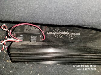

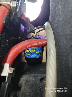

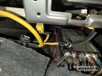

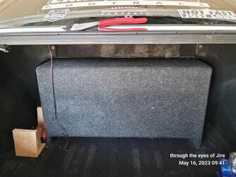

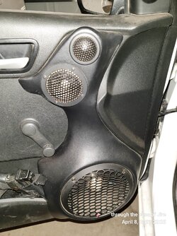

OK. So The sad thing...I dont remember the exacts on my system anymore. I have Crossfire 12's in a custom box downward firing, drove by a crossfire C5 1000D, Audio Dynamics ADMK 1000.6 driving the Audio dynamics mids & highs (front & rear) as well as a pair of kicker 8s on the door for mid bass. Went with an aftermarket high output alternator & 2nd battery. (& the check engine light has been on ever since! Had to throttle the voltage down. New cars dont like 14V I guess)with a Stinger SGP35 (only throwing that in there cause I dont know shyt & thought it MAY help LOL) .
Seems my amp is dead (installer told me to check the impedance on the disconnected sub wired & I got a range of 1.5-2.0 ohms. So he said my amp is dead) The amp has the blue light on for power, I smelled no smoke when it stopped working & it hasnt returned since. IF its new amp time...IDK where to start. I dont have a great budget, but Id rather pay a little more now...than a LOT more later. Seems Crossfire is no longer an option either. I LOVE my BOOM BOOMS, & SQ more...(ya, found out well after the fact the subs I got were not the best choice for SQ )

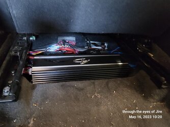

So I guess what I am asking is...is there a way to test the amp before buying something new. Then, is I have to get something new (current amp is under the seat) what should I consider? I will trunk mount if I HAVE to...but prefer another under seat. The pics are old, but same gear. & if Im being honest...I have no CLUE what the dam "bassRESTOR" by Wavtech even DOES!

Simplest test is to connect you phone to the amp RCA inputs with a headphone to RCA adapter cord and see if it makes sound / bass.
If that "bass restorer" is still in line with the Crossfire amp, unhook the RCA’s from it and plug the main head unit and or LOC RCA's directly into the amp, small chance the bass restorer took a dump and is quick to bypass.
If that fails, can wiggle the switches on the amp, just remember what setting it needs to be on, but I have had amps with dirty switches. Same with the level / gain pots. If it is a newer amp a few years old, this is much less likely a problem, but costs nothing to try if the amp is not working otherwise.

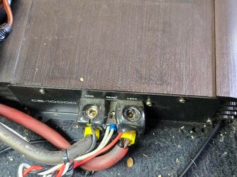

Welp, for an update: Amp DEF toast (LITERALLY) Patience is not my thing & I ended up with the AD2000.1 My installer knows how I drive with volume UP ALL the time, so the subs are hitting a lil harder & its turned down enough that I can safely run it for the next 4 years. I cant complain too much, this crossfire did last me 4 years. Never really "Pushed" it, but it served me well...RIP

What kind of connectors are on the ends of the power wire? Looks a bit odd. Melted terminals is caused from a poor connection, that is the only reason amp terminals will melt like that. Be careful with your new amp and how the wiring is connected or it may end up with the same fate.
That Crossfire amp should be repairable though with a bit of work.
