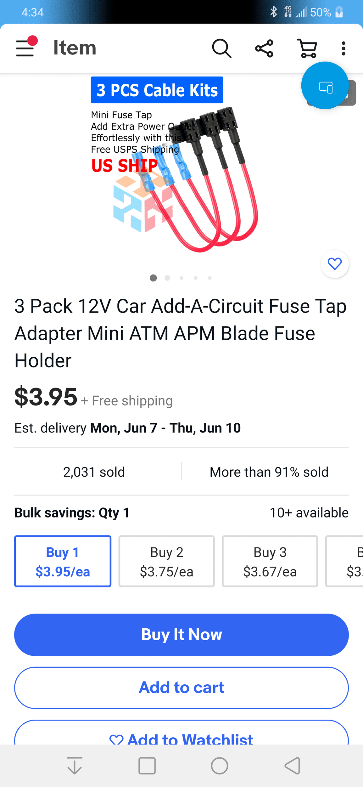

Then for LOC, can i run a wire directly into a fuse spot, or do i have to cut wires to gain access to a 12v source.
If you find a fuse spot that makes it work, leave it there. As long as it is keyed. I would use the Radio fuse. You can use a fuse tap like below.
Yes, power & ground to amp stay connected. Jumper will go from remote screw to positive screw of the amp. Only remote wire gets unscrewed.
