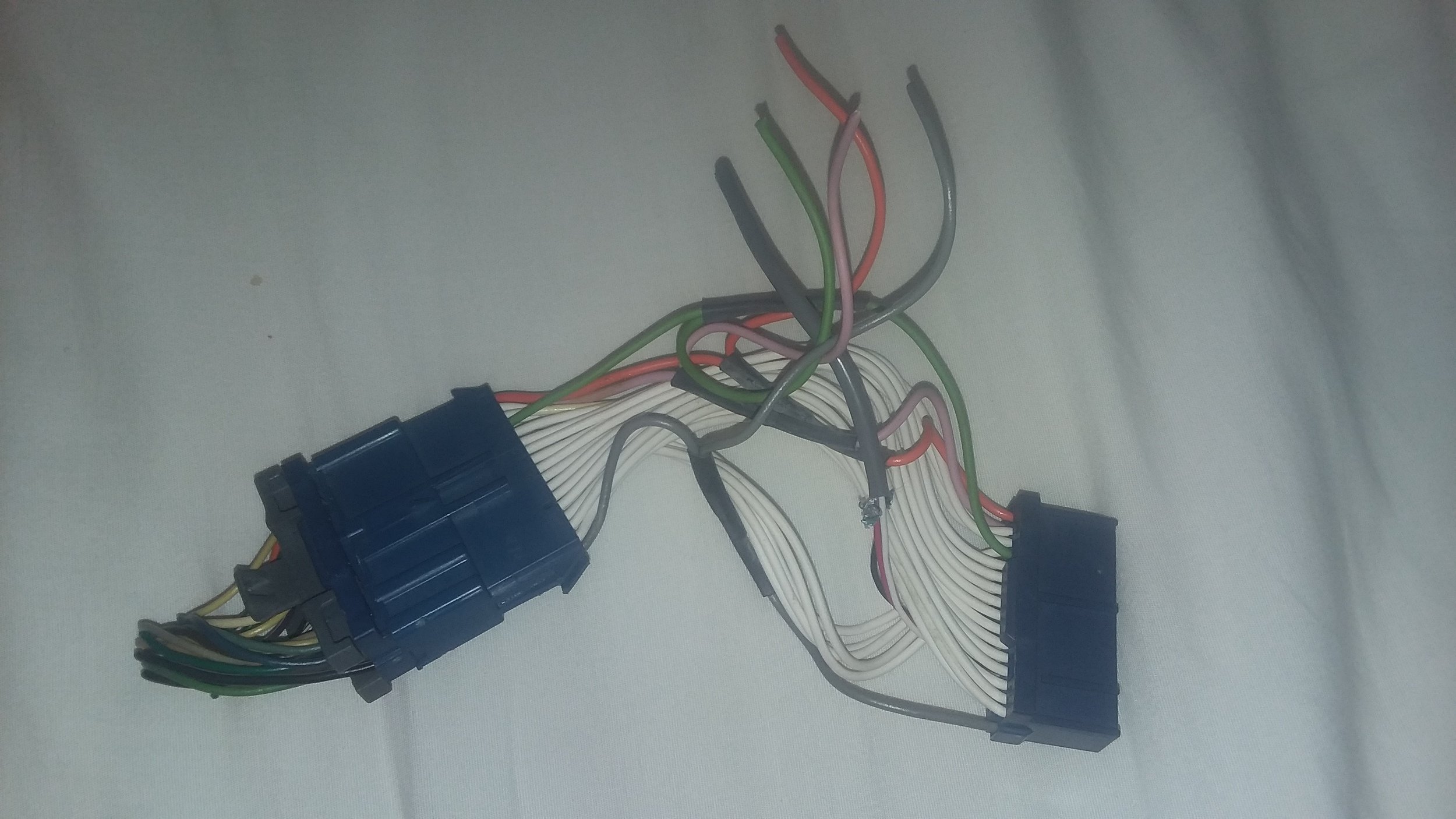

I forgot to mention that the salvage unit had what looks like an extension or some sort of adapter attached to it, something my harness didn't have. You can see several splices in it and I don't know if the cut wires were like that before or if it happened from the salvage yard just hacking it out with reckless abandon. The connector on the right is what was plugged into the backside.

I'm willing to put the salvage one back in and play around to see if it is just locked up, but I'm starting to think it was already messed up before I got my hands on it. The splices in the remains of the old harness tell me at minimum someone had been in there before and possibly it was even original to the car.
