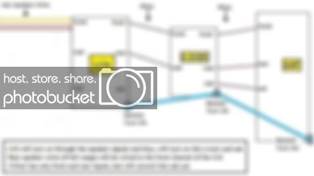

I want to hook up my Audiocontrol LC6 to my rear speaker wires
is the wiring accurate?
any help will be appreciated
will this work?
will I need all the speaker level inputs or will I be fine with just the rear speaker wires?
some people say that my 2004 Accord EX Coupe has full range rear speaker signals, but other people disagree.
if you connect the front only you will only get front left and front right output. if you connect rear only you can get rear left and rear right and sub output, you can only get front rear and sub if you connect atleat front and rear.
are you unable to connect the front speaker outputs?
The LC6 does indeed only need 2 channels of input to get in this case, 6 channels of output. The only thing that you are going to sacrifice by not having the rear inputs used is fader control (not that you should be using it anways...).
