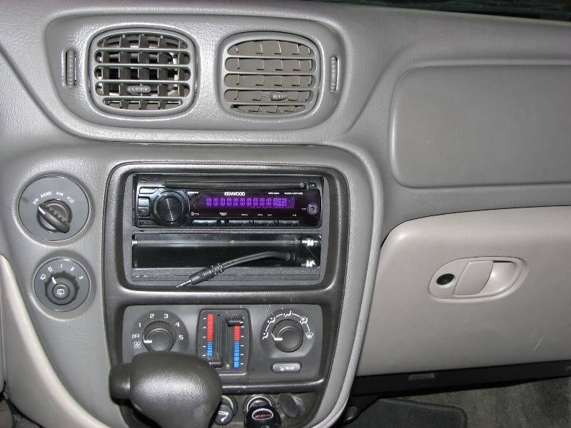

i replaced the head unit, ran new speaker wire back to the factory Bose amp location, and used the HU to power the interior speakers, incorporating a passive crossover for the front components. this was step one.

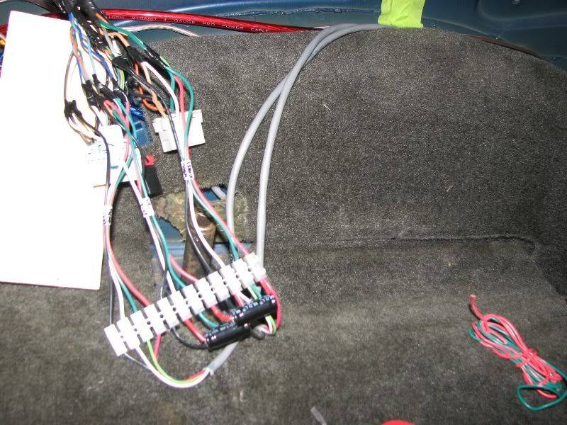

amp interface used a terminal strip since we were adding an amp soon after (he drove from Cali to Illinois, this was for the return trip). all connections soldered.

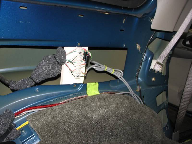

mounted.
we also ran power wire and remote for the amp. my brother-in-law later dropped an xtant 403a behind this panel to power the front speakers and a 10" sub. i'll have to find pics. amp went in the jack location. totally stealth.
