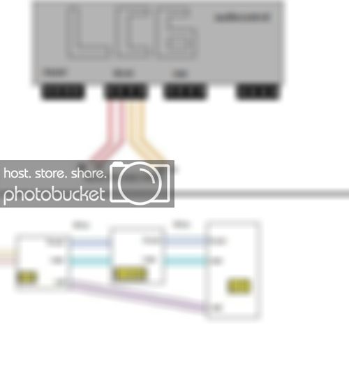

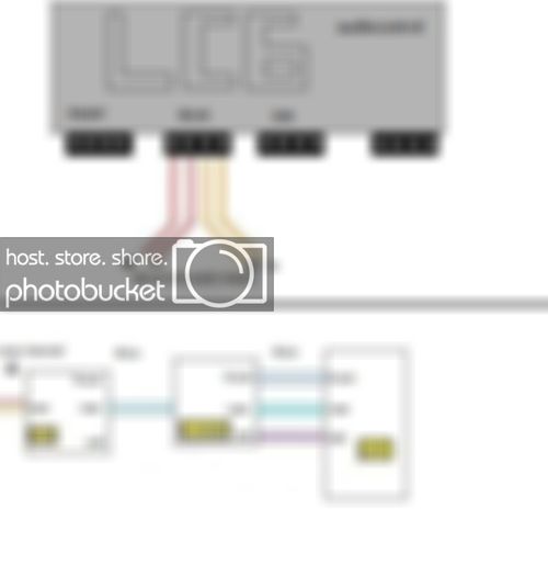

I wont be using my rear speakers....so I can tap those live speaker wires to the LOC and it will be converted into 6 channels of sound?
ok...here is what Im gonna do:
the 4 channels OUT from the LOC (LC6) will hook up to the x-over (front/rear)
the sub OUT will directly hook up to the amp's sub IN. Bypassing the x-over (amp's xover used instead)
My question is......would I get the same results with a cheap 2 or 4 channel LOC as I would with my 6 channel LC6?. Im thinking about wiring it from my rear speaker connections.
Yes that would work.
Just to clarify: Does your HU have a sub out? If not then you won't have a sub in for the LOC. You will be generating the sub from the x-over.
Most cheap LOC's work fine (try Darvex.com), but I wouldn't skimp too much. I think you should consider finding an amp that has speaker level inputs and built in x-over. You might get more bang for your buck, and much simpler to set up, by combining your budget into a single piece, rather than seperate LOC, x-over and amp.
You might find a 5 channel with those features, but certainly a 4 channel and a sub amp with those features.
