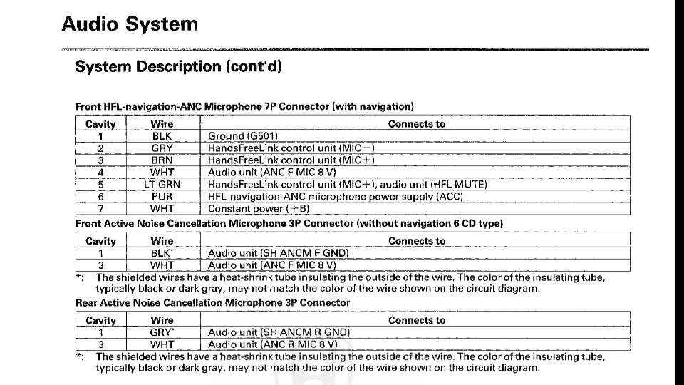

I unplugged the front and rear ANCs and have a wiring diagram for the 2008 Accord which may help - I'll get it up later. I don't have navigation and the 2008 doesn't have Bluetooth without Navi.
-Eric

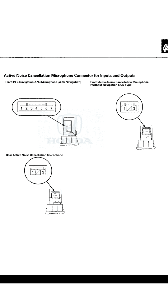

Sorry for the delay. Here's the wiring for front and rear ANC for the 08-10 Accord - 12 is most likely similar as I don't think the major change was until 2013.
In the image you'll see the wiring is the same color with and without navigation but the front plug is different and you may need to disconnect the correct wires as removing the plug might disconnect the navigation microphone.

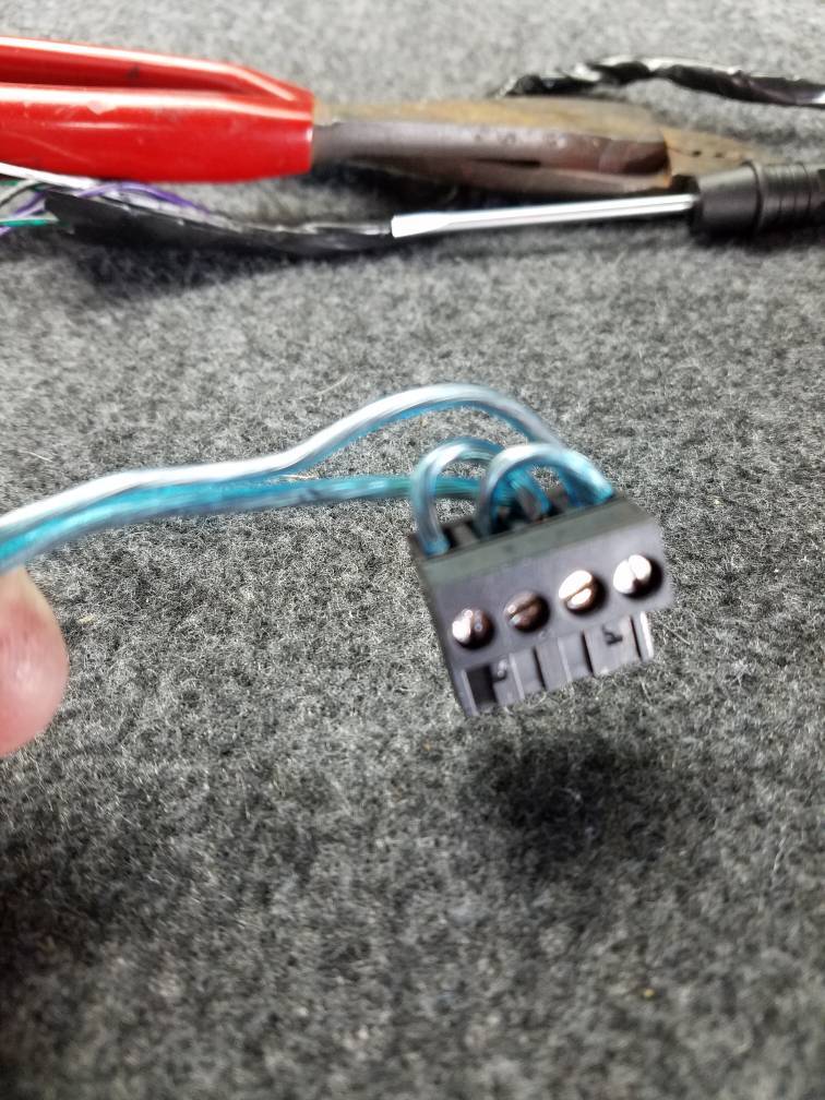

I installed a LCQ-1 this morning and while I need to get it dialed in I didn't lose bass.
I don't know how you addressed the single sub output in your install but I paralleled mine.

Now, THANK YOU so much for the wiring diagram.
I pulled the white wire (ANC) from the front plug, and I unplugged the module under the rear deck.
I still have the same problem.

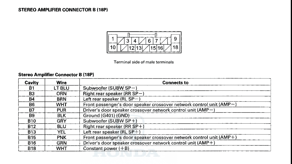

Here's the pin out I used and as I removed my rear speakers I'm running the fronts into the main input and sub into sub/channel 3.
I disabled summing and auto-mode and don't have AccuBass engaged. Currently gains on amp are all the way down with the levels on the AudioControl at about 80% and levels are just about right for running my HU at 28 (of 40).
