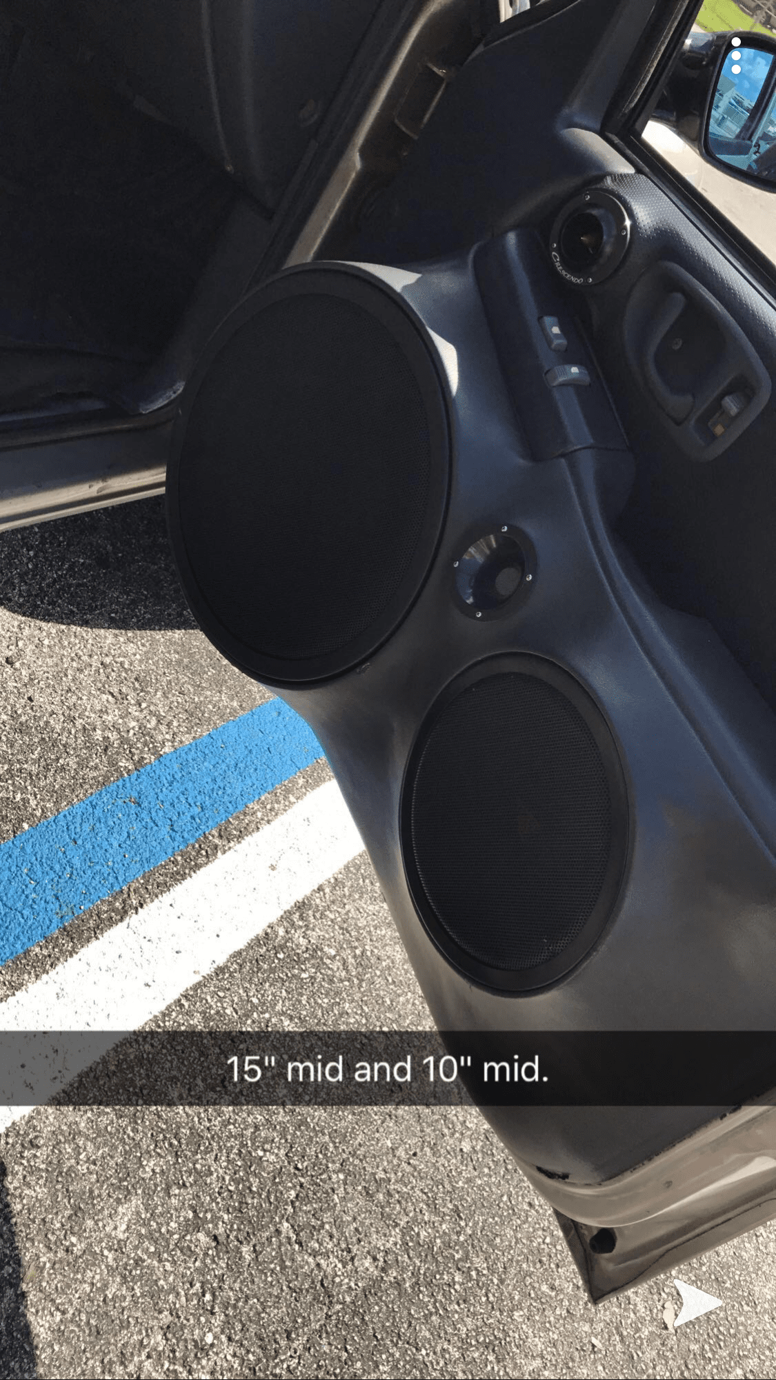

no car became any champion with subs in doors. Dedicated midbass yes. Subs no. Subs are omnidirectional, you dont need them right up front, actually you need it far away from you for the wave to propagate and develop which is determined by your car length and car material. Having the subs right in front, you'll actually get next to no output up front and your trunk will be the spot thats loud audibly. Thats how bass works. Not to mention doors are firing towards eachother, subs firing right at eachother is absolute dogshit.... Incident waves colliding with other incident waves without any proper loading wall creates NEGATIVE bass. Yes its the install, no one in their right minds does installs like that. Whatever you posted was a 15 inch midwoofer not a subwoofer. Subs DO NOT belong in doors. All setups you think that has a sub, its all midbass and PA midrange.

Well if you're going to go that route despite our recommendation then at least make sure it's a woofer you're putting in the door and not a subwoofer which will require way more volume than the door can provide. It'll sound overdampened and likely rattle the frame and sound like shit. The best bass comes from a distance larger than 2ft, there's no getting around that.
Found a picture of Justin’s doors finished on my snatch chat.
