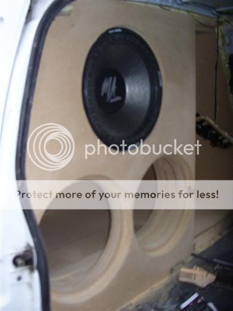

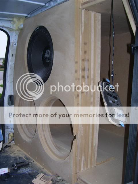

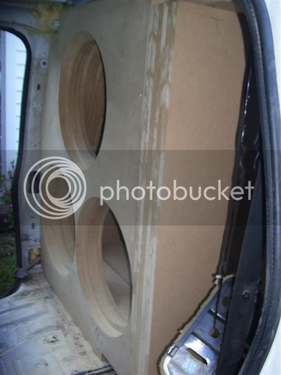

i think it will guide the wave a little but i would probably test it the other way before cutting all that out.
that orange van looks pretty nice.

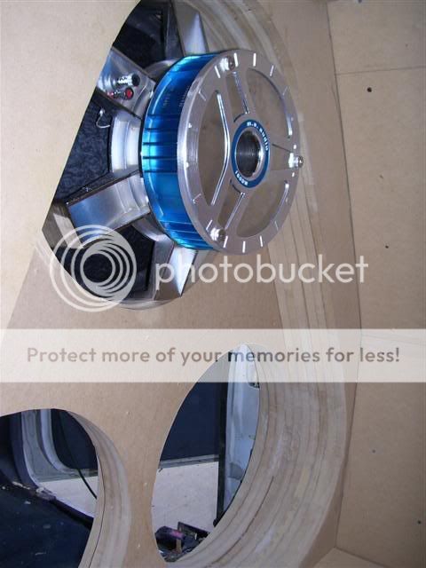

baffle wont be weak. its not done. plus u will see some threaded rod through the front to the back as well. which will make it strong. the baffle still have 4 more layers to go on it. so thats why it looks weak haha.

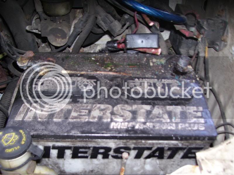

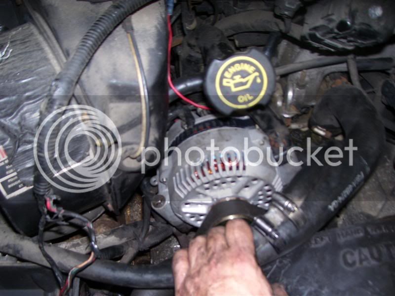

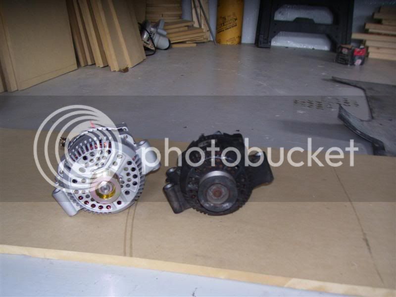

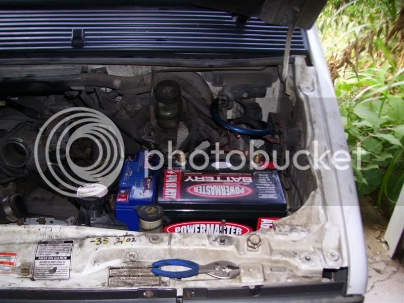

so i decided to install my 260 amp iraggi alternator and external regulator today. took out the broken battery i had under the hood. battery didnt even work. the kinetik 600 i had in the back is all i had to work with. even when i went to comp and managed to do a 139.4 30 sec average with the MA.
anyways pics....

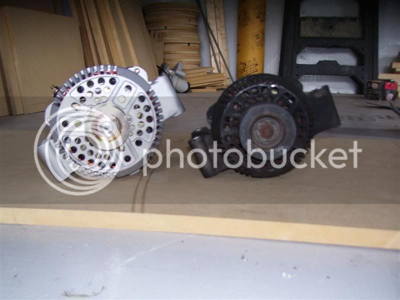

out with the old in with the new

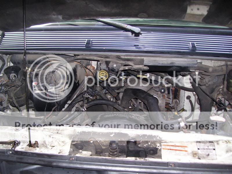

280,000 miles later......... i think its time for a rebuild and clean up.
busted a$$ battery i had under the hood....

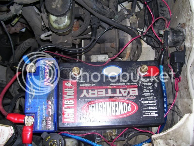

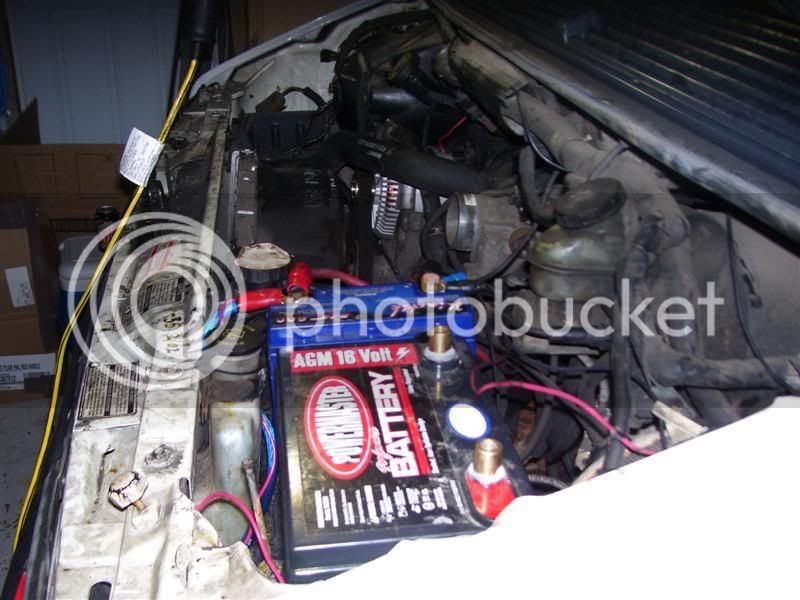

test fit before wiring up... yup thats right 12v kinetik 600 and a 16v powermaster!!!!

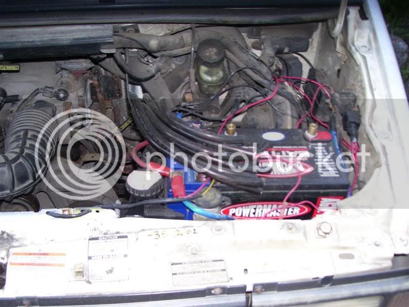

finished product

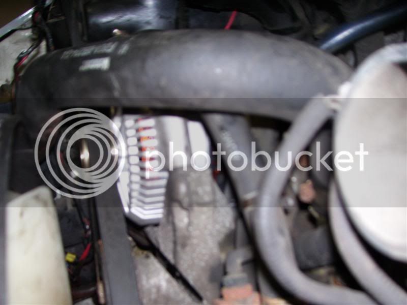

couple pics of the installed alternator and regulator which is there temporary. will be moved in the future.
lol, love that regulator mounting location. If i did that on my jeep, my dumb *** would of already knocked it off the wall //content.invisioncic.com/y282845/emoticons/laugh.gif.48439b2acf2cfca21620f01e7f77d1e4.gif
I liked what you did fitting those two batteries in there.

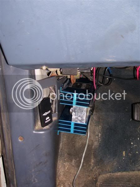

thx dan. yah that reg is there temporary. i just needed to get the alternator in and going. i can actually fit it up on my firewall in the inside but gonna wait to see where im running all that power wire first. that firewall might be gettin alot of holes cut it in haha.
but thx. i figured since ill be running 16v ill just have the stepdown module right there charging my 12v 600 which is enough to run a car. powerfull little bugers they are.

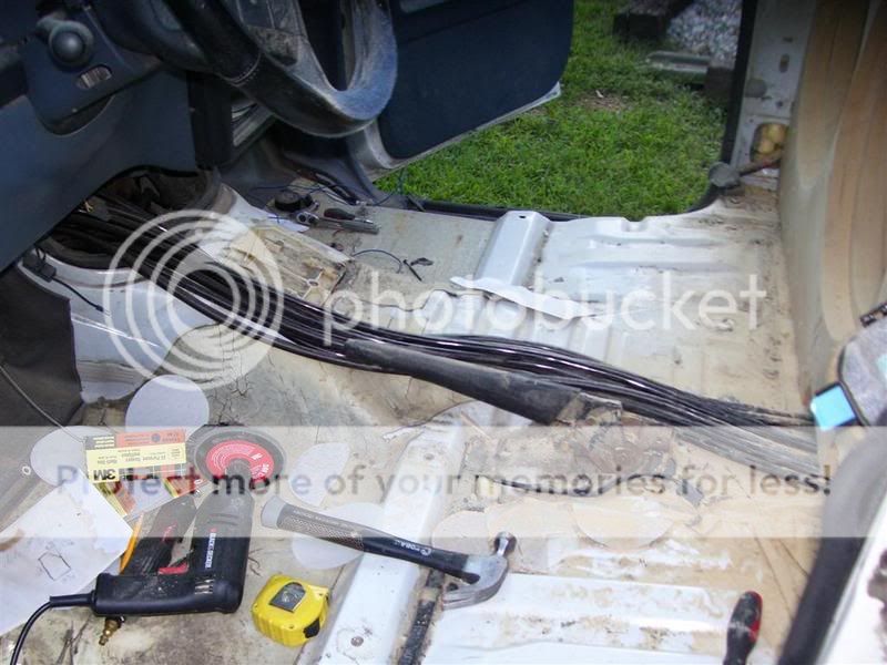

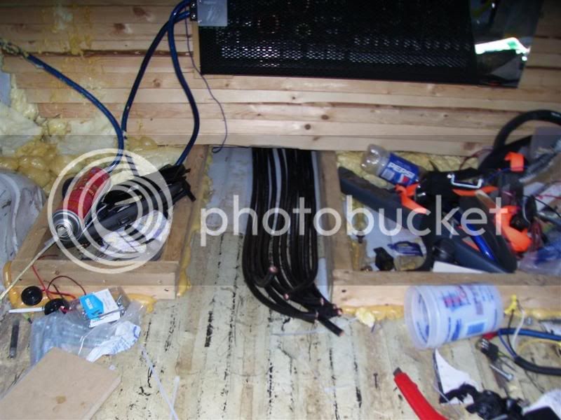

did some more work today. ran my ground wires and got rid of alot of port area to lower tuning and because it is way to much for 3 18's haha. might still be rather large but ill more than likely make it a bit smaller.
