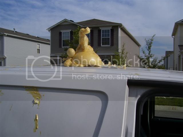

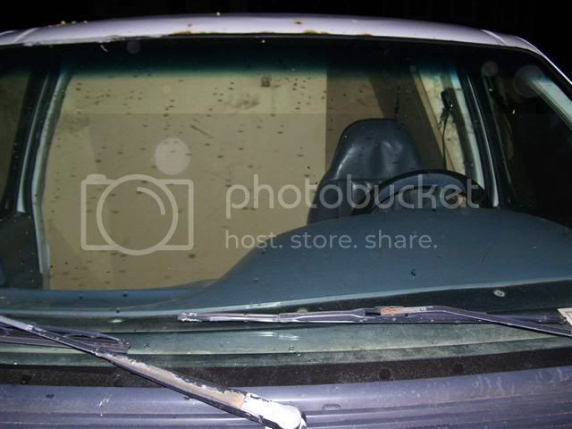

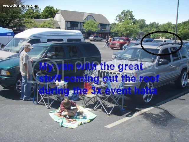

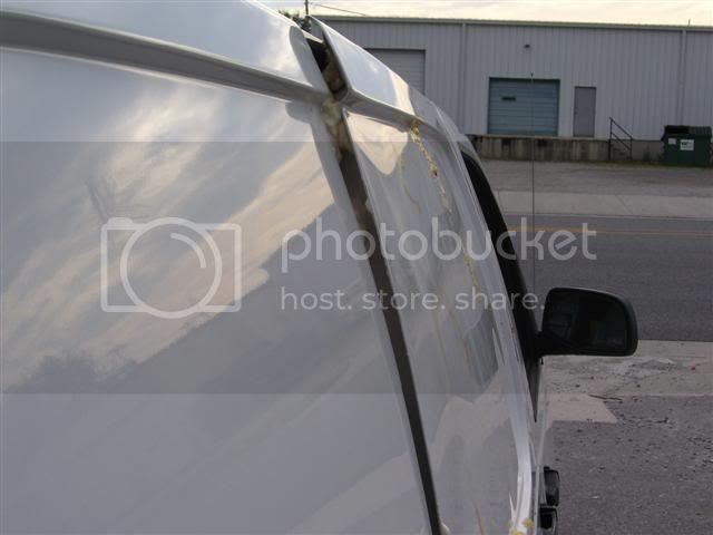

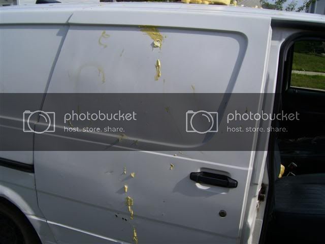

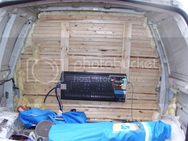

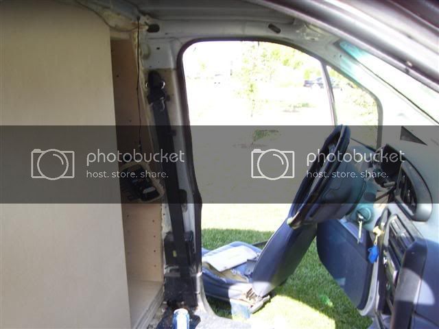

alright another update. on saturday i decided to finish my back wall and build a box for my last ma audio 18 to go compete in bassrace in fort waynes 3x event yesterday. plus i filled all around my box with 23 cans of great stuff. well i put too much in certain places and it came back out the hole i drilled and it forced my sliding door open on the rear side of the door so now im gonna have to use the heat gun to melt some of the foam and push the door back into place.
update on pics.
the ma 18 like it is feels aLOT louder than it meters which is cool. i built a quick box and it turned out well. hits the lows but peaks high. so does a wide range of music. but its in there just to get by. then i dunno what ill do with it.
did a 143.7 playin music but my voltage drops almost under 10v cuz the 802sx is too power hungry for just having a kinetik 600 hahaha. but i still manage some decent scores.

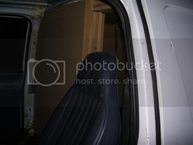

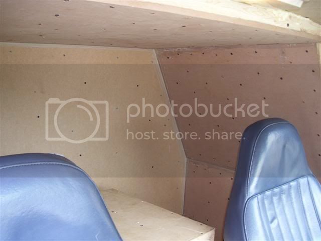

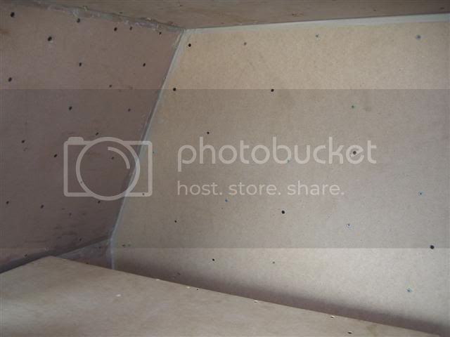

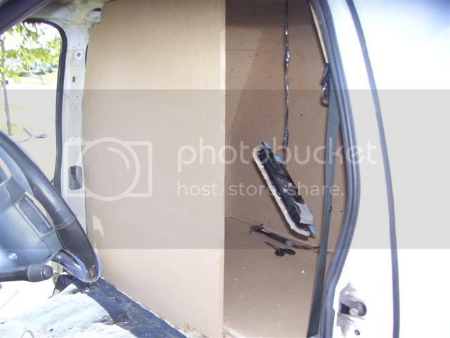

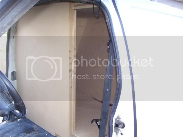

alright so today i actually got alot accomplished by MYSELF! sucked but my shit is crampin. but today i finished putting the next layers of 3/4" mdf on the outsides of my box. and i cut almost all my sheets of wood for the baffel. im not sure if im gonna make it thicker or just add boards on the port side to increase port length. its 7 layers right now. or should i just try like this then add as i test?
ill prolly cut out the sub holes on monday before work.
and no im not nub and did not tack the baffel together before cutting the holes LOL. i juts put them in to see how they fit..
