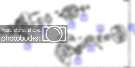

Apparently the "Rectifier Diode/Bridge is a problem on the ALT's and will cause exactly
what you have now.( Just looked up the service bulletins for your year)
That can be changed out by its self but I would replace the whole alt.

Apparently the "Rectifier Diode/Bridge is a problem on the ALT's and will cause exactly what you have now.( Just looked up the service bulletins for your year)

Here is a exploded pic of the alt. #7 is the Rectifier.
