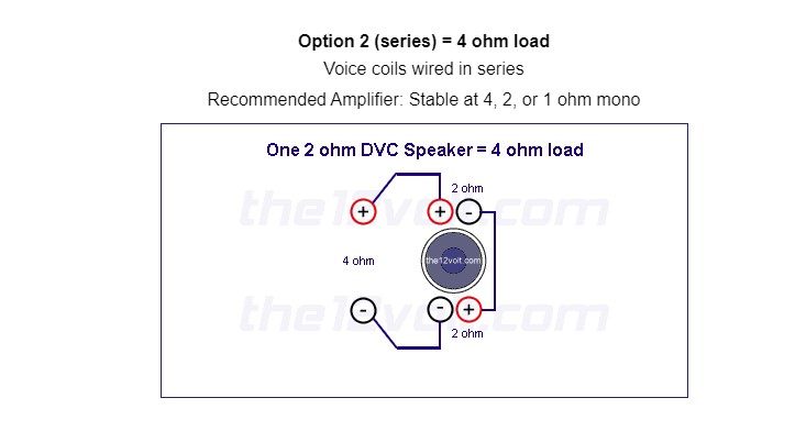

I recently purchased a pair of JBL 631, kicker 46CXA360.4T amp, RCA's, the recommended 8-gauge amplifier power wiring kit from crutchfield, a Kicker CompVR 43CVR122 sub and the speaker wires 16 gauge. Everything went fine until I added the sub wired in series, bridged using 3 & 4 channels as recommended by crutchefield reps. Gains are set at 12 oclock and every since the amp has been going into protective mode. I checked the voltage on the amp before going to protective mode and it reads less than 11v. I disconnected the sub and everything went back to normal. I set the gains at 9oclock with the sub connected and it out out from protective mode. But it doesn't sound as loud as before. I've spent over $600 just to listen to music with the gains set at 9oclock? I drive a 370z. Battery is brand new and the alternator can handle a lot (150). I'm using a 16 gauge wire for the sub btw.

Surprisingly, the amp decided to get out from protected mode. All the wires were off except the power, remote and ground of course. Then I connected them one by one to see if the amp would go into protected mode and it didn't. The 2 speakers are working perfect. I don't know why the amp took hours to get out from that. The gains are set to 8o'clock. I checked the ohms and both left and right speakers read close to 4 ohms. Also, the kicker sub reads 4 ohms since it is wired in series.

So I was re-setting the gain controls by using a meter and set it to AC volts to the speakers output of the amp while playing the 1khz test tone. I calculated to find the voltage that i need to set the gains to and I got v=12.64. Voltage = square root of watts x ohms. My amp watts RMS is 440 and according to kicker's power chart (400W 4Ω 40.00V) so 40x4=160 and square root 12.64. So far so good but I haven't tried adding the sub yet. My amp has two gain controls. I believe the other one is for the sub for channels 3 and 4. How do you find the voltage for my kicker 2ohms compvr sub?
power handling: 150-400 watts RMS (200 watts per coil) Hopefully this is what is causing the issue.

I'm not sure you can run more than 2 channels on your amp to that sub being a dual 2 ohm. It's too low of load for you amp to run all 4 channels on that sub. If you had a d4 ohm sub, you could do that.
