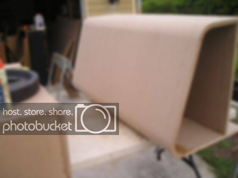

You should have been here when I double kerfed this entire 4x8 sheet
No trial and error, no real calculation per say. It was pretty much an educated guess. It was a pain to make all the cuts across the entire sheet and bending it kinda ****** by myself because of the weight of it, but a little patience and and then some cursing and I got it the first try. This was an 18" truck box for an ext cab ranger.
