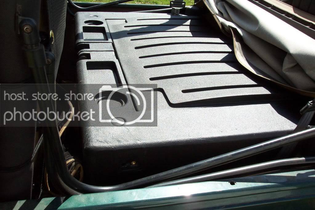

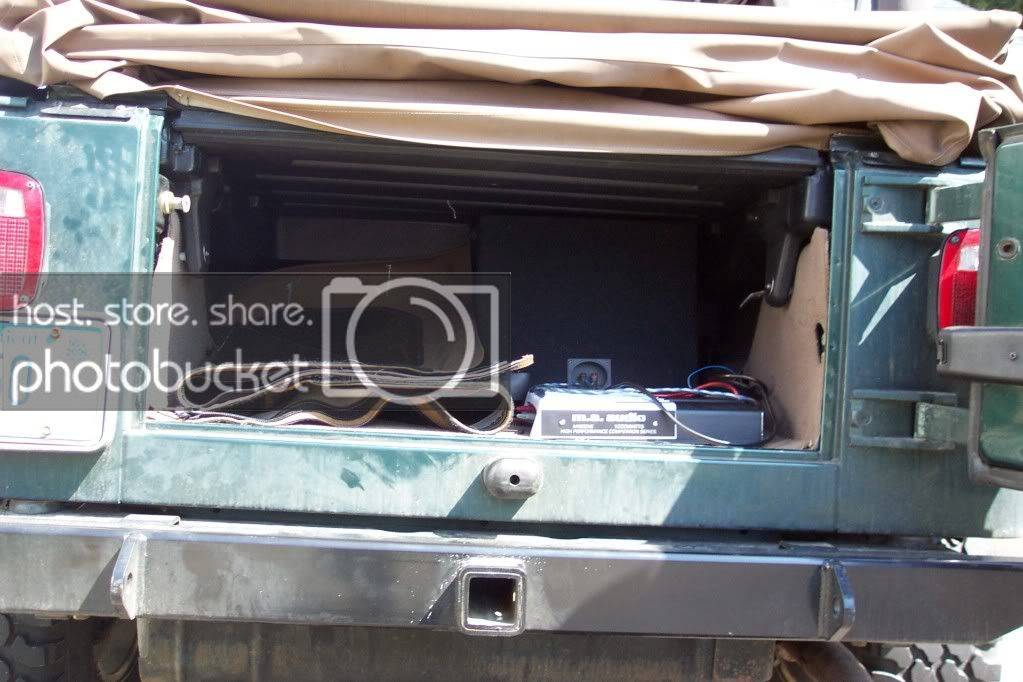

i have very little space to put the sub in. i have a '99 wrangler with the rear seats removed and a bestop extendatrunk installed, it turns the back into a trunk. the inside is 15"tall 34"wide and 23deep. i talked to nick who is one of the owners of IA and he said it should be in a 2.5 box tuned to 33hz. here are a few pics of the trunk system with my old sub and amp(.95ft3 box 10"sub)much much smaller than what i have now(1.5ft3)
