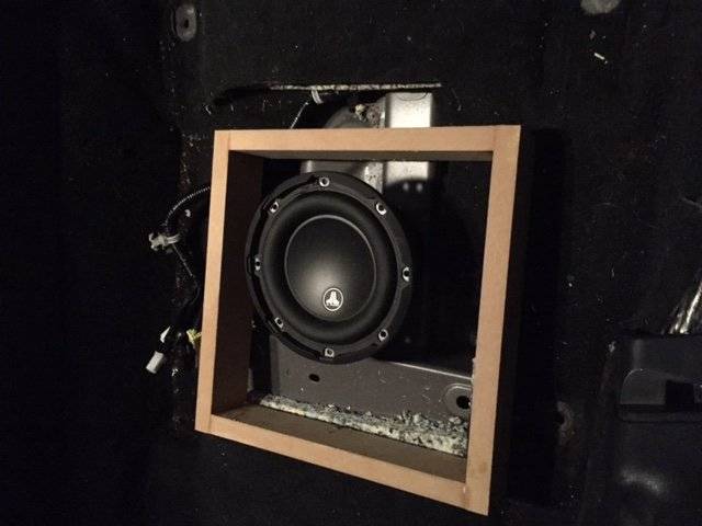

2010 Nissan Rogue, dual JL Audio 6w3v3 4ohm.

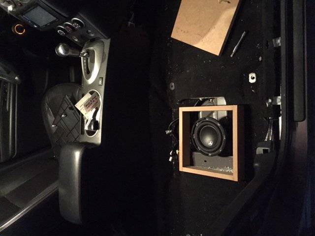

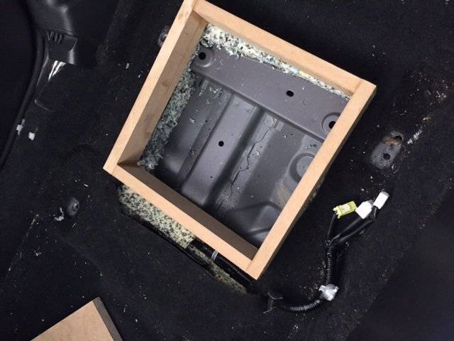

These are kind of an omen of things to come with this install…I was able to squeeze these under the seats…

Pretty neat install on those lil itty bitty subs there NSTALN.....not very often you see midbasses under the seats.
Have you tested them out yet?

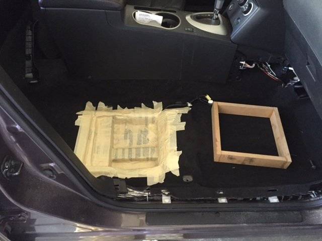

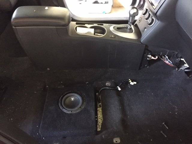

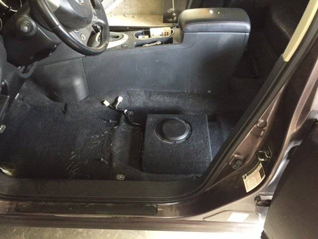

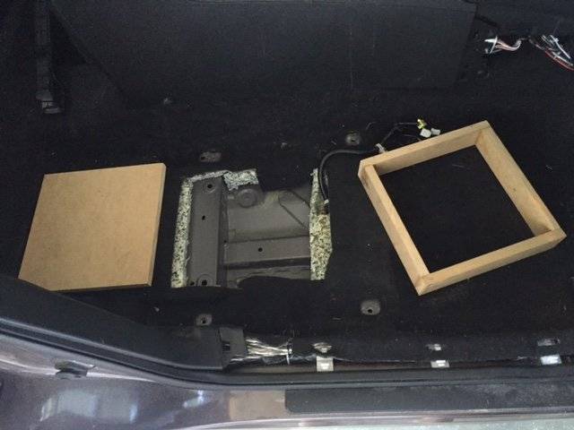

Thanks…they were a bisch to get in…the drivers side hit a small snag as I didn't account for the electric seat motor it has that the passenger side does not
As a result the DS box isn't in the car at the moment…but with just the single 6w3 playing its really a different experience.

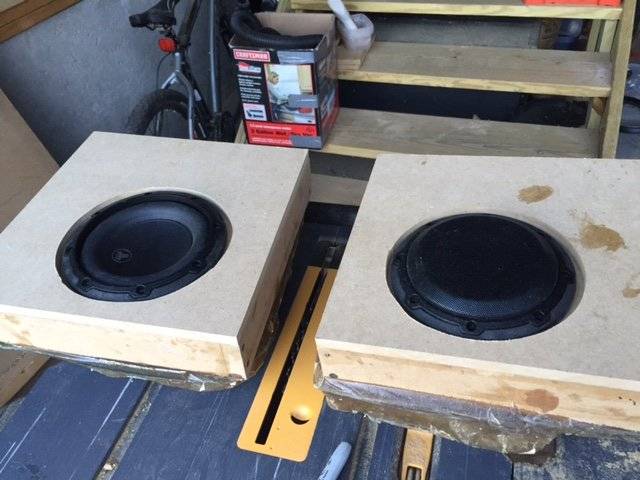

They are subwoofers but they're quite small and the boxes are quite small (.2 cubes)…as you can imagine the low-end roll-off is naturally quite high (somewhere in the 40's maybe 50's) so they're not ground-pounders…but they really fill out the lower portion of the mid bass…and give it some 'oomph' that door mounted drivers can't always deliver as well as really bringing the bass much more up-front…kick-drum impacts are instant and tactile…and are really omni-directional.
I know that proper TA of the sub and standard midbass can make bass appear up-front…but this just feels/sounds different…and so far even with limited testing I'm really pleased with the extra presence it provides.

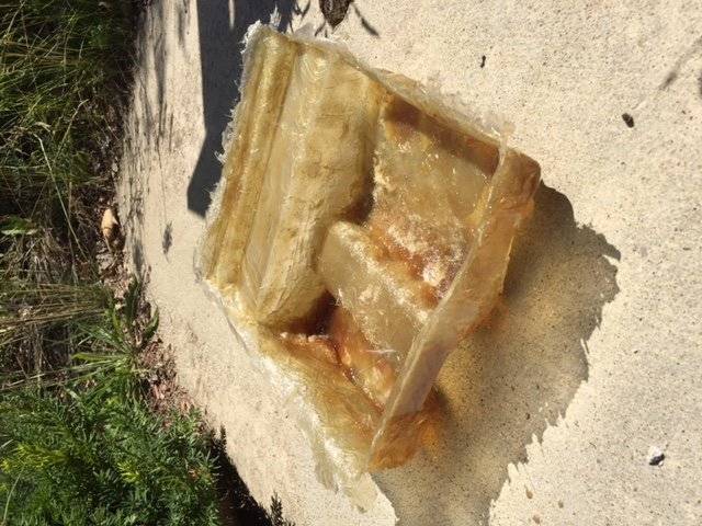

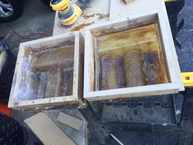

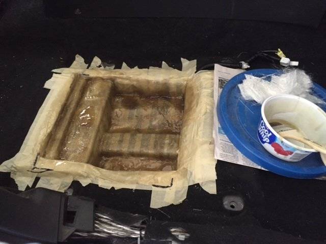

Thats cool as hell and an awesome idea. How thick do you have too make the fiberglass ? Sure beats trying to make them work in doors I bet. Keep us posted when you get them both in. Nice work!

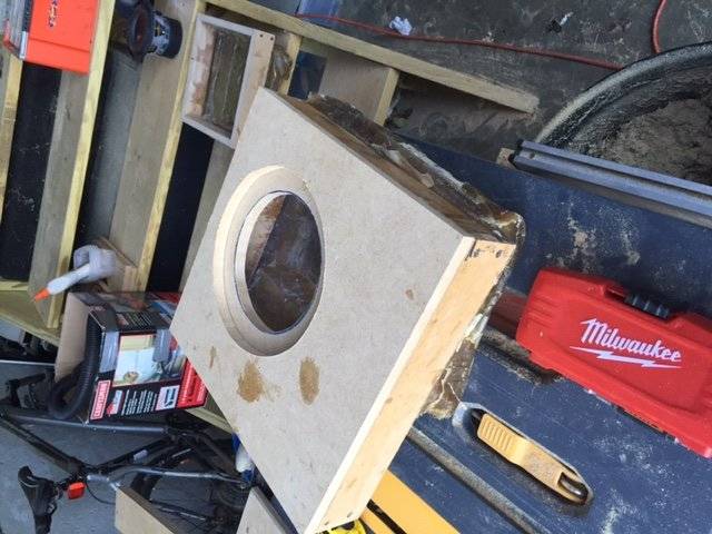

Thanks…not sure how many layers…4-5ish…the glassed area is about 1/4 thick.

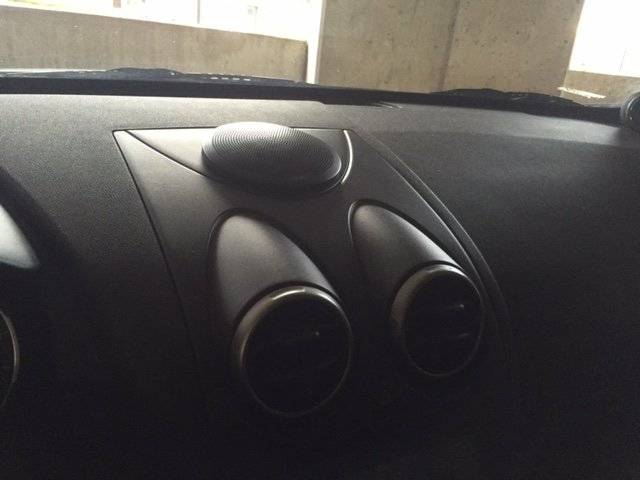

I currently have AudioFrog GB25's in custom pods in my sail panels, I also have AF GB10 tweets in custom spherical pods on me A-pillars (each set of drivers is run through AF GB2510c passive crossovers).

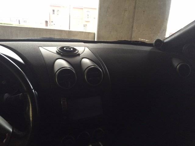

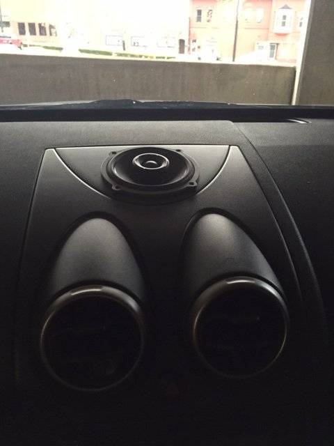

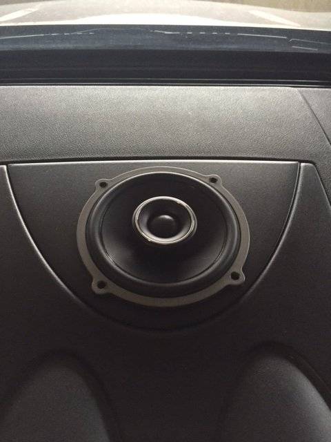

My Rogue Bose stereo has a factory provision for a 3.5 inch center speaker...with a lil modification I was able to fit an AF GS42. I have a set of AF GS62's for rear fill (I have yet to install those in the rear doors). I will be moving the GB25's into the upper door area (see pics here: http://www.caraudio.com/forums/car-audio-build-logs-cars-trucks-suvs/626818-audiofrog-audiomobile-jl-audio-knu-concepts-false-floor-sub-enclosure.html ) and moving the GB10tweets and pods to the sail panel. I will be replacing the GS693's with GS60's(at some point). I will be replacing the 12 inch Audiomobile with a 15 inch TC1000. I'll be adding a second JL 900/5hd for power and I'll need to add a couple small batteries to support it all.
On the processing side of things I will have 8 channels to work with and Alpine divides the surround as follows:RT FT high, RT FT low, LT FT high, LT FT low, center, RT rear, LT rear, sub. So I'm gonna have to get a little creative...
The FT RT and LT high will drive the GB25's/10's, the center will cover the GS42, the FT RT and LT low will drive the GS693's, the rears will drive the GS62 pair and the sub signal will be split to both of the 900/5s' sub channels. One of the sub channels will power the TC1000 15, the other sub channel will power the 6w3's under the seats.
So (2) amps, (8) channels, (12) speakers.
Pics of the recently modified center:
