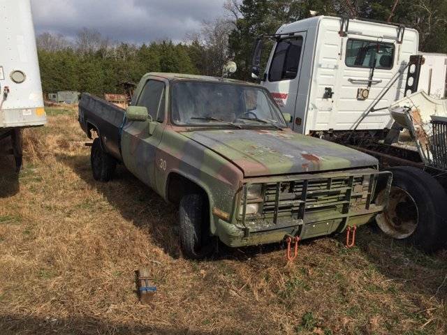

Hey guys, this first post will serve as an outline for the build as a whole, subject to change as needed. Bear with me as this will be a slow and painful (for me) build. The vehicle is in far from great condition and was originally purchased for parts for other CUCVs but was never ripped apart.
First I will be getting it back to running well, then do several mods so it is highway driveable. With the stock tires and drivetrain, top speed is 55mph.. It has a 3 speed TH400 transmission, 4.56 gears and a 6.2 diesel delivering a whopping 135 horsepower and 240 ft-lbs of torque (for now).

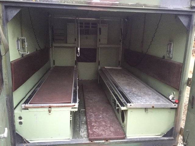

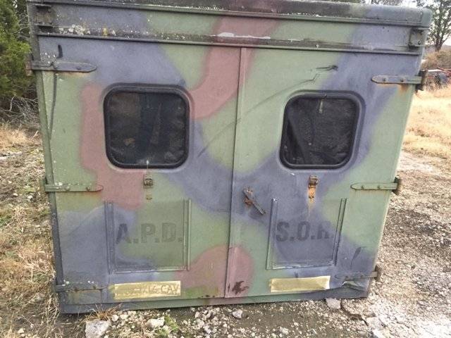

Anyway, on to the pictures.... this is where it gets ugly. I may need to find a better condition ambulance shell, but I just happen to know someone who is very good at body work and may be able to fix it right up. The ambulance shell is currently not on the truck, and will be stripped completely so that it is a huge rectangular box.
Yes, it's rough. Yes, it will probably cost a lot and take a lot of time to get right. But it should be worth it in the end. I've got very little invested in the truck itself, so all the cost will come from the build.

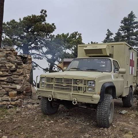

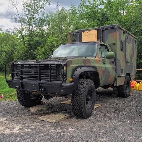

Here are some pictures of what it will start to look like once it's fixed up a little and has the 37s on.
