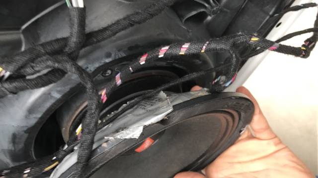

took off the door panels to see what i can fit factory 6.5 wasn't going to work for me so i bought 8in hertz spl shows all around
checking for clearance
