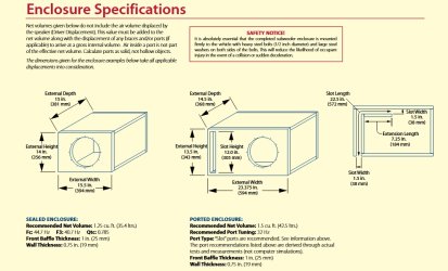

w7s tend to sound boomy and muddy ported. It's a high Q, low FS sub, so it's going to sound boomy in the recommended ported enclosure. Given typical cabin gain, the enclosure alone puts you +6-9db at ~40hz. If added any bass boost, then that only makes the problem worse, so make sure bass boost is off. If you've ever heard 12w7 in the JL HO ported enclosure - that thing sounds boomy and muddy as hell.
If you have an EQ, try tuning 40hz down ~6db.
You can try something more like 2cuft ported and tuned to ~25hz to take some of the boom out of it or maybe ~1 cuft sealed, but either of those enclosures will cost you output, considerable output in the case of the sealed enclosure. The ported enclosure will be tricky and big due to the low tuning frequency, so you might have to consider a passive radiator design. Go sealed and you'll be wondering why your w7 is barely louder than the cheap JL on 1/4 power, but the sub will sound much much better.

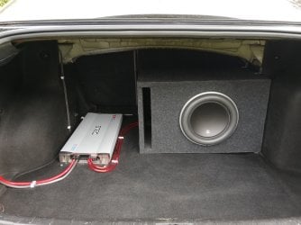

What am i missing
Post up pictures of the box as it sits in the vehicle right now. What are you using for a head unit? Have you confirmed you have no EQ, bass boost, or other issues coming from the source?
W7 is a plenty capable woofer and I would suggest that box design/location would be what is going wrong. I do not believe your amp is the problem.

The head unit is PIONEER DEH P4950MP, an old unit but never had an issue with it. The vehicle is very similar to Audi a4 sedan. Tried setting amplifier gain with a multimeter, I set at 47v, but now on full volume, practically nothing happens. Checked the resistance of the speaker, it showed almost 3ohm, so 3*750 is 2250 and the square root is 47.4v That's the right gain? I set that by playing 60hz test tone. I tried equalizer with flat, natural, powerful, and all the possible settings, it just got more or less boomy. Sub moves great by hand. Posting some pictures.
So the sub is barely moving, or it is moving fine but it sounds weak up at your listening position? If the sub is moving I'm going to go back to my theory that it's the position of this box in the trunk. I bet if you put that in a small hatchback or SUV or even on your home theater it would sound pretty nice.
Experiment with position and aiming of that box but have reasonable expectations trying to get good low frequency out of a trunk.

47v is right. Do the gain setting with the bass in the radio eq all the way up, but no bass boost. Set the amp's Slope to 24dB, Frequency to 80Hz, Bass Knob @75%, Subsonic to ~27Hz.
I assume box is s built specifically for the 10w7; otherwise you will not make it sound right regardless of any settings you try.
Also like hispls said, it is not easy to get clear bass out of the trunk.

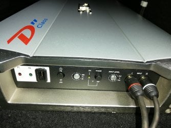

Turns out i was reading the multimeter wrong, i bought a new one with auto range detection and didn't notice that it stayed in mV instead of V, tried again with an adjusted range, didn't go over 3V.
So i have gain at zero, hz at the lowest position, head unit completely flat, raise volume to 75% ant play 60hz tune, slowly start raising gain and completely turned shows around 3V. To the amp comes 12.4 DCV through speakers ports comes out 3ACV
You have the crossover turned all the way down? It looks like it has a LPF at 40 HZ when turned all the way down. A 60 HZ test tone will be filtered out. Turn the filter up a little maybe. Is that push button on the left labeled “HP” and “PB” a switch between a high pass filter and a low pas filter?
