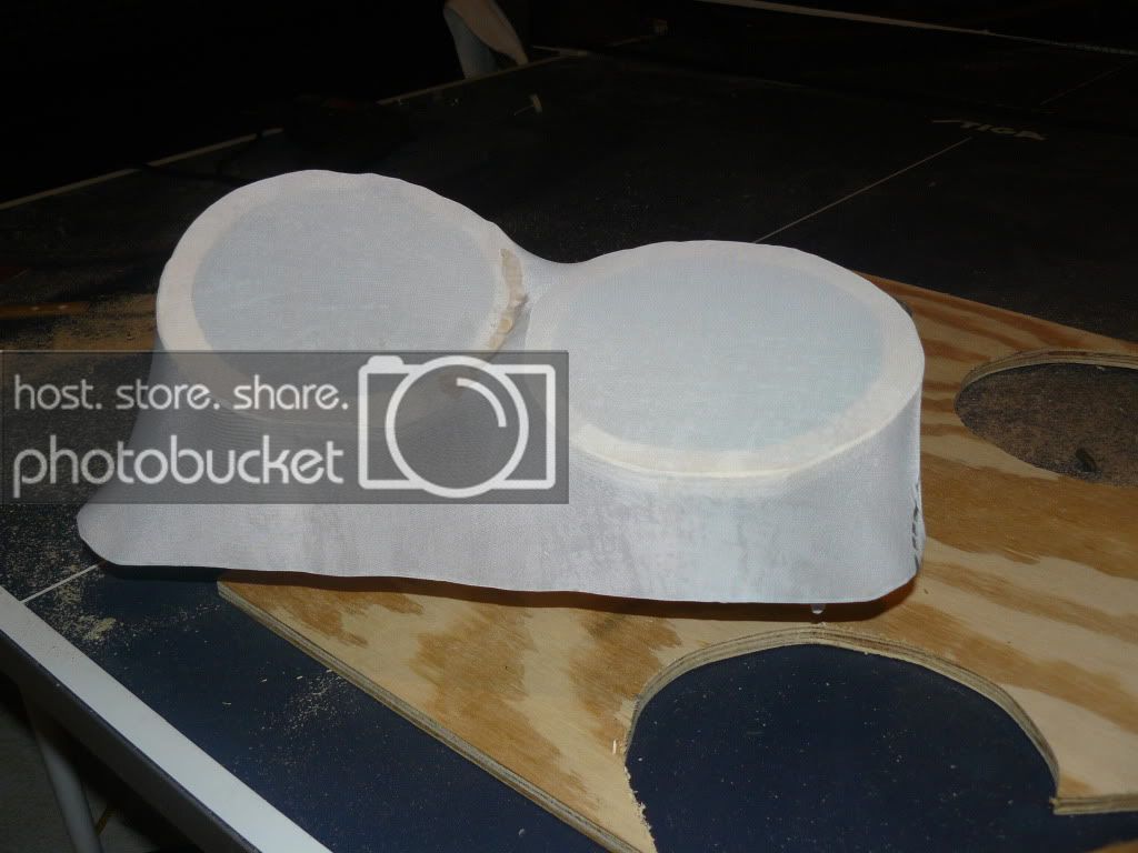

3min is plenty of time to wrap them right, maybe if you took your time you would not be doing a x2 on this install.. you still did not take Nicks advice in the router..
this may turn out avrage....good luck..
maybe you should read more on http://www.fiberglassforums.com
Were you drunk wrapping those?? You also had problems with leaks last time... yet didnt mix a correct resin batch?? SLOW down man
hhahaa i was a lil tipsy last night wrapping the other one at like 3:30am
but it got only one slight wrinkle and i streched it as far as it would stretch, looks much better than the other one ironically

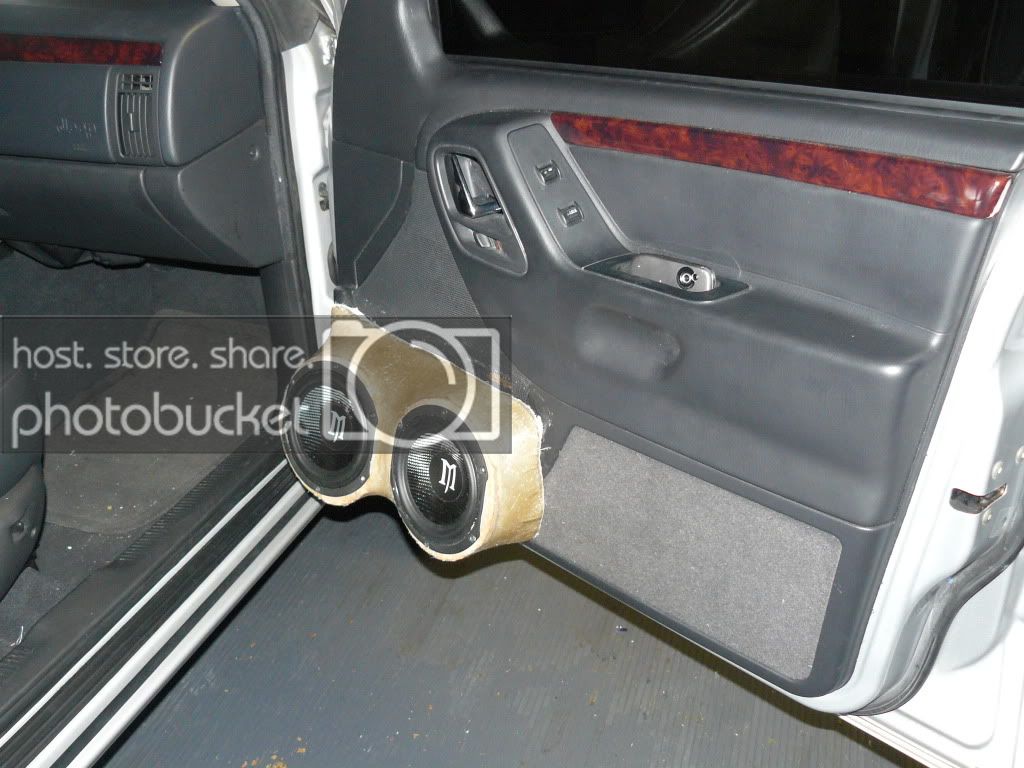

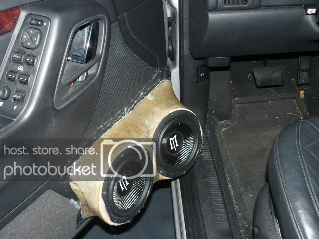

wrapped the other side last night, then resined it. this morning glassed it with 3 layers with a hot batch, let it dry in the sun, trimmed it all nice, took the door panels, mounted both pods with deck screws and thick weatherstrip for no vibration transfer, mounted the mids, wired for sound, and omg midbasspolooza and not a single noise other than the music.
will sand fill and finish sometime next week with the help of someone with great experience with glass, tomorrows a show so i wanted my midbass now
