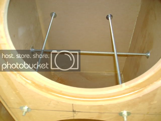

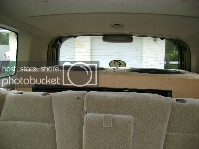

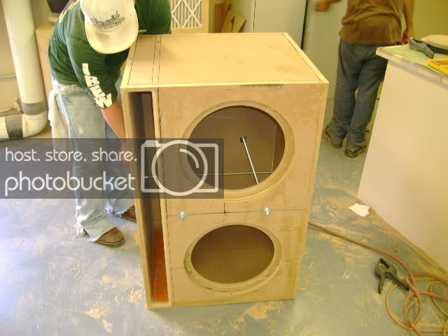

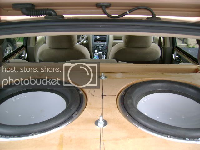

got a couple of new subs to try out. dont know how it all sounds yet bc my zx2500 took a shit on me but i should have the amp back next week. the subs are 15" Vibe Audio Space 15s. box is 12.35ft3 gross 10 net. tuned to 33hz with a double baffle subs flush mounted. 3 threaded rods for more support. onto the pics.
are you gonna wrap it or pant it or just leave it how it is?
who knows, ive got the sides rabbited in case i decide to wrap it, or i might do truck liner, or i could keep the "industrial look of the box which is usually the style i perfer. what ever i end up doin i will post finished pix. hopefully i will have my amp back from kicker next week. its been 5 long weeks without bass. i will also be posting vids bc i have a feeling this is goin to be sick.
