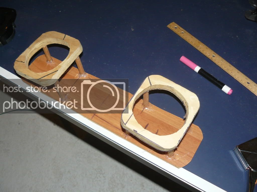

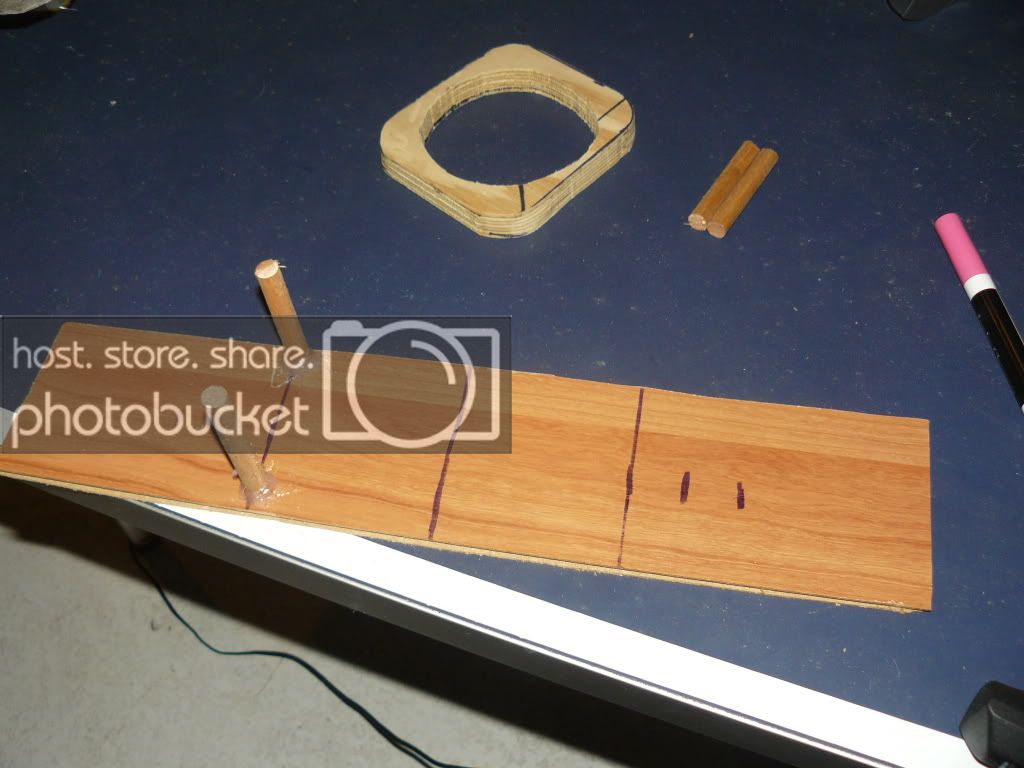

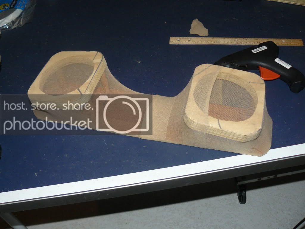

but today,,,, woke up at 1030, started making the mounting rings for the tweeters and mids, then my nig said how the **** are two of these seleniums and 2 of the mids gonna fit in each door with these bases??
i said shit
then i had a magic idea!
make a tweeter pod for 2 of the st200's for rear fill to attack whoever sits in the back!!!

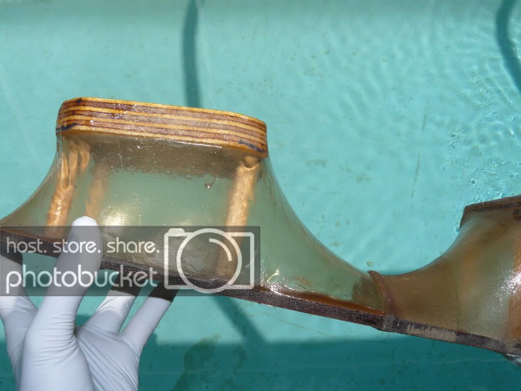

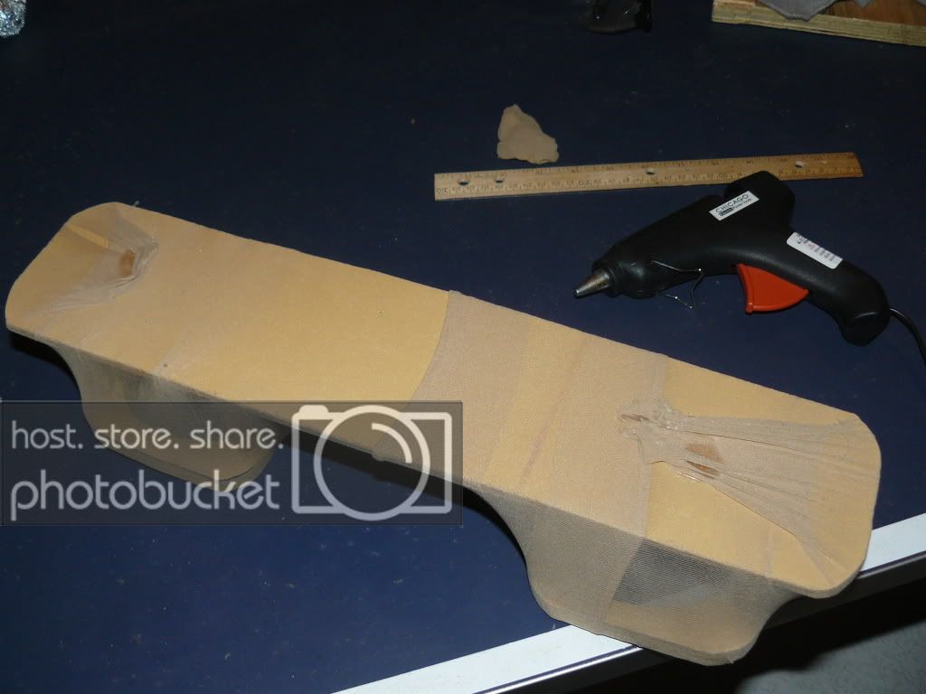

so we built the fastest set of tweeter pods ever.

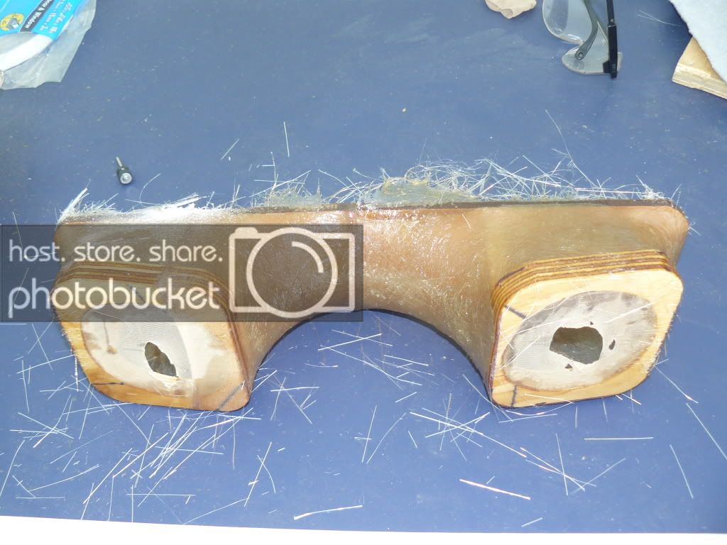

4 hours including drying times. mixed up very very hot batches of resin and git errr did!
used two pannyhoses for the mold. no rips, tears or anything. came out great
after resin!
looks like glasss
that dryed up in less than 1 and a half hours. an uber hot batch of resin
then matted up, 2 layers even though it does need it
excess trimmed

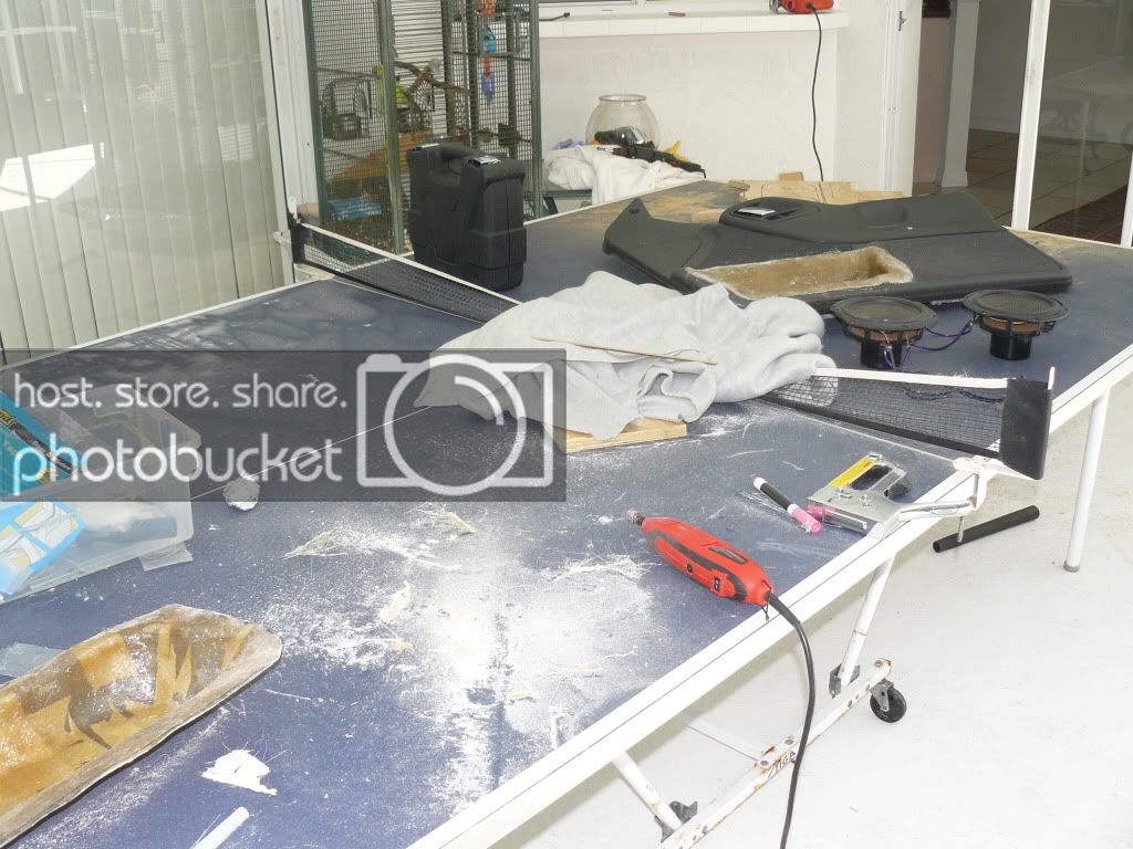

the ping beer pong table getting violated agian

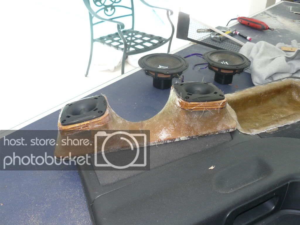

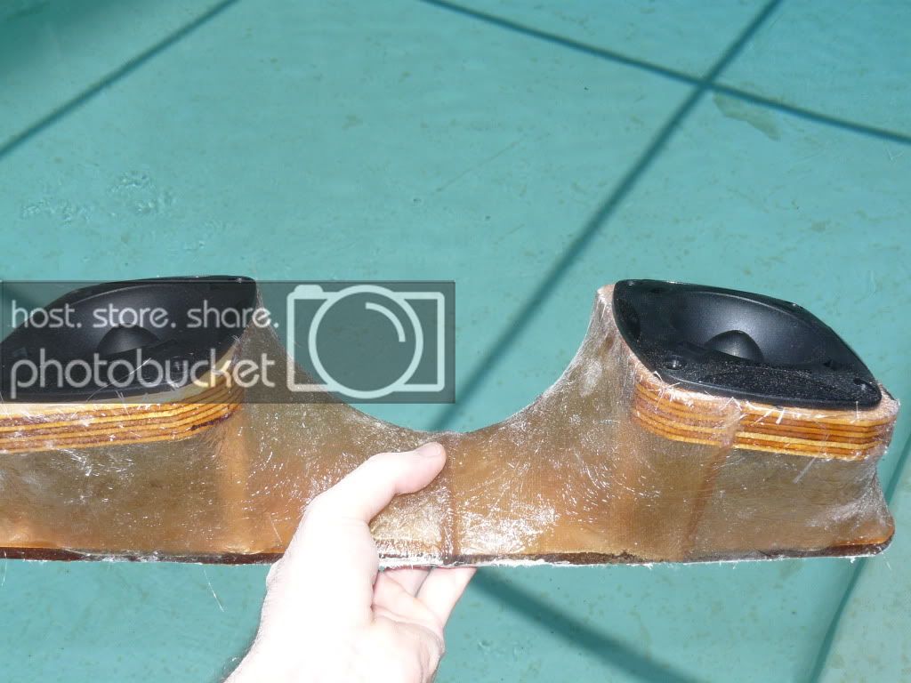

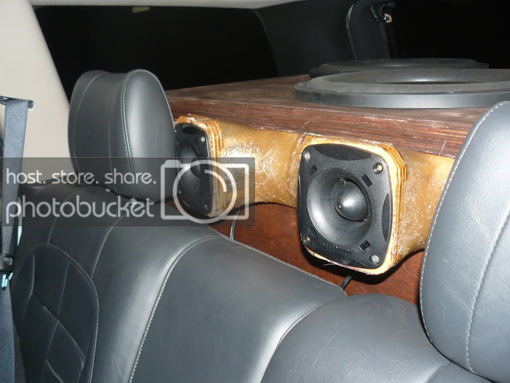

touched up the tweeter pods a lil, then mounted on the box with deck screws and strips of thick gasket for no rattles and greatness

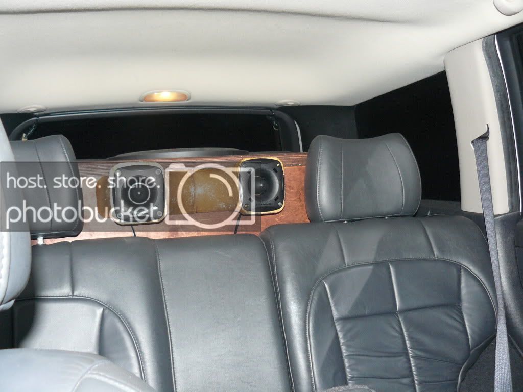

our first tests 30 minutes ago conclude that it sounds SICK sitting the front seats,, love it
rear seats,,,
you better like highs in your face hahah
will have them sanded filled and painted or vinyled when the door pods get finished, which will b a while, all that is done are the bases
You could have easily fit those in your door pods
could of, but it would be impractical given the size of the bases,
so instead of two st200s and two mids per door, 1 tweeter and two mids would be less instrusive, and allow more airspace for the mids.
and i love this rear tweeter setup alot already lol
surround sound highs ftw
might sound a lil dirty though when the front tweets get in //content.invisioncic.com/y282845/emoticons/crap.gif.7f4dd41e3e9b23fbd170a1ee6f65cecc.gif
phase issues lolzz

UPDATE: one tweeter has blown in the pods due to stupid friends turning it up too much on the deck and clipping the shit out of them. that makes 4 tweeters blown in my car in the past month. all from turning the deck up to max.
my deck doesn't allow you to limit how far you can turn it up FTL
