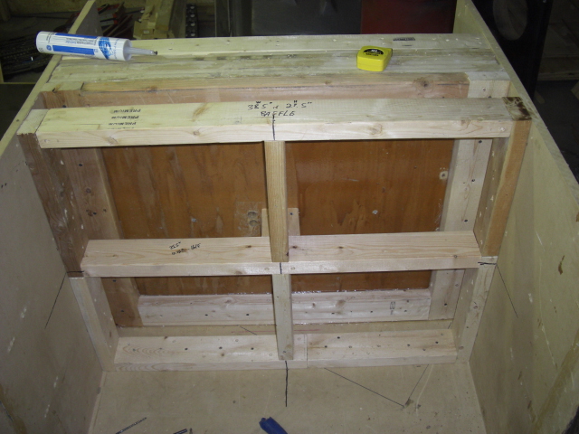

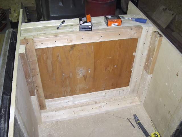

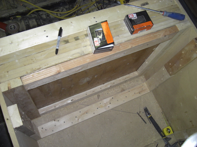

Framed the back wall into place on the front (also framed into place on the back as pictured before) -- starting to frame in to place the woofer baffle in :
Back chamber is 5 ft^3 before the displacement of the 2x4" lumber + any other bracing I decide to add. Figure I'll end up with around 1 cube per driver as I plan to reverse mount the subs (no sub displacement).

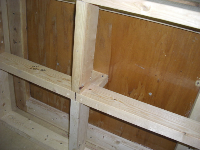

Cross brace finished for the baffle... just need to build the baffle itself now :
Looks pretty strong to me //content.invisioncic.com/y282845/emoticons/smile.gif.1ebc41e1811405b213edfc4622c41e27.gif
