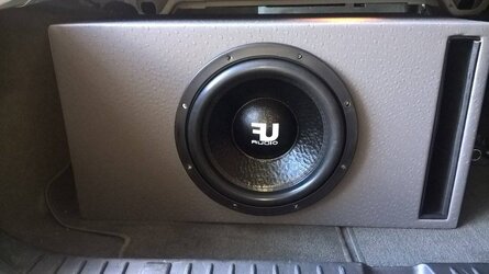

um dude i have a custom box u just coming in on this conversation that has nothing to do with and u missed something.. this is my box and i've been in car audio for over 20yrs
because you have no clue why they have the port that small. this box will probably still be louder than whatever you design gramps.
if theres a REASON for the port to be small on the 15" box why is the 12" port bigger.. u the one arguing for no reason.. any time else someone showed that box 1st thing everyone would say is port is too small but now u think port 1/2 of what most should be is ok with u?

even hertz is using 1 now.. not everyone wants to spend $200 on a box nor has the tools to make one.. seen many people on here that have big systems don't make boxes yet i'm the only ones gets **** on for not making a box..
