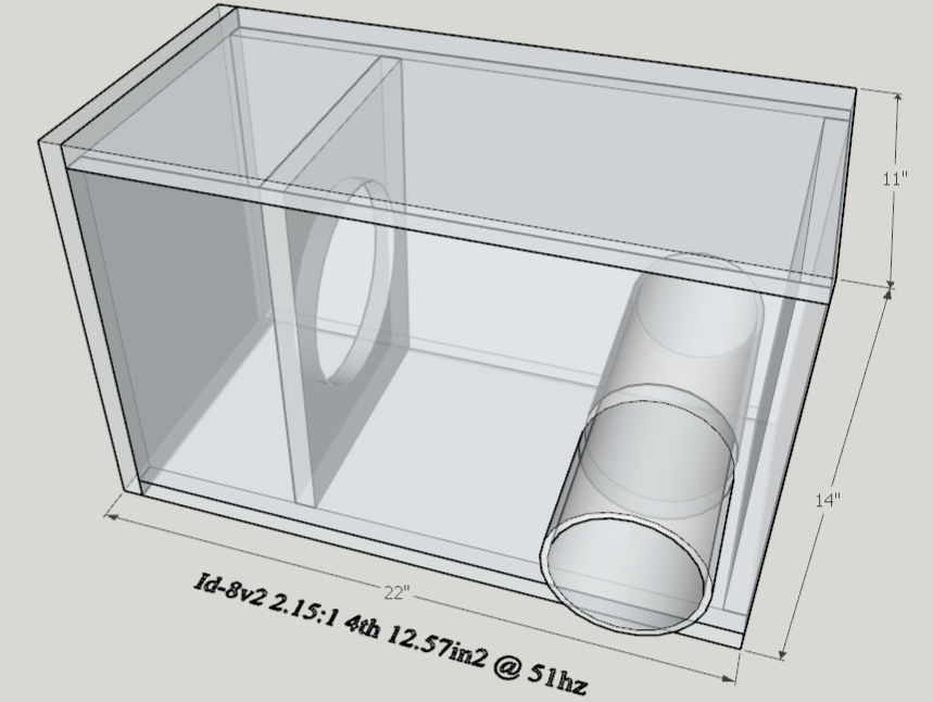

This was for a single type r 12, but I had someone model it in a 4th order. It did very well in i cube sealed and 1.5 ported at 50hz. I just looked at your space so not sure it would work for a pair.
