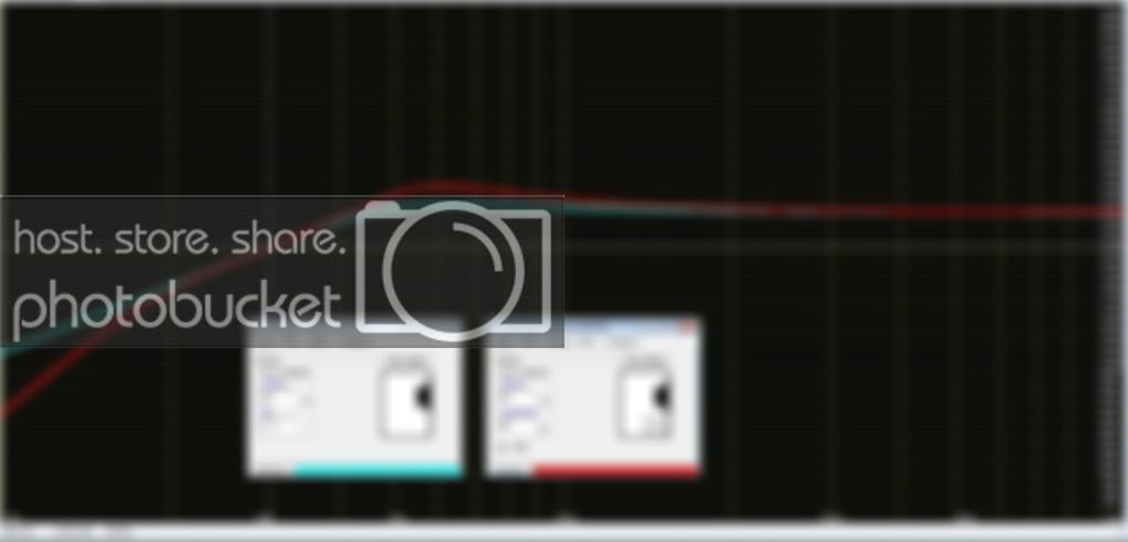

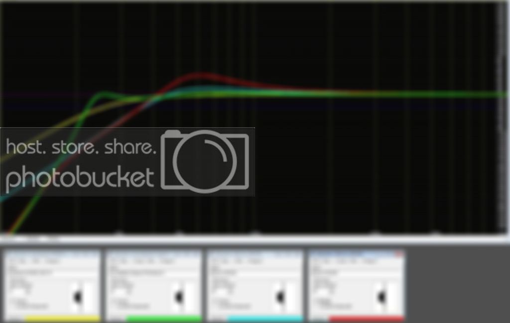

lol, well, an insanely low tuned ported would have the lowest flat extension, but with your volume fitting requirements and the EBP of those subs I'd personally run them sealed. The EBP is a lil low to get proper response from them vented and the Qts will request a large net volume for the subs to have a nice +/-dB deviation. After running the TSP's no matter what you put them in it's gonna sound horrible, lol. Heres a graph for ya showing their resonses, the S4 version is alot more usable, the High Qts ruins the potential of the subs for anything other than IB.
