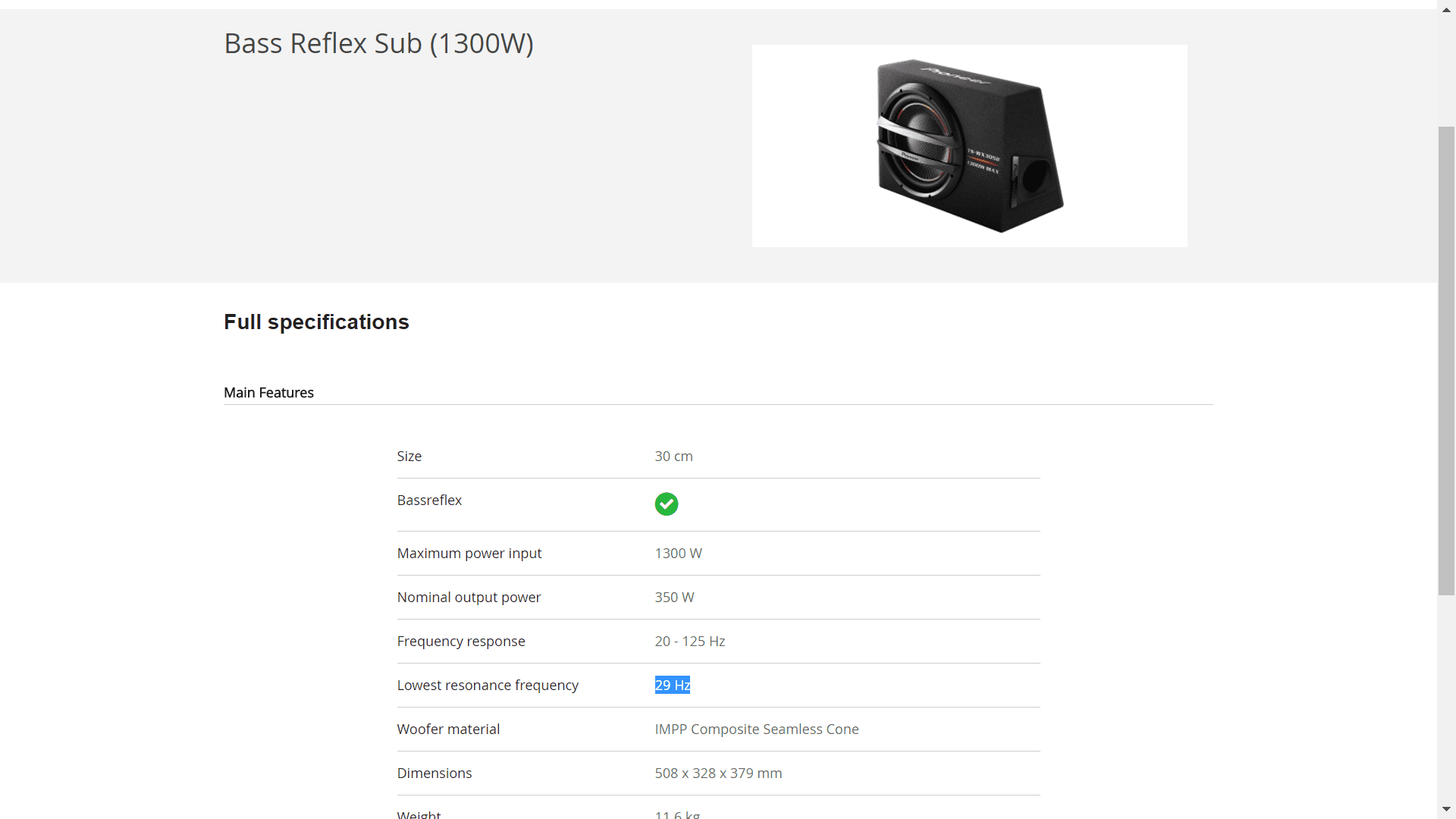

5. PIONEER TS-WX305B -subwoofer under driver seat

protect the sub on low frequencies especially when it cant play any lower than 29hz as manufacturer stated
Really??? Where did u find this??
