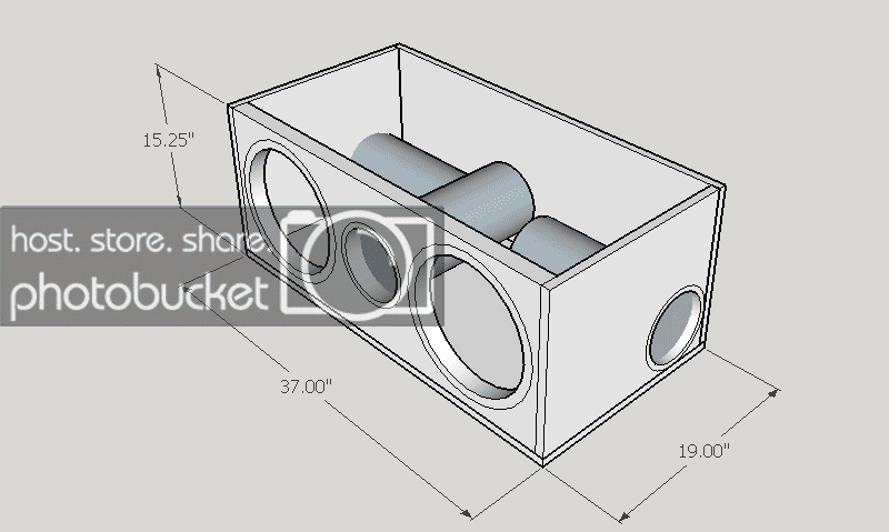

I have a very weird situation while trying to make a box for my upcoming build. I'm trying to keep this box over 4ft^3 net, and keep the tuning around 34htz with plenty of port area. I tried a single side firing 8" port, however, that wouldn't work due to the mounting depth of the subs. The only solution that I've found and been recommended is three 4" aeros. . While I'd like to place all three on the front, firing in the same direction as the subs, I don't think I could make them so that their diameters were perfect enough to not overlap. Instead, I feel that buying aeros that have predetermined dimensions will be easier to work with.
Here's what I came up with:
I realized this after I screenshotted it, but the side ports will most likely be moved up and away from the corners of the box to prevent them from breaking.
What do you guys think?

@CSCStang will be your friend when it comes to designing a sub enclosure. But we need more info such as what subs are they? What's the vehicle they're going into? Any specific goals for these drivers or just a daily ground pounder? What size subs they are?
That pic looks and appears to be too much port area but can't determine that w/o more info.

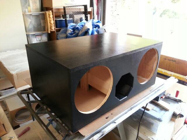

I just sent him a pm recommending an octoport. Don't have to run multiples this way. One and done lol.

Octoport is almost as efficient as a round port so you getting enough port area without sacrificing as much space as a sloted port would require. Its great for when you need specific amounts of port area and cannot find a proper sized aero/sonotube to get the job done.
