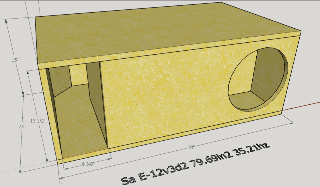

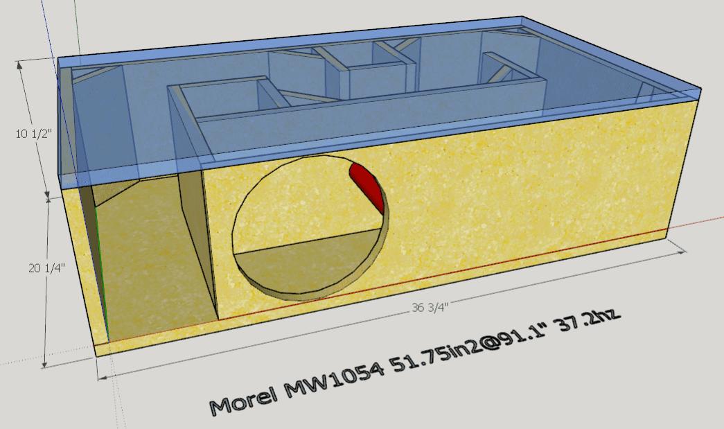

This is just quick and dirty... I'd cut the mounting hole last as I got the baffle kinda close... but do you think this is big for a single 10" driver?
See what I mean?
Never looked into doing t-lines just know there's more involved in design and they're bigger. I'm thinking he probably has an suv. But yeah that's got some width and depth to it lol.
Lowering the tune will make it even bigger... lol... I wonder how a 37hz tune with that driver will do extension wise?
 Do they usually work better tuned a little higher then you'd normally tune for sq ported? if I had somewhere to put a t-line wouldn't mind trying one 1 day just for fun.
I wonder why parts express suggested tune is so high vented
But yeah couldn't imagine how big it would be if tuned below 30

I sorta gave up... It just lost too much for me... that's why I looked at the qts and qms and decided to try a T-line. Everyone says with even a 40hz tune a tline will extend almost a full octave lower... cleanly
I still gotta get off my rear and build what I got planned just to see, but it's Az and hot atm... this winter I'll be doin' it for sure
Wonder if he has room for something like that
These morels I'm using are kinda the same way. I already had them sealed. No fun in building sealed to me anyway. I seen how they'd do ported. Tryed them anyway. Primarily listen to rock/metal when I'm working so not missing anything. Pretty good on low mid.They still don't do too bad on rap music just don't kill it on the low low stuff. Got couple of 15s to play with  at home when i get around to building something. For some reason I listen to more rap 90s pop at home. Probably has something to do with the ol lady.
Doing a t-line huh. That'll be interesting. What sub you have in mind.
I get around to replacing the 8s in my honda ya think type r 8s would work in a t-line?  I got an old f150 extended cab I don't need the rear seats for anything.
